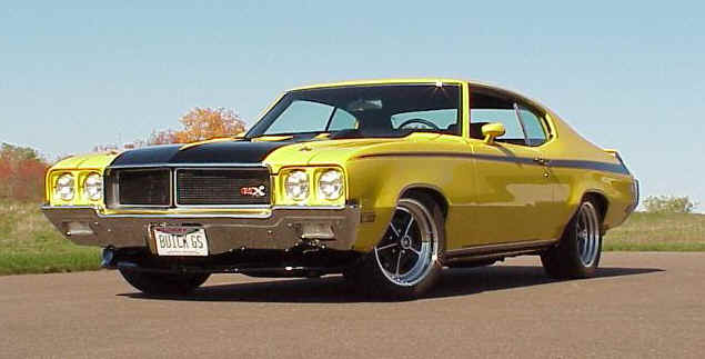

      Ramey, What about a PT Buick wagon? Would the QA-1 coil over kits work on the body wagon?
      How about this for a Pro-touring Buick
      Tim
      1971 Buick Sportwagon pro-touring project. Buick 455 TH350, SPC front suspension, UMI rear suspension, KYB shocks, Slowly getting there.

      Hey Tim. That pic is sweet. That car has a pretty awesome stance.
      And yes, the QA1 kit would work on a wagon. The cool thing about the coilover kit is it's super-easy to dial in spring rate and ride height.

      The pict is of Todd Miller's Pro-Touring GSX. It is a sweet car. I have been doing alot of thinking of what I want to do with the suspension on the wagon. but now I have. I figure using UMI performance parts.
