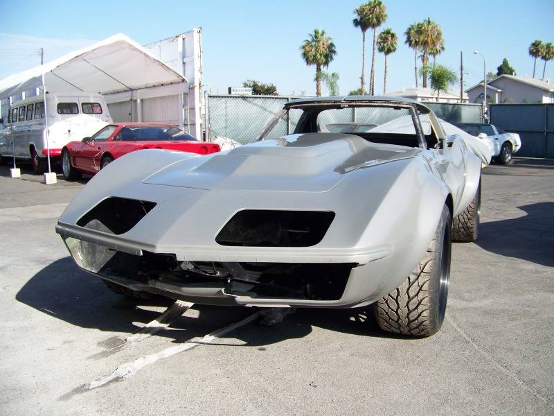

      Cut and buffed, now with the T-tops and hood painted up as well:
      Getting them to send pictures while I'm overseas has been a bit like pulling teeth but boy do I get excited when I see them pop in my inbox.
      Can't wait to get back and start reassembly. Next thing to figure out is how to mount the man pedal and the DBW LS3 accelerator.

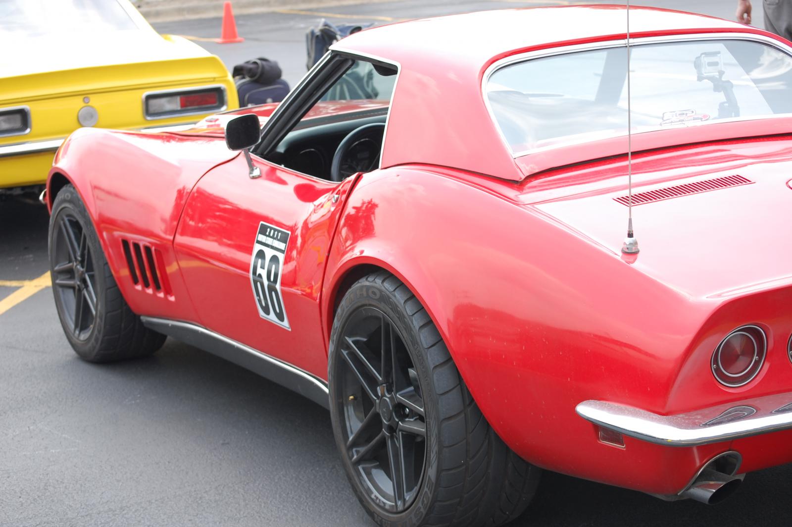

      Awesome looking ride, I will definitely be keeping an eye on your progress. I have been looking at getting wheels, but I can't decide between a CCW or something like a Fikse FM/5. I think your pics have helped me make up my mind.
      One thing to consider is if you are lowering the car is to raise the differential. The halfshafts, which act as the upper suspension arm, will be past level and cause the wheel to toe out under hard corning. I raised mine by about 3/4" to help with the bump steer in the rear. Before I did this, the car was almost undriveable when autocrossing as the ass end would try to pass me when trail braking. Now on the autocross or road courses it's pretty stable. Just something to ponder.
      Looks great. Keep the updates coming!!!
