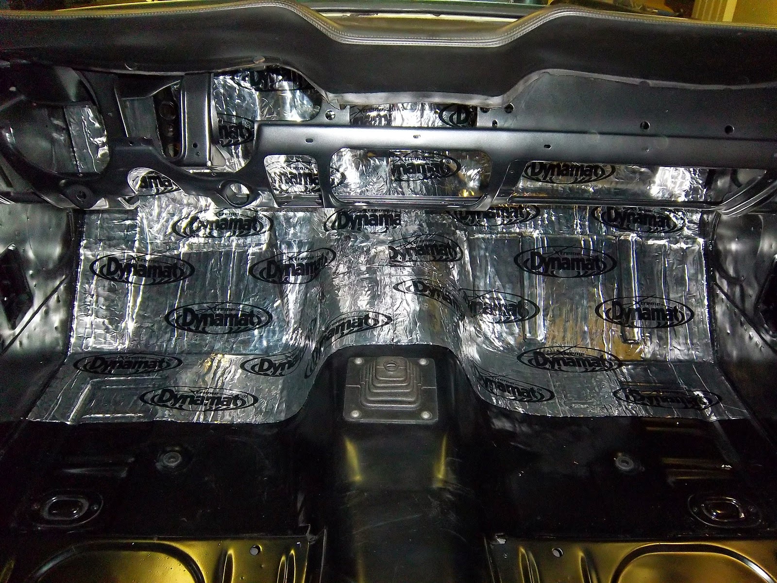

      Beginning Friday night, I started working on placing Dynamat in the back of the Mustang.
      I installed Dynamat Xtreme from the bottom of the cowl, down the firewall, but stopped immediately before the shifter. This was done after installing the new floor. I'd intended to add more to the floor and trunk panel but put it off and moved on to something else. The exhaust is quite loud so I've now returned to the project to install more Dynamat.

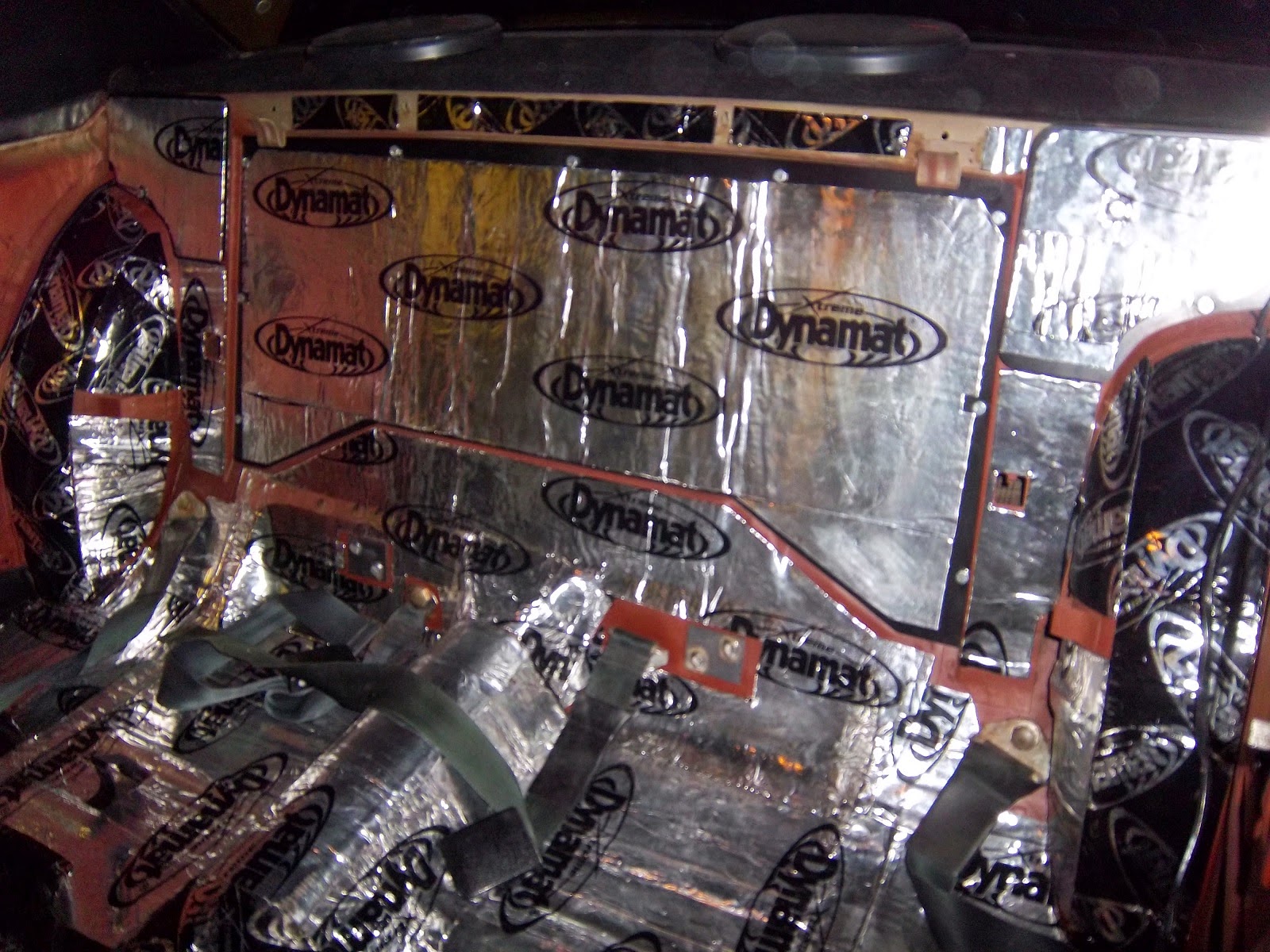

      I purchased two packages of Dynamat Xtreme (#10435) which is 24 square feet. I ended up using about 20 square feet and saved just a little. I covered the entire rear floorboard, the transmission tunnel behind the front seat, and all the panel which separates the truck from the front cabin area.
      They changed the style of Dynamat Xtreme since I did the front of the car. The silver colored type is the older style. The new style has a black coating on it. I tried to get two packages of the silver type so it would all look the same and thought I was successful until it came in the mail.
      I finished the job up this evening and started reinstalling the interior. As I rolled up the driver rear quarter window, it came off track. After inspecting it, I found one of the rollers which glides on the track moving the window up and drown broke so I'll need to order a new one. For now, I put it together so I could drive it around and not have stuff laying all over the garage.

      Wish I could have stopped you before adding that much dynamat. You only need about 25% cvg of the dampening material. I went crazy years ago with FatMat. Did the entire interior with 2 layers. Now I find out that it just added weight. You should get some dynaliner and or the dynapad to finish up the sound insulation. I'm going to be using Boom Mat Under Carpet lite and my carpet will be ordered with Mass Blocker backing on it. Check out this site for Sound deadening basics.
      http://www.sounddeadenershowdown.com/
