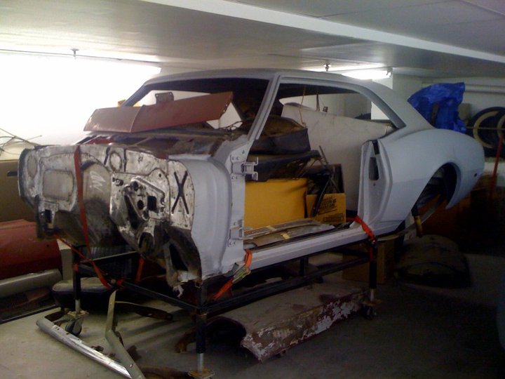

      The camaro has been my dream car since I was a kid and my wife surprised me with it. There is a TON of aftermarket support but I like to do as much as I can with my own hands, tools, and welder instead of buying every last piece. Lol. I like the idea of as much as possible, I am the only one with my exact car. (hard when your talking about an LS first gen these days though). Quick pic of my car as it sits now, shell bodywork done minus floors (new quarter, drip panel, trunk, well.... most of the shell replaced and primed with a start at smoothing the firewall. This is how a pic of how I left it in the garage for storage.
      Subframe is off, still have a body bushing mount to fix before frame gets finished up and powdercoated and I can start getting it ready for the new motor/trans. The more I talk about it, the more I can't wait to get back and start working on it again.
