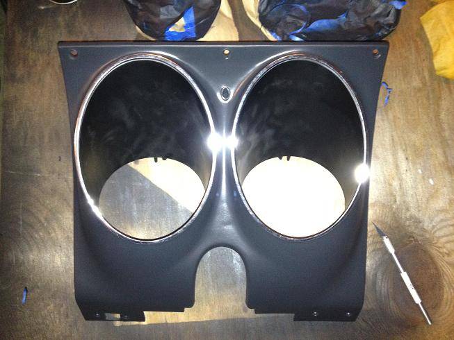

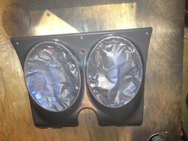

      I masked and sprayed my new gauge cluster today. The dash is flat black, and the new cluster was shiny plastic. I'm hoping this will match. If not, I'll have to mask and spray the whole dash. If I do that, I may switch to a satin black and then respray the cluster, but I'd rather not.
      This cluster already had the chrome ring, so I just cut a thin strip of blue painters tape to get the curve right, and then some thicker blue tape and masking paper to cover the inside of the bezel. Bad lighting in the photo, but that's all I got.

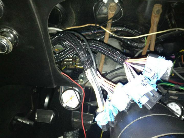

      Finished up the wiring for the gauges and wrapped everything in power braid.

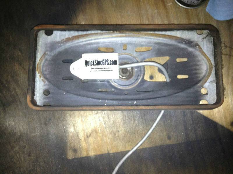

      I'm using a GPS speedo sender. I mounted it to the old center channel speaker. I painted everything flat black before installing.

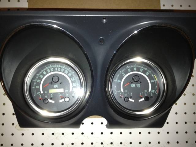

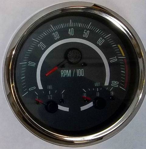

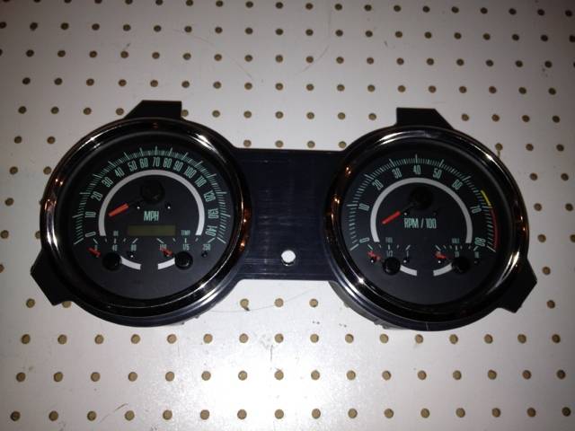

      And here's the teaser pic. I had Mark Surel from New Vintage USA design a custom set of their 3-1 gauges. I had them designed to look like the original '67 gauges, but they have a speedo and tach with oil pressure, water temp, fuel and volt meters. I couldn't be happier with the way they came out. More pics to come soon.

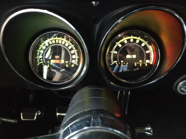

      I don't have a pic of the tach lit up, but this should do for now. I should be able to get these installed and running at some point this week.

      Mark from new vintage does good things... awesome to work with and delivers what he promises. Your gauges look really nice, its cool to see them looking factory with all the options built in. Nice choice...

      I got the gauges mounted and ready to install. They should be in tomorrow, today was a work on the house day.

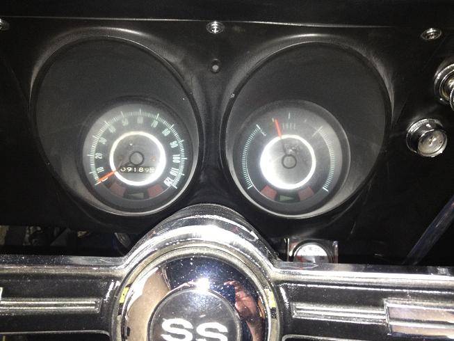

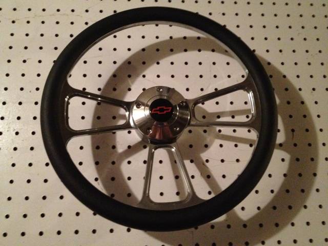

      No shortage of photos in this thread...The next project arrived yesterday. New 14" billet steering wheel:
      It's a half wrap:

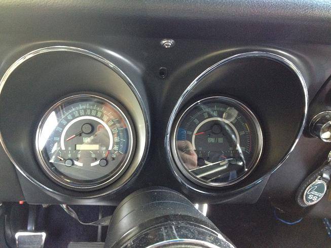

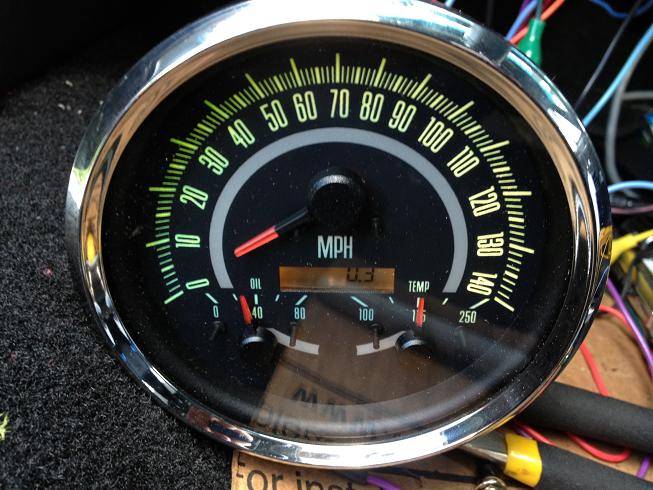

      I finally got the gauges installed. It looks like one of the lamps on the speedo is blown, so I'll have to pull them and replace the bulb. I didn't get out for a test drive, so I still don't know if the speedometer works yet, but otherwise all the gauges are operational!

      I got the speedo working. I had two issues, first when I set the pulses per minute (ppm) on the new gauges I accidently entered 116000 instead of 16000, and I also think that mounting the GPS sender to the old speaker didn't help. I think the magnet may have thrown off the speedo as well. Now it's up and running great, I just pulled the old center speaker, and mounted the sender to the bolt hole for the bracket that held the center channel.
      One more shot of the gauges, still not a great one due to the reflection:

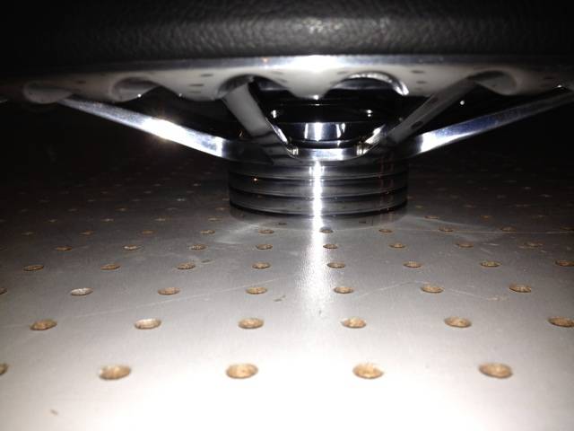

      My brackets and sliders finally arrived for the new seats, so I tackled that project as well. I had the brackets made by Wedge Engineering out of California. They built them to sit a couple inches lower than the ProCar brackets, and used different sliders as well. Unfortunately they didn't provide any directions, so I spent half the time trying to figure out what bolted to what. I also tried mounting the bracket to the floor and the sliders to the seat and putting the, bolting the seat/sliders to the brackets in the car, which turned out to be challenging. Then I tried bolting the sliders and brackets to the seat and then bolting that to the floor, which worked out slightly better, but one the rear bracket bolt holes were still pretty hard to get to.
      I wouldn't call their stuff show quality, but it does allow me a good inch above my head, which is what most people complained about with the ProCar Rally seats. At 6'0-6'1" I was a little nervous, but no issues.
