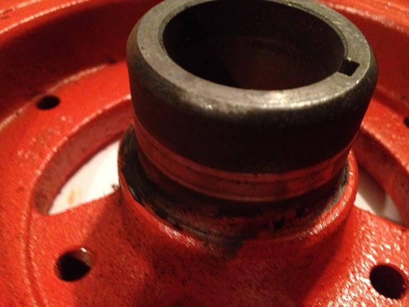

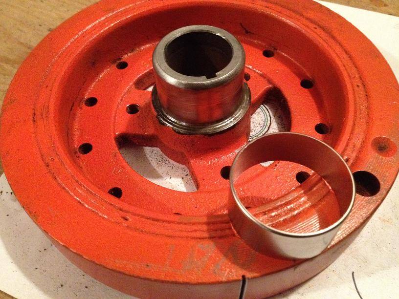

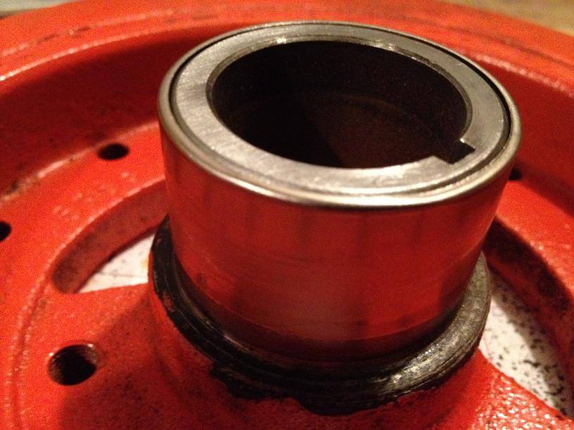

      My balancer had a pretty good groove in it, so I cleaned it up and used a Fel-Pro repair sleeve:
      Before:
      Cleaned up with the repair sleeve ready to go on. This attaches with a loc-tite like substance that Fel-Pro supplies:
      After:

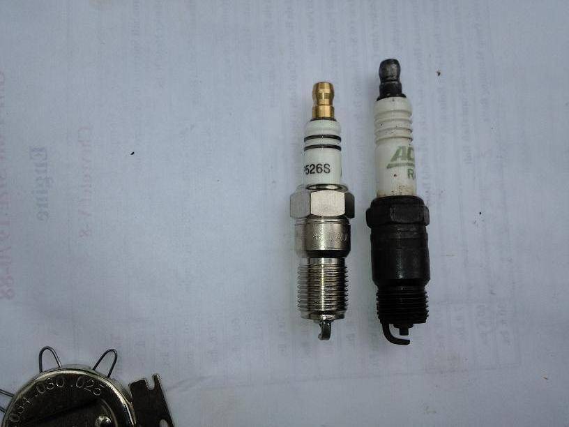

      I installed a new set of spark plugs. The Vortec heads require a plug with a .708 reach (gapped to .045), where the standard plug only reaches .460 into the block. I have read that many people switching to Vortec's have overlooked this and performance has suffered. Since I was making the switch I opted for a set of platinum tipped Accel Shorty plugs #P526S, which are designed to fit behind headers to allow removal without taking off the headers. You can see how much shorter the exterior portion of the plug is, but how much deeper the threads reach:

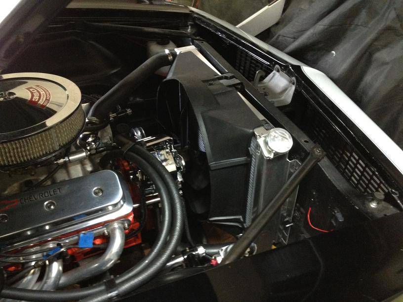

      I took it out this morning, and pulled over after 10-15 minutes and had no oil issues. I took it out for another 10 minutes and stopped to get gas, still everything was fine. A mile later at a stop light 100yds from my house I smelled a little radiator fluid. When I pulled into my driveway, there was a nice plume of steam and my radiator had sprung a pin hole leak down bottom. I almost replaced the old one while it was out, because a bunch of the fins had dents in them, but I decided it was fine for now.
      Oops. Anyways, a new aluminum radiator is on the way. I pulled the old one already, so it should only take 15 minute to pop the new on in it's place.

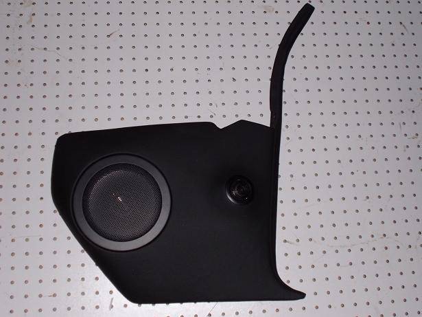

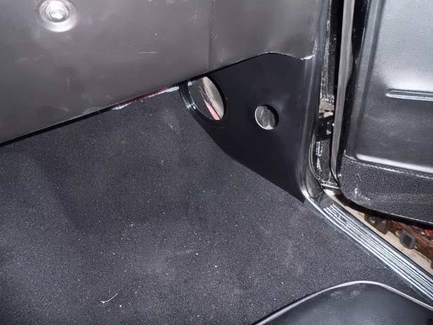

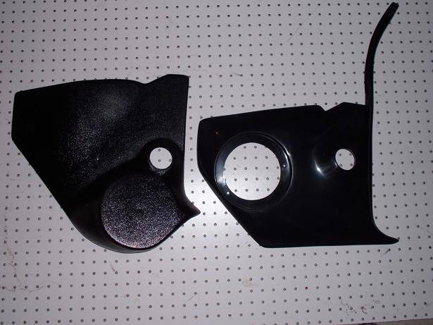

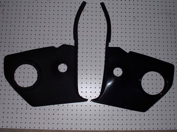

      Since my radiator won't be here until mid week or so, I got back to work on the stereo install. I only had time to work on the passenger side kick panel today. The Rod Doors panels were ok, but they were made of plastic and didn't fit very well, you also have to cut the speaker holes out yourself (which I didn't bother for the 6.5") . They also took up quite a bit of foot room. The Screamin' Performance are made of fiberglass and much sturdier, they come with pre-cut speaker openings (although I had to open up the tweeter opening by 1/8" for the tweets I'm using), and they also don't intrude on the foot space.
      Here's a comparison of the Rod Doors and the Screamin' Performance kick panels. The Screamin' Performance will actually sit in a little further once it's screwed in place. My new carpet is a little thick and pushed the firewall side out a little as seen in the photos:
      Rod Doors on the left Screamin' Performance on the right:
      Rod Doors:
      Screamin' Performance:
      Rod Doors:

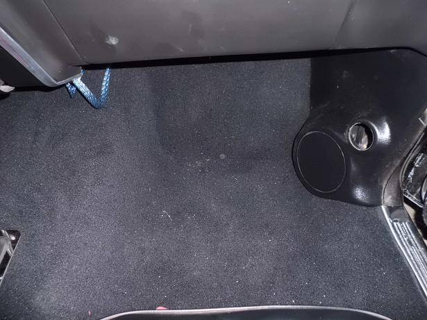

      I covered the new kick panel in black vinyl. The one on the left is covered, the one on the right is not (crappy photo):
      And here's the finished product wrapped in vinyl and with the speakers in place. Pretty clean look in my opinion:

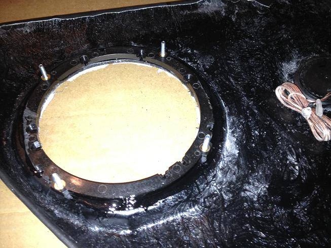

      I test fitted the driver's side kick panel today, and it went in like butter. I wrapped it in vinyl, and then epoxied the speaker plates to the back side of the kick panel. This should give it a lot more support compared to just screwing the speakers into the fiberglass, and will allow easier removal of the speakers without damaging the kick.

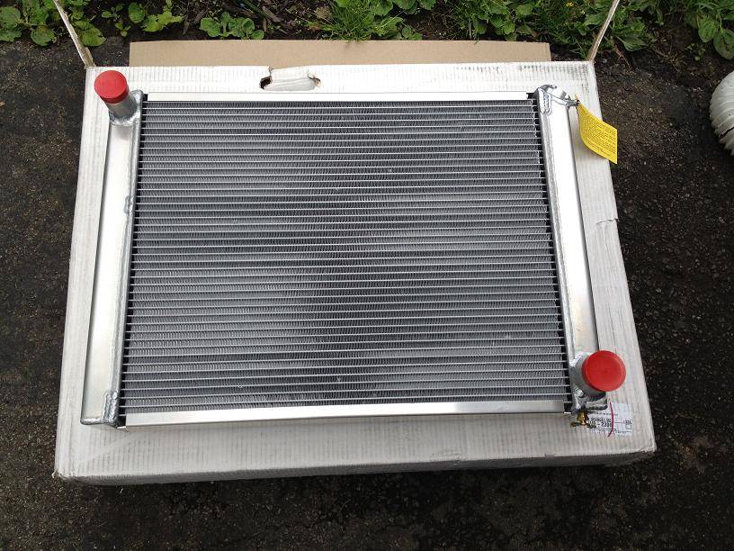

      I got the new radiator from Be Cool yesterday. This is the Direct Fit line, it looks like a nice piece. I also installed a Flex-A-Lite sacrificial zinc anode in place of the petcock. I didn't upgrade to the electrical fans at this time. Maybe later down the road.
      I need to pick up another gallon of coolant before I can fire it back up, which should be tomorrow afternoon.

      A pretty productive day. I got the radiator filled and fired the car back up. I took it out for a 30 minute spin and no problems. No fluid leaks, oil or coolant, which makes me happy.

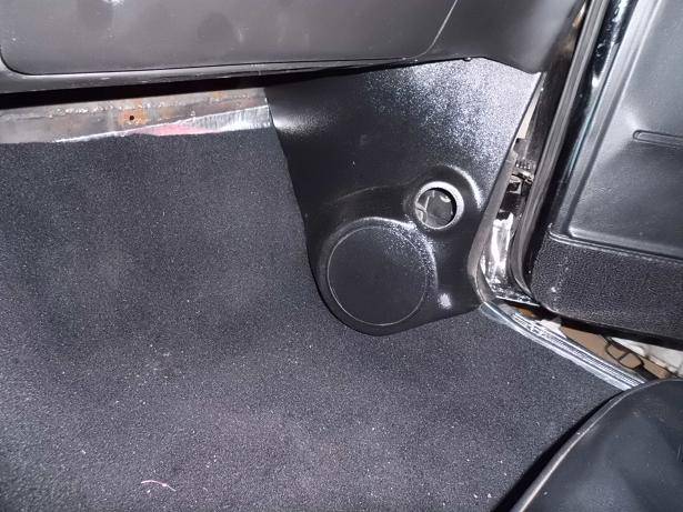

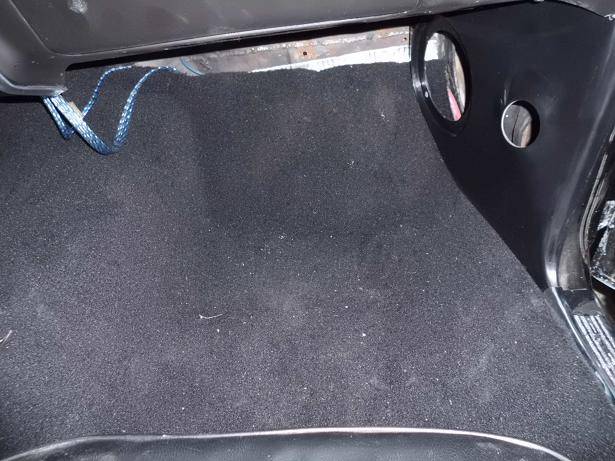

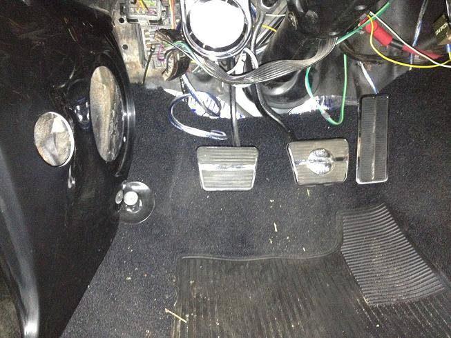

      I installed the kick panel closeout cans:
      And installed the new kick panels. I wired and installed the new Alpine 6.5" Type R speakers. I still don't have a stereo yet, so please don't ask me how they sound, but I think the new panels look killer:

      I have a set of 6.5"s in my door and have trouble hearing them. To balance out front/rear, the fronts have to be on at least a +2. I don't see how you'll be able to hear your front speakers with them so far forward and low. Love the build regardless.

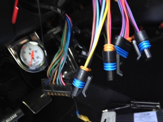

      I started wiring in the NVU gauges this week. These are going to be pretty sweet. Here's a couple pics of the wiring. Everything will be wrapped in braided hose and zip tied once I make sure all gauges are working. The connections are crimped, soldered and then heat shrinked.
      [IMG]http://i228.photobucket.com/albums/ee208/modi_photos/wiring2.jpg

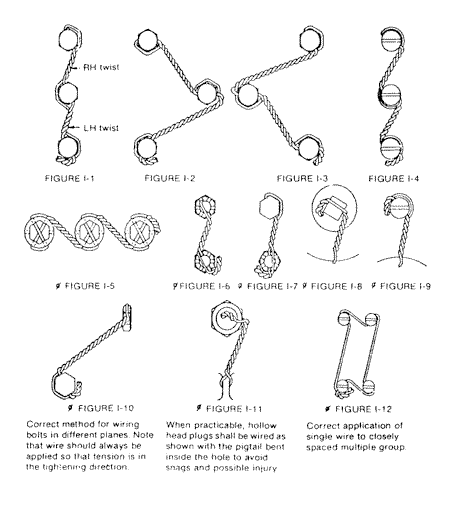

      Quote Originally Posted by MuscleRodz View Post
      Everything looks great but your mechanics saftey wire job. Wilwood show how they are supposr to be done in their instructions. this is not wilwood instructionns but technique the same.
      I was going to say something, glad someone did on the safety wire, Nice pics and updates,
      Late to the party as ususal, Brians stuff is nice, all the updates look good,

      Thanks, but I'm not too worried about that. I'm running three amps, each with an adjustable gain, so I can dial in the power to each set of speakers pretty well. Plus, the front tweeters have their own gain adjustment so I can really dial in not just how loud the front channel is, but also how loud the woofer is vs the tweeter. The whole system should be around 1000w RMS.
