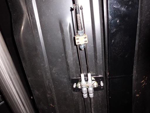

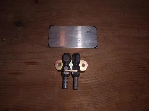

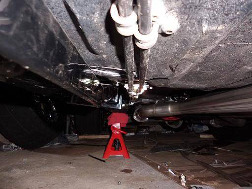

      Since I upgraded to the Wilwood discs in the rear, my parking brake setup wasn't functional any longer. I bought the Lokar e-brake cable (EC-81FU) which replaces the intermediate and rear cables, and comes with just about everything you need. They sell a separate front cable to attach the foot brake to the new intermediate cable. I decided that I wanted to keep the factory front cable, so I did some mods and fabricated a mounting bracket. I finished up today, and it seems to work great.
      Top pic attaches to the front cable, bottom pic to the rear brakes:

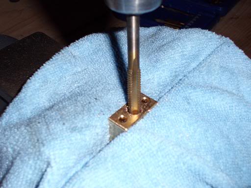

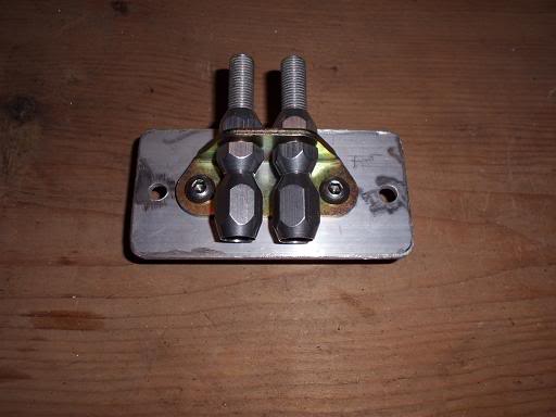

      I decided to use the brass block as my tensioner. The brass cable block is drilled for 5/16-24, and of course the Camaro uses a 5/16-18 bolt for it's tensioner. Initially I tapped the block for 5/16-18 and it fit perfectly, but I realized that the block needed to be able to slide on the tensioner bolt, rather than be threaded on it. I drilled it out with a 5/16 bit later.
      I cut a piece of aluminum to fabricate a mounting bracket for the cable housing.
      Test fitting:

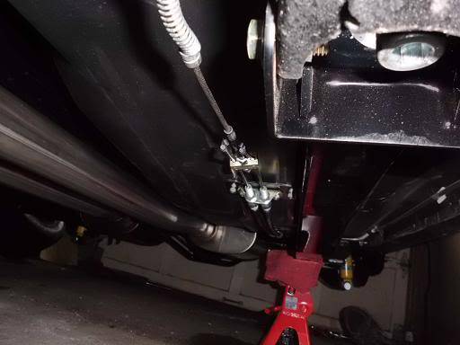

      I sprayed it black and mounted it to the floor pan, this is the connection between the original front cable, and the new Lokar cable. I used two nuts on either side of the brass block, and can adjust the e-brake tension by tightening or loosening the nuts:
      Here's a view looking towards the rear:

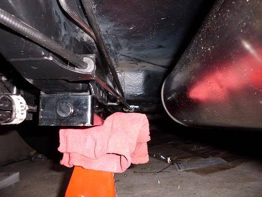

    6. #66
      Jan 2011
      Boston, MA
      1,180
      Looking forward:
      The rubber lined hold downs I used to keep everything in place:
      Routing across the tunnel for the passenger side brake line:

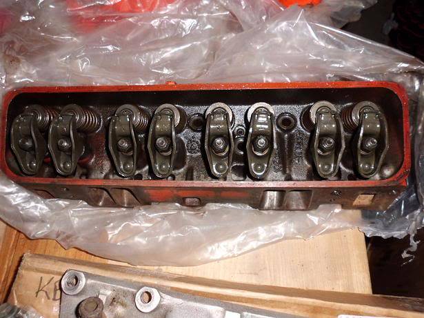

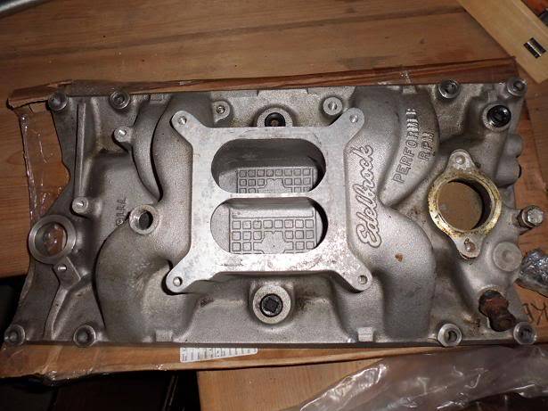

      I picked up a nice set of used Vortec 906 heads and an Edelbrock Performer RPM intake. These will go on later this spring. I'll probably swap out the stock valve springs for some beehive springs to pick up a little more than the stock .480 max lift. I'll figure out what cam I'm going with once I determine whether I can use a roller cam or not. I'll clean everything up before it goes on the car.
      906 Heads:
      Intake:

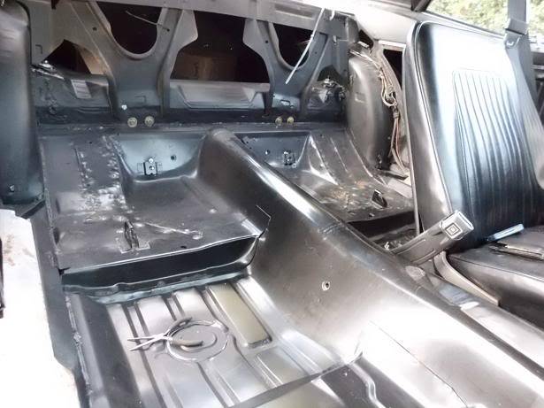

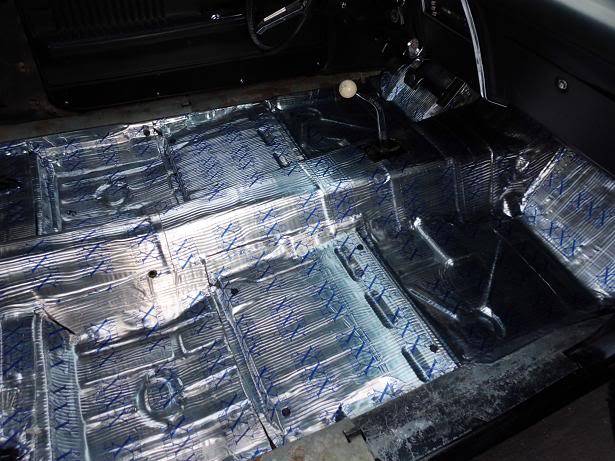

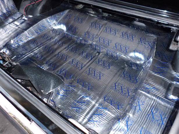

      Had a little warm weather and a couple of hours to kill. I pulled the rest of the carpet out of the front, vaccuumed and cleaned everything down and began to install the sound deadener. I tried this in cold weather once, and it was a huge waste of time. At 50-60 degrees, it's much more pliable. I finished up sound deadening the cabin. I'm going to try to do the trunk and trunk divider before the weekend.
      I still need to purchase and run the speaker and amplifier wires to the trunk, and then paint the wire channel covers. They are galvanized, so I'll have to find a latex based spray paint to use. Then it will be time to purchase the carpet and begin that install as well.
      A before pic (nice new floors):
      With some sound deadener. I'm using FatMat Rattle Trap Xtreme:

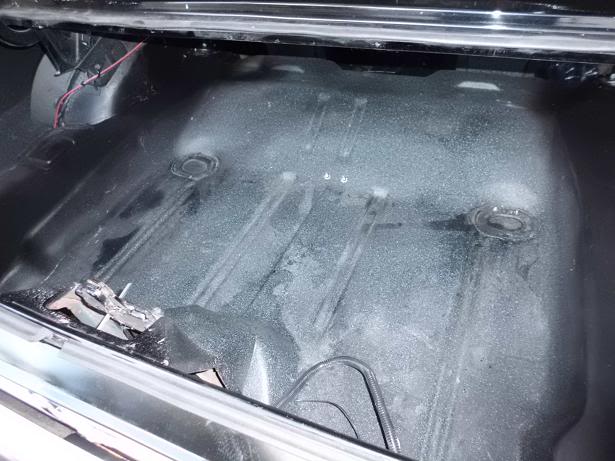

      I finished up most of the trunk today. I just have the package tray left, but I'm going to wait until I buy the rear speakers before finishing that.
      Before:
      After:
