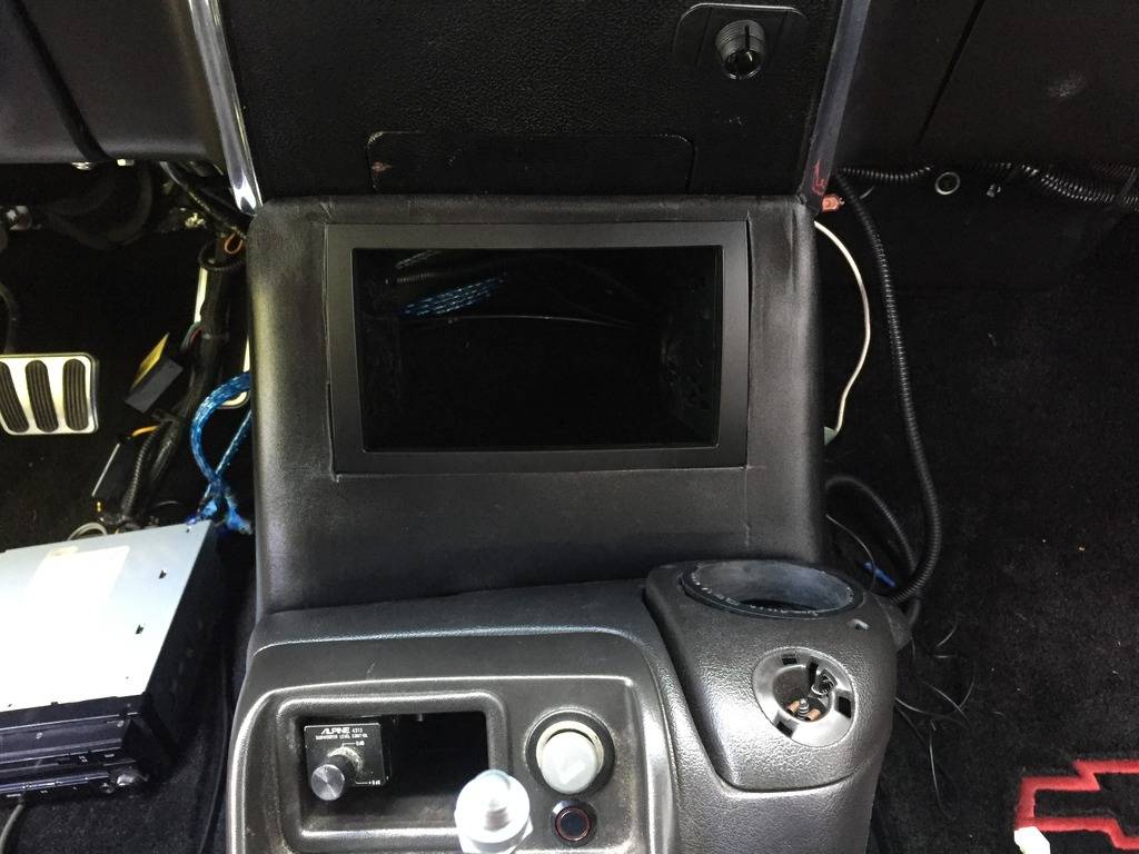

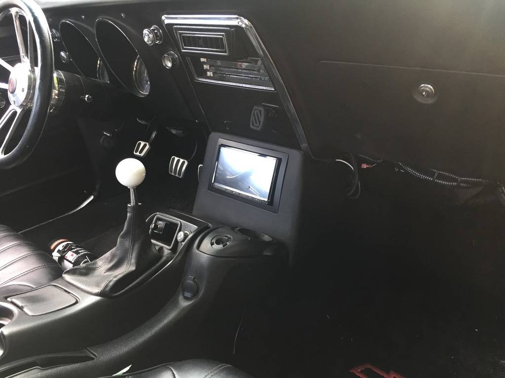

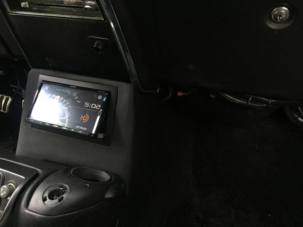

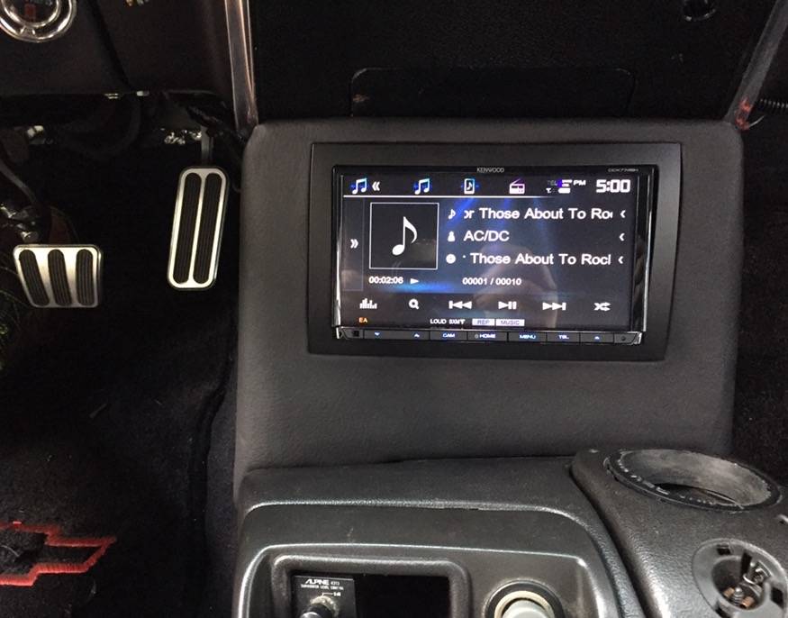

      A couple last pics of the stereo, not so close up:

      New console part blends in nice by the way. Ain't no one way to make such an item. Nice to see one that doesn't weigh about 40 lbs from all the mdf glued up together.

      I like your console addition. I've been struggling to find a solution to supplement my 69 Impala console "cap" with something useful to hold gauges.

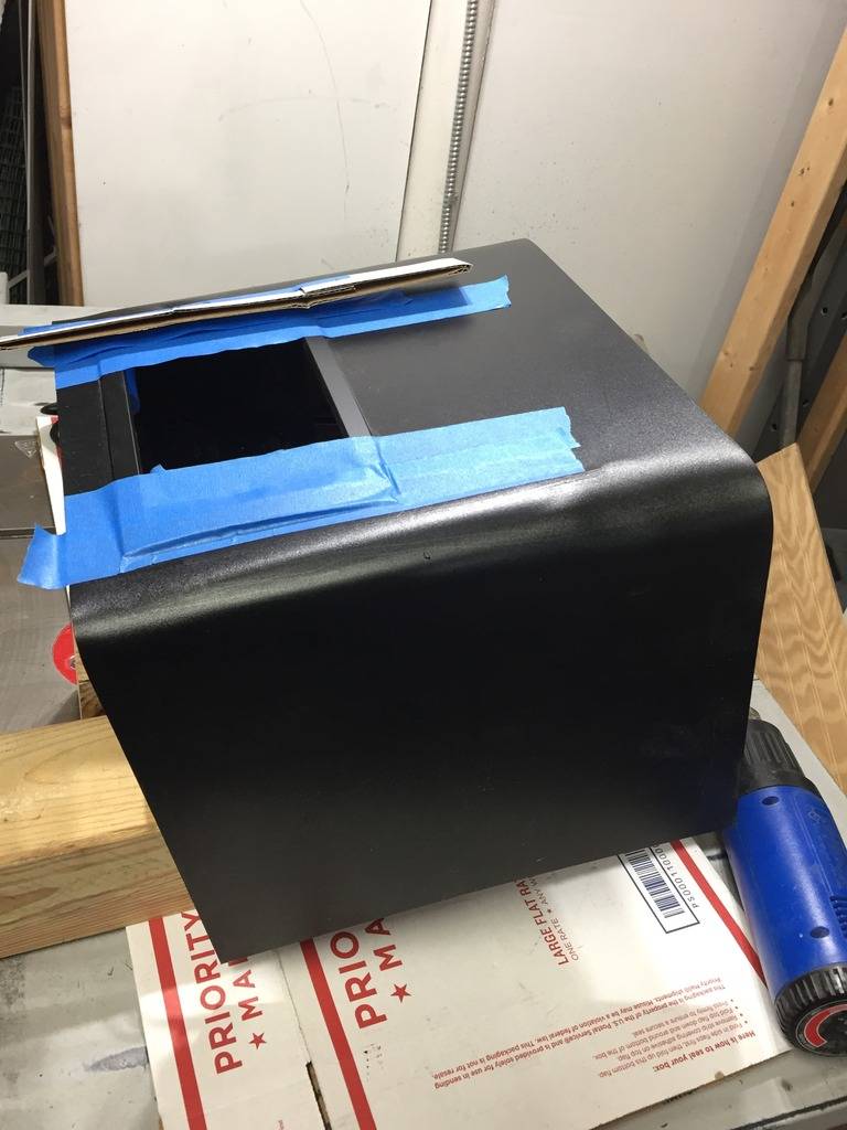

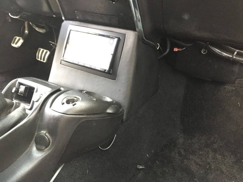

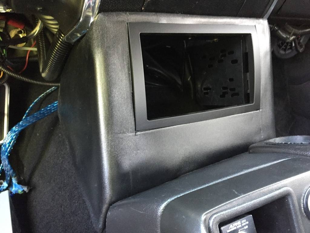

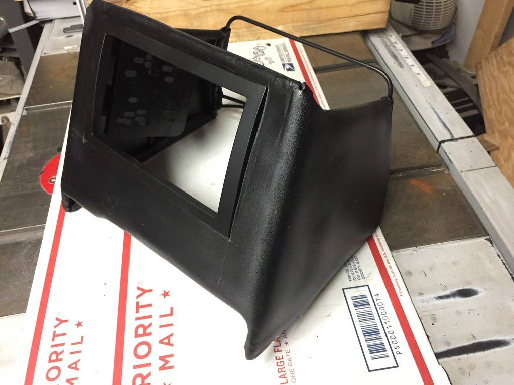

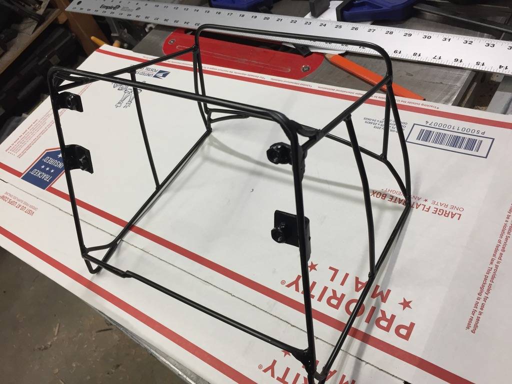

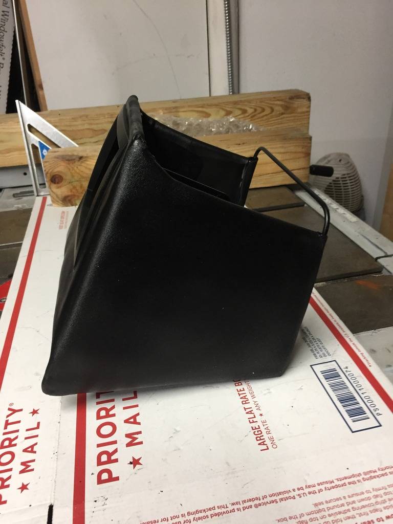

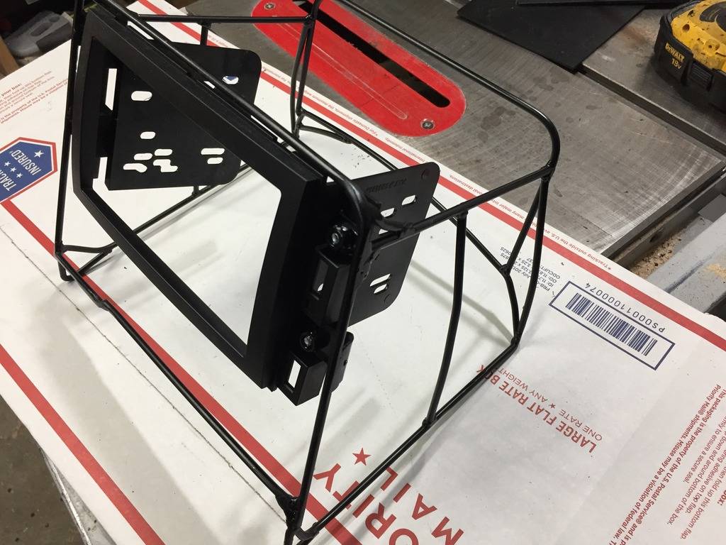

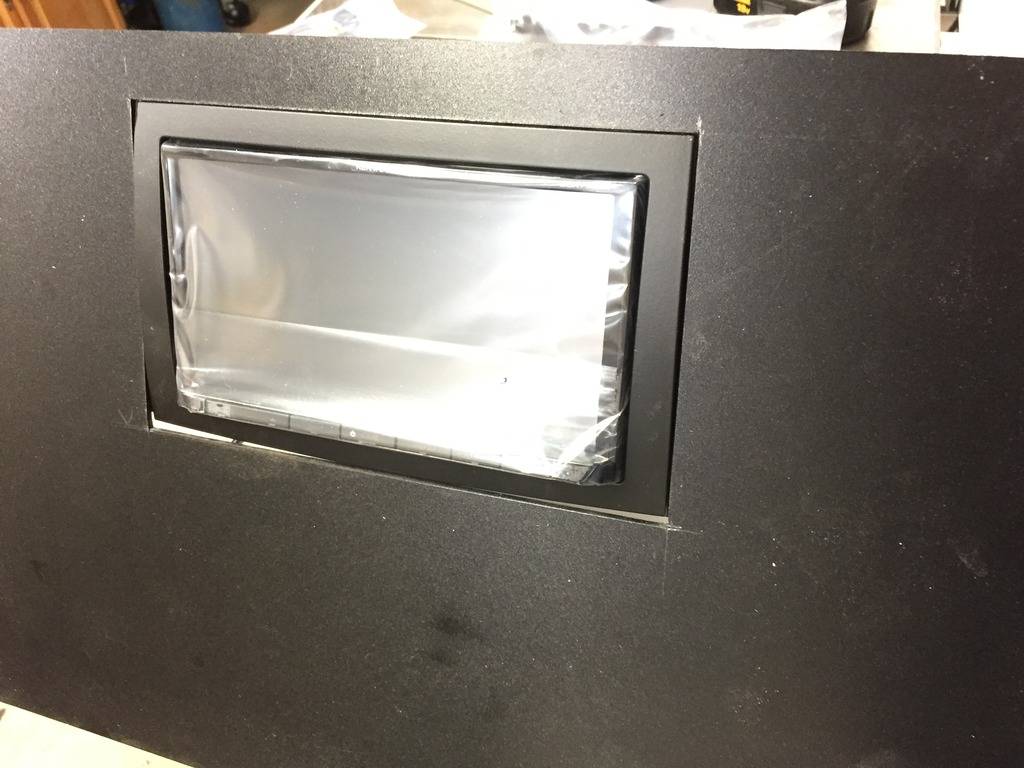

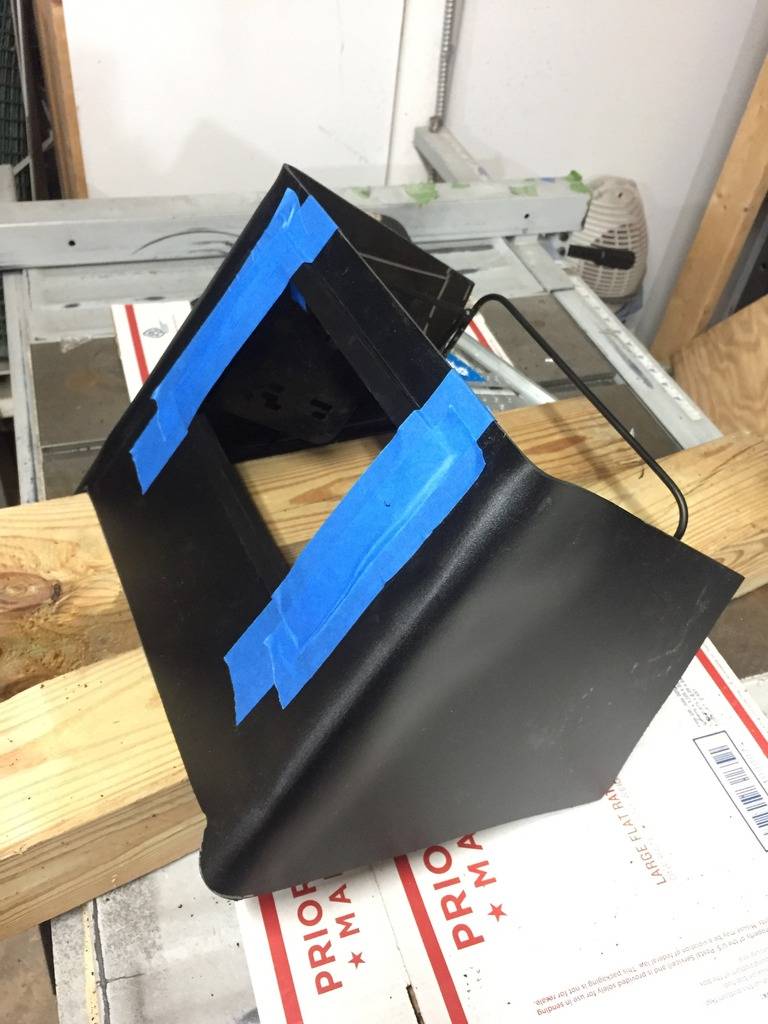

      Quote Originally Posted by 67rally View Post
      This is the final framework I ended up with. I added 4 mounting tabs and welded a nut to each:
      With the dash kit/bezel I'm adapting to:
      I cut out an opening to match the outer perimeter of the dash bezel, and placed the foam board PVC into position:
      I taped it in down to keep the bezel in place, and began heating with a heat gun to make the first bends:
      Did a rough trim to get ready for the more intricate bends:
      Semi finished console. The PVC bends nicely with heat, I was able to fully wrap it around the 3/16" round bar to hold everything in place:
      Mocked up for final fitment:
      I went back over all the uneven panels with the heat gun and got it pretty smmot/even.
      I used High Strength 3M spray adhesive to attach the black vinyl. Took my time to get it right:
      It wired up very easy since I was just replacing the old one. I think there were only 5 or 6 wires to cut and splice. A little washed out, but here's the final product:
      Tilting screen:
      Ready to Rock!
      Did you find that the plastic was a better choice to work with over the fiberglass? I really like your frame you built.
    13. #573
      Jan 2011
      Boston, MA
      1,180
      Quote Originally Posted by sandiegocamaro View Post
      Thanks, the plastic was very easy to work with, but I don’t think it would be great for complex shapes. I made my old one out of fiberglass and it was very messy and time consuming. This was much quicker/cleaner. With a few simple curves, it stiffens up very well as it cools.
