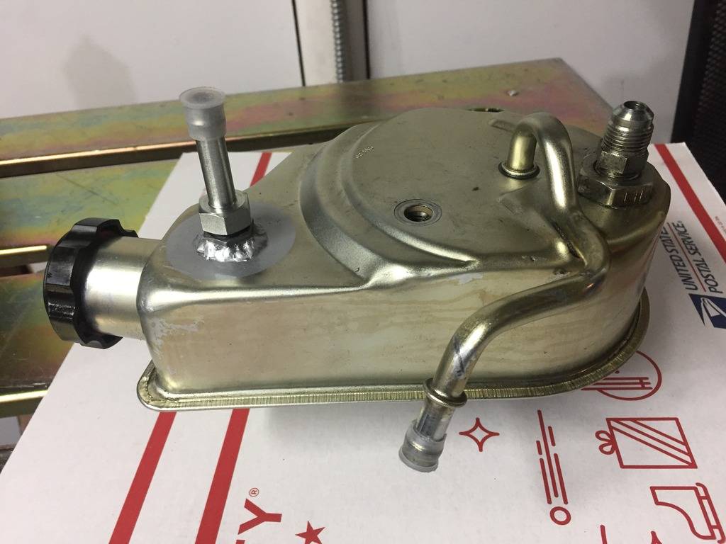

      Adding a second return port to my PS pump:
      Here it is with a single return down bottom:
      Here's the 3/8 o-ring port:
      Mocked up:
      Welded up:
      Painted. Yup, it doesn't match, I didn't have zinc colored paint, didn't want the welds to rust, and no one will ever see it anyways...
