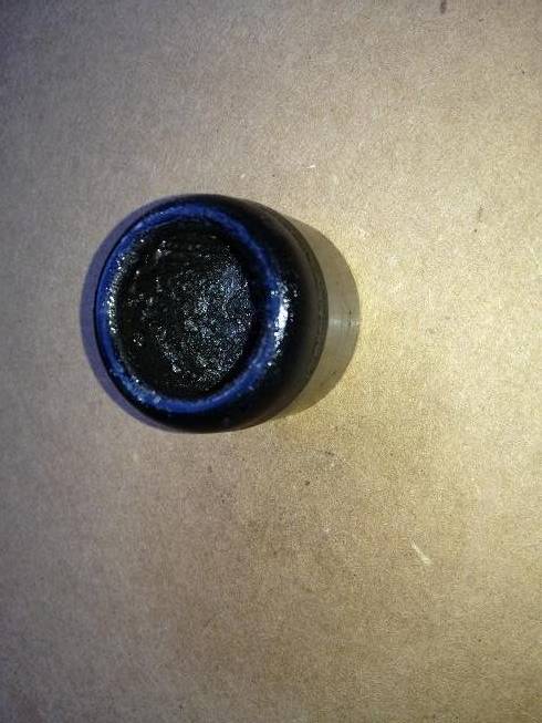

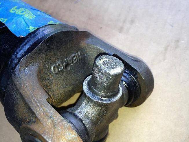

      I decided to investigate the vibration I was having at highway speeds (also the reason why the tuner shut the dyno test down early). A friend of a friend said "Don't drive it, it will eat parts." I'm glad I listened. Luckily almost all of my driving has been around town to break in the clutch, and only a few short blasts on the highway.
      It turns out, the idiot (code name 67rally) that installed the engine and transmission is the same guy who measured the rear pinion angle. I guess I mistakenly wrote down a positive angle for the rear pinion angle and then matched the trans angle in the opposite direction so that the trans angle and pinion angle would be equal but opposite. This puts them parallel to each other, but not in the same plane. And then I didn't take into account the 1-1 1/2* that the diff rotates under load. It turns out that the pinion angle was actually negative, so I had the trans facing down towards the rear, and the pinion facing down towards the front. And when the axle rotated back, it added another degree or so. Blah, blah, blah. Long story short, they were way out of whack, and I need to shim the differential up 4 degrees. My fault, luckily I caught it early.
      I also found the U-bolts holding the axle were loose. Not sure if this caused some of the vibration, or if the vibration caused them to come loose. Anyways, the rear end is not perfectly facing forward any longer. The passenger side needs to come forward, or the driver's side needs to go back.
      I bought a couple cheap laser levels, and mounted them to some angle stock so I can place one against the trans output shaft, and the other on the face of the pinion yoke and line everything up when I do the shims.
      My fault for rushing the job to get it to the tuner in time. Just a reminder not to take shortcuts, luckily this time it's only going to cost me a U-Joint:
      Here's the bearing cap and bearing mush that's left:

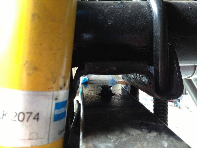

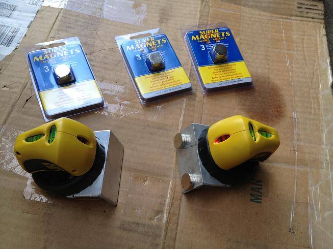

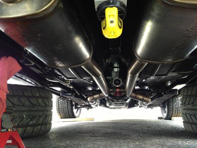

      I spent about 4 hours under the car lining the drive train angles up. Lots of pics.
      Here are the el cheapo laser levels that I bought from Home Depot and mounted to a piece of angle aluminum. I bought some "Super Magnets" and placed a couple on each side, sandwiching the aluminum, so I could attach it to the pinion. I had a few times where the magnets didn't cooperate and I have a couple blood blisters where the suckers pinched my skin. These are serious magnets!
      Here's a nice blurry photo of where my pinion was pointing. The laser level is attached to the face of the pinion with the magnets:

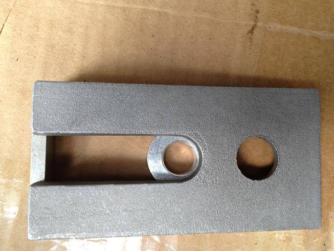

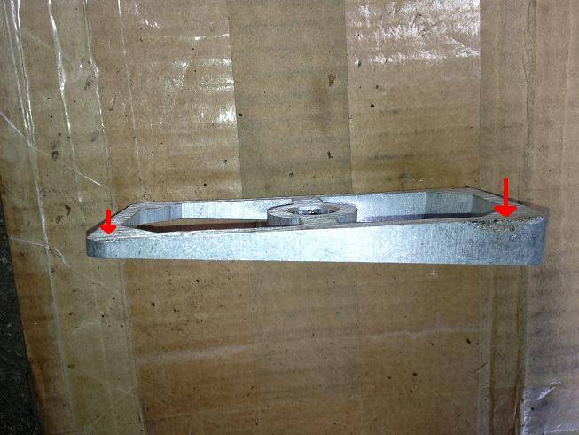

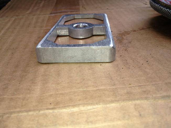

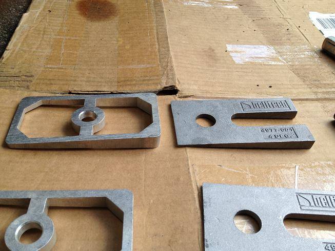

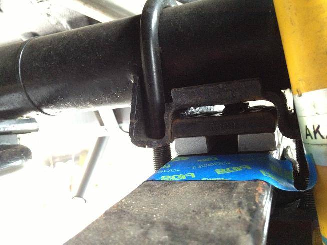

      I bought two different kinds of 4* shims. The "hollow" ones are from Speedway Motors, and the ones with the long cutout are from Belltech. I wasn't sure which I would use, and better to have a couple options once I was under there:
      I jacked up the rear by the axle, supported the car under the subframe connectors and under the leaf springs, loosened the U-bolts around the axle and then raised the diff until the leaf springs were "floating" between the axle and the shock plate. I removed the urethane pad, and here's the pin on top of the leafs (looking towards the rear):
      Here's the Belltech shim on top of the Speedway Motors shim. The hole in the Speedway shim was the perfect size, while the Belltech one was too big and could allow for some movement.
      This was the Belltech shim with the urethane pad on top. With the monoleaf spring perches, the leafs would not even be in the perches:
      I decided to go with the Speedway Motors shims and no urethane pad. The corners of the spring perch are rounded a little, while the shim is cut at 90 degree angles and hit along the edges. The arrows show the witness marks:
      I rounded the sharp edges over with a bench grinder and then my angle grinder with an 80 grit disc:
      I moved the passener side of the axle slightly forward, and the driver's side slightly backwards and bolted everything back together...A little better alignment:
      I took it out for a test ride, and was out for about an 30 minutes. I hit the highway...parking lot. Route 1, parking lot. I couldn't get over 35mph before I ran into more cars. I hit some back roads, got up to about 60 from a stoplight and tmore traffic. I went everywhere I could think of that had an open stretch of road and spent most of my time parked in traffic. I'll test again tomorrow. I didn't have any vibration, but couldn't really get it up to speed to say for sure.

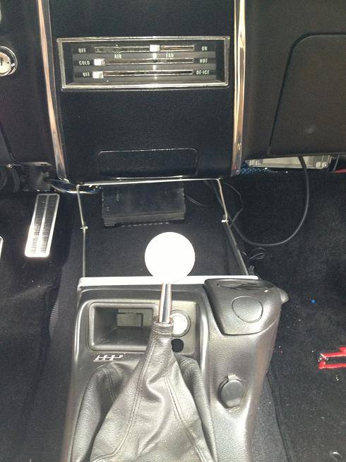

      I haven't really gotten to it yet. I'm using a 2002 Camaro console from a 6 speed car. The console fits the tunnel pretty well. It wants to lean towards the passenger seat a bit, but I haven't screwed it down yet either. The console is too short for a first gen, but I'm going to fabricate a filler piece out of mdf or aluminum, then staple felt over that, fiberglass it, sand it smooth, and cover with vinyl. Once everything is together, I'll spray the vinyl and plastic parts with the appropriate black SEM paint so it matches the interior. It looked black when I bought it, but compared to the rest of the interior it has too much of a gray tone for me (tough to see in the pics).
      Here it is loosely installed:
      And here's a very sophisticated Microsoft Paint job to show where the closeout panel will run:
      I have a plan, but I'll post photos along the way, because that plan may change as I go.

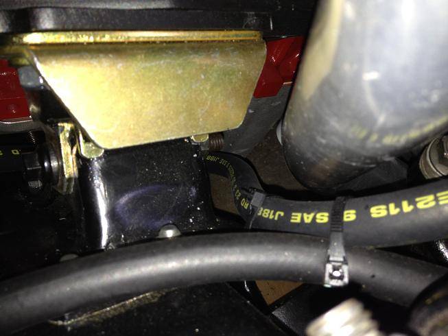

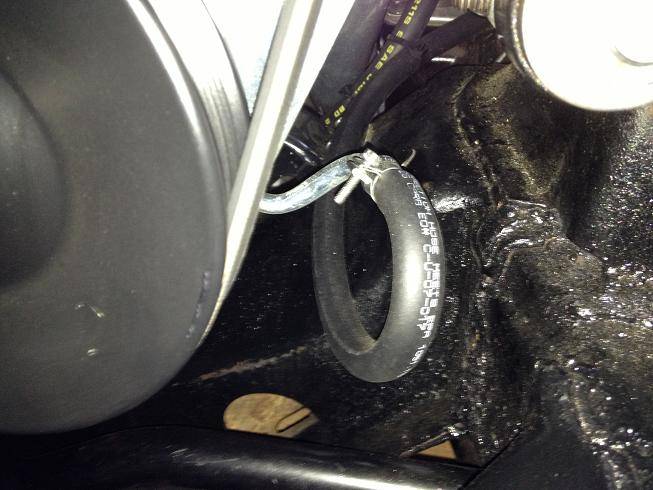

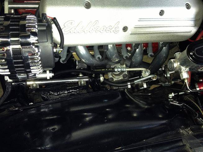

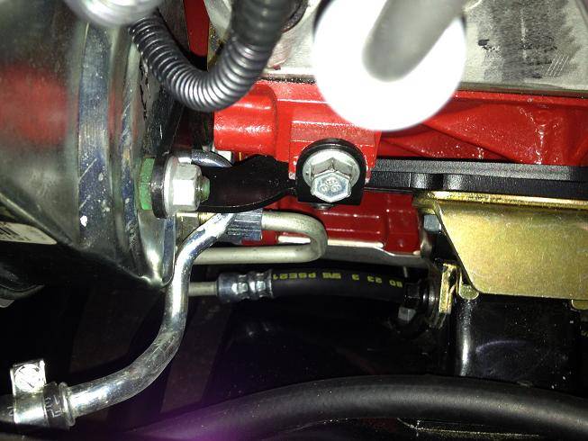

      I'm using stock '69 (not '67) Camaro PS hoses. I ended up needing a longer run for my return line, so I used some fuel injection hose for that line. I went with FI hose, because it is more rigid, and needed something that would not collapse on a tight bend.
      Here's the routing from the PS box. The pressure line makes a 90 degree turn in front of the #1 header, and another 90 behind the frame mount. I have it zip tied to the return line hose to keep them from hitting the header and the upper control arm. I also have a second zip tie on the pressure hose connected to the frame mount. The return line travels straight forward and past the pump, making a U-Turn for the connection:
      Here's how I have the hoses tied together:
      Here's where the pressure line connects to the pump and runs between the frame mount and oil pan:
      Here's the U-Turn for the return hose. This pic is looking from the front of the car towards the firewall. The PS pulley is on the left of the pic:

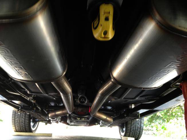

      Update on the driveline...I got almost all of the vibrations gone. I still have a slight rumble at 70-80mph that goes away under acceleration. This generally means that the pinion needs more upward angle (since when you accelerate the pinion rotates upward). I ordered some 6* shims to replace the 4* ones I just installed. If this turns out to be too much angle, I can lower the angle of the transmission a little to fine tune it.
      Good news, I just hit 500 miles on the new Monster Stage 2 clutch and let her rip. All I can say is FUN! 0-60 is crazy fast, and this engine loves to rev! 0-100 is really fast as well (I'm assuming it is, obviously with the speed limit set at 65 around here, I wouldn't know.).

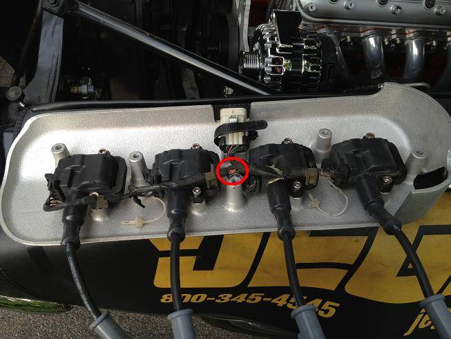

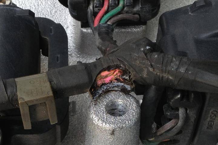

      Well, that didn't go so well. I was supposed to cruise up to Maine today with a bunch of guys from Team Camaro. I put 100 trouble free miles on yesterday, topped off the fluids and was ready to go.
      I got up long before sunrise this morning, hit the road at 5am and within 10 minutes I had a mechanical issue. It felt like it wasn't getting spark or fuel, so I pulled off the parkway into a sketchy section of town and into a gas station. It felt like it was dropping cylinders, but occasionally they would all come back and run smooth for 10-15 seconds. The driver's side headers didn't feel as hot as they should have.
      I couldn't get to my coil packs because of the coil covers I installed, so I couldn't do much trouble shooting. Once it started running ok, I turned around and headed home. It ran good for a couple minutes, then the problems returned. I limped home, pulled off the coil covers to start trouble shooting, and this was what I found under my driver's side cover:
      The wiring harness was rubbing on the cover and ate through the wires. If this had happened yesterday, I could have fixed it by this a.m. Anyways, I removed the covers and LS1 coils, bolted my old LQ9 coils to the valve covers, put the old wiring harness back on, cleaned the plugs, and she fired right up. Cheap fix, but I'm pretty bummed I missed out on the cruise.:(

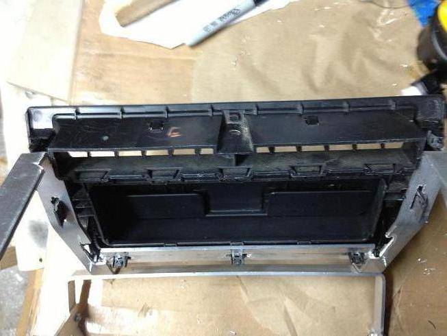

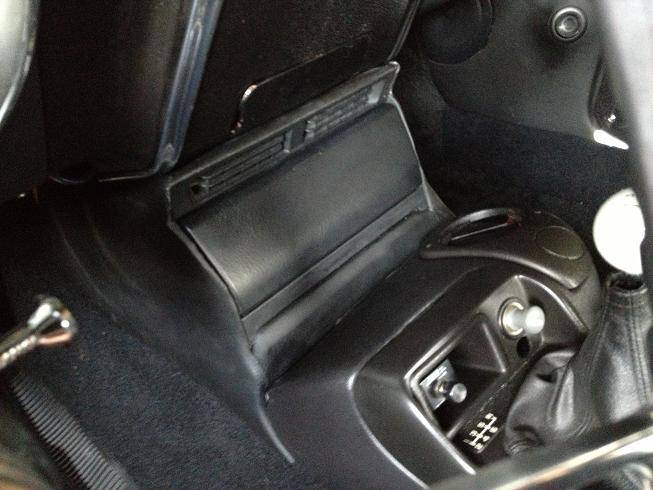

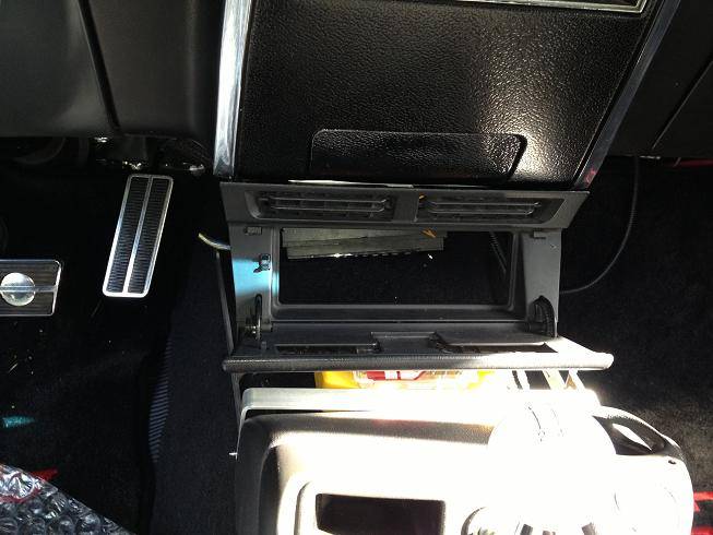

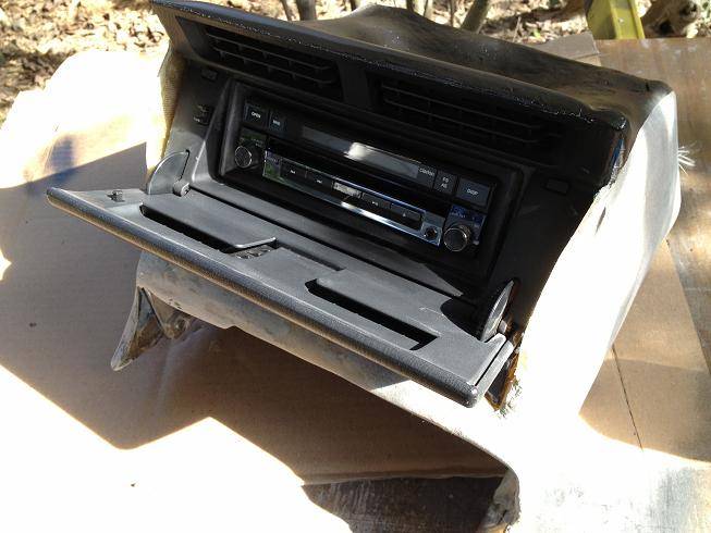

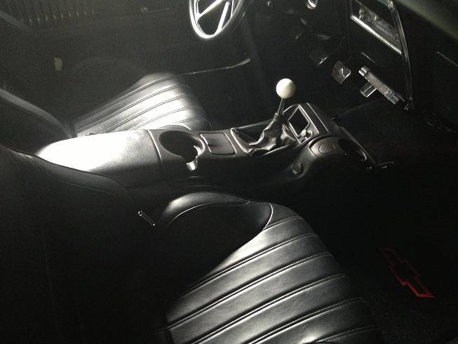

      I have been working on a closeout panel for my console over the past couple weeks. I'm using the console out of a 2002 Camaro. It fit's the tunnel great, has an armrest, cup holders, etc. but doesn't meet up with the dash.
      ***THIS IS NOT A HOW TO***, it is a "how I did it". I have no experience working with fiberglass. I just saw it done on some TV show, probably West Coast Customs, or Over Haulin'.
      Skip to the end for finished results...
      Here's what my rough vision was:

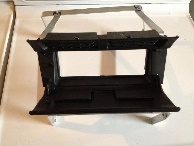

      I found this radio bezel for a 2001 Honda S2000 on eBay and it looked to be about the right size:

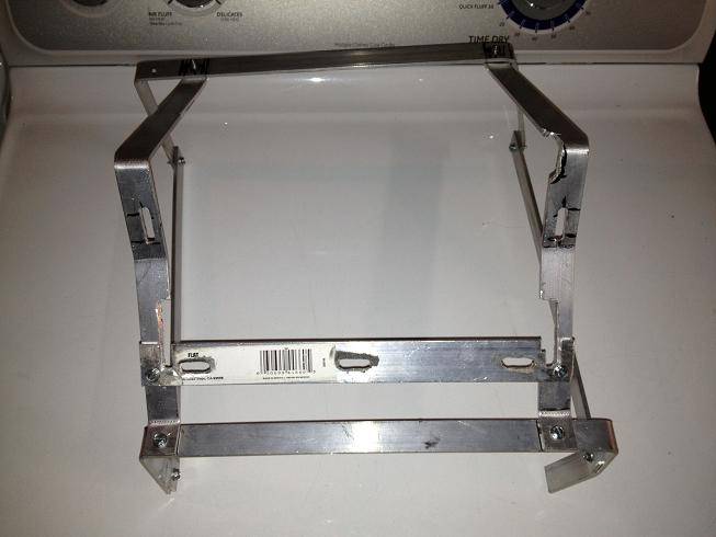

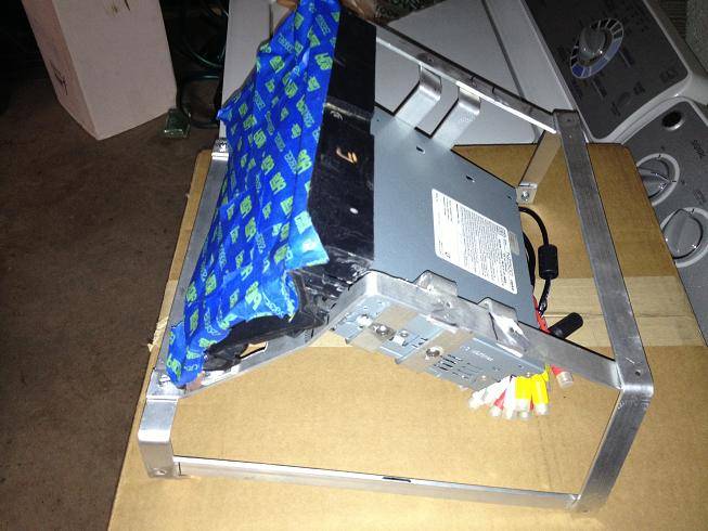

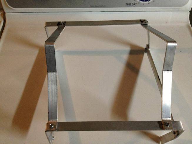

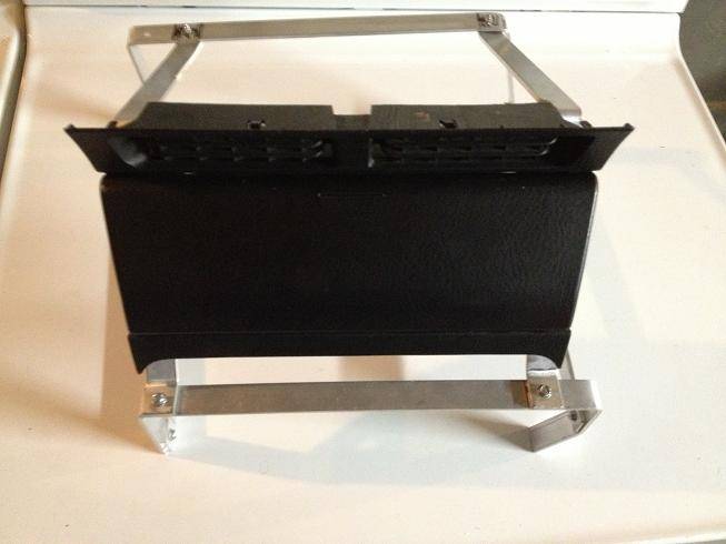

      I started with some aluminum stock (light weight, easy to bend and I had some lying around). The console sits a little towards the passenger side, so the aluminum looks and is crooked. No worries, since I was going to be covering it in fiberglass. I just wanted it to mold to the tunnel:
      I added two more pieces that I had shaped to the radio bezel:
      Cut out some openings for the clips on the back of the bezel to fit through:
      And mounted it up:

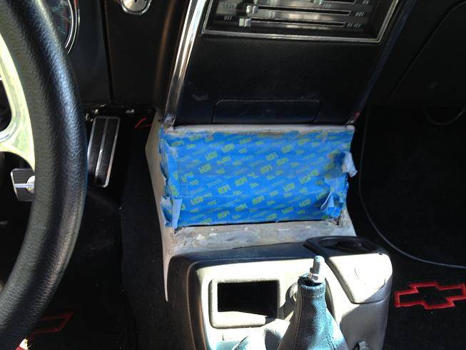

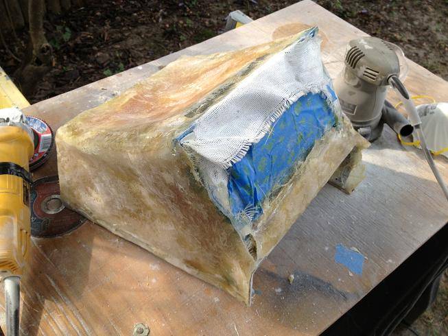

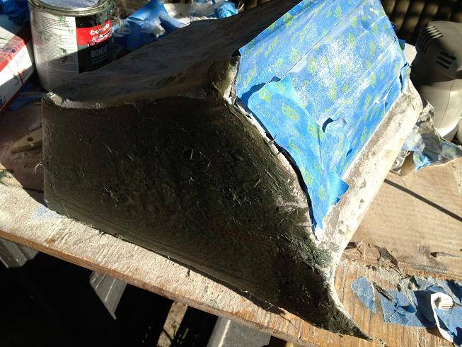

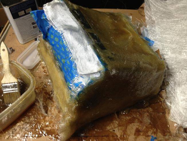

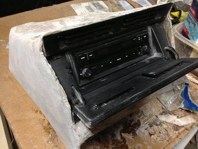

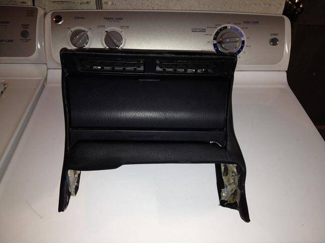

      I taped off the front in preparation for the fiberglass.
      I started with some fiberglass cloth, resin and hardener.
      Sanded it, added fiberglass mat to the areas I needed to build, sanded it:
      Then started my layers of Bondo Glass:
      I didn't finish the top, since it will not be seen, and I didn't want to build it up due to clearance issues. Since I was going to cover it in vinyl, it just needed to be smooth, but not perfect. If I was going to paint it, I would have moved on to some Bondo body filler for a glass like finish.
      Test Fitting:

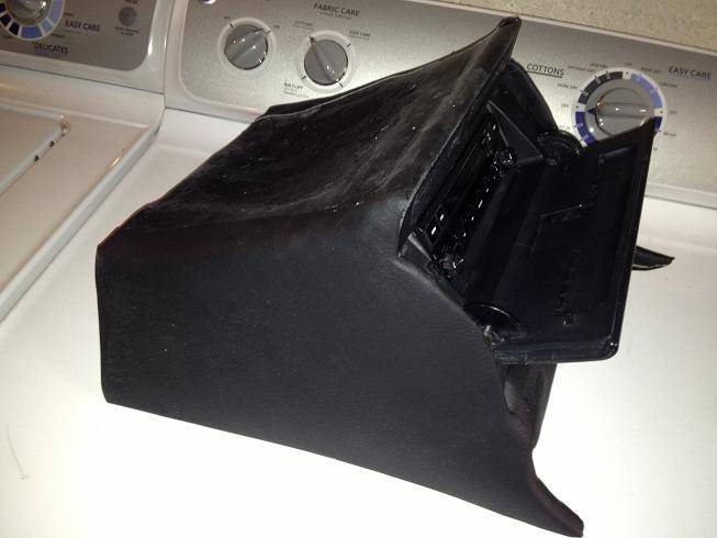

      I sprayed the top lip with black plastidip to give it a rubberized finish:

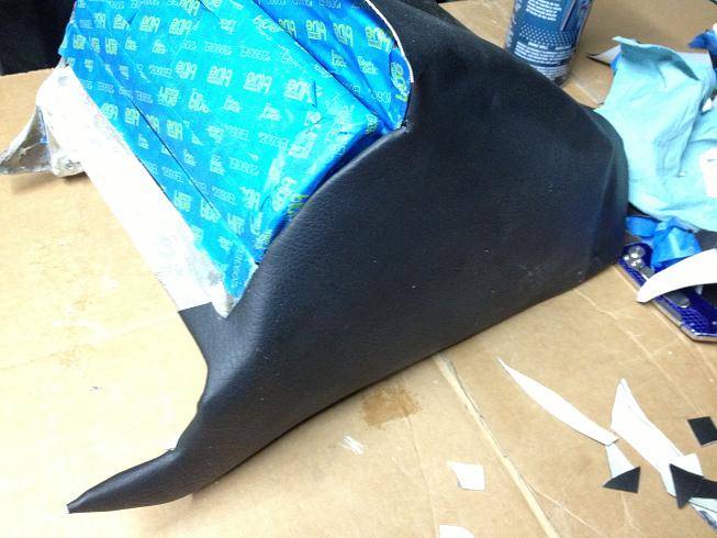

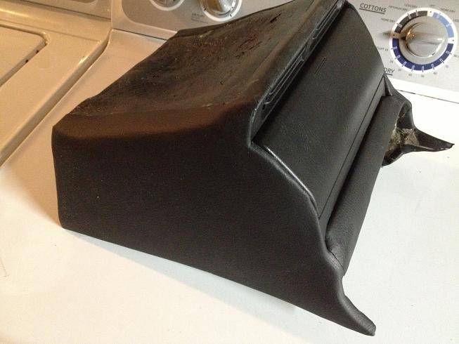

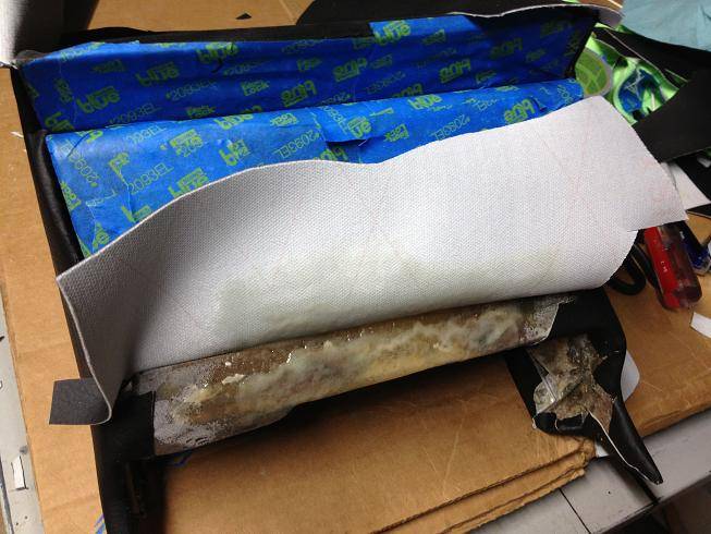

      Started covering it in black vinyl, using 3M 80 Rubber & Vinyl Adhesive:

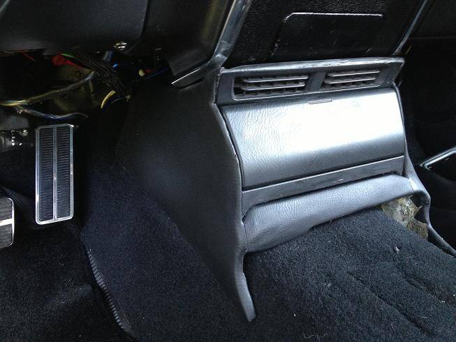

      I knew I was going to have to have some seams because the angles on the front were pretty complex for someone of, uh, my skill level. I decided to seam it in line with the where the door opens. I probably should have made some grooves with a dremel and flushed it in, but it'll do.
      Test fit:
      Here it is installed:

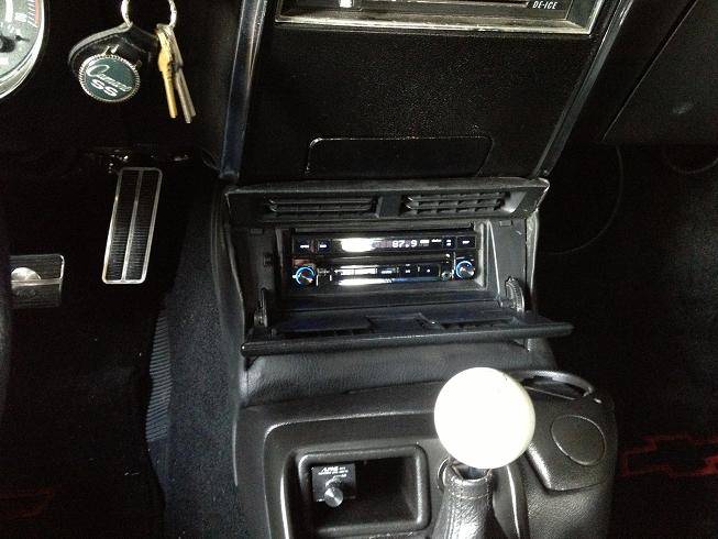

      Radio is in and working:
      This is a Clarion NZ500 I picked up off eBay. It's a couple model years old, but I actually preferred it because the new models don't have knobs to adjust the volume, just buttons. Touch screen, iPod controls, Nav, backup camera (if I want it):
      A couple more shots of the finished install:
