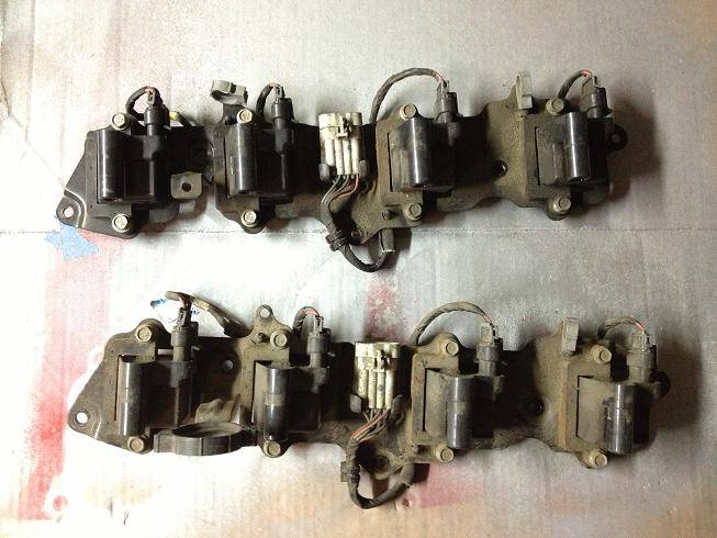

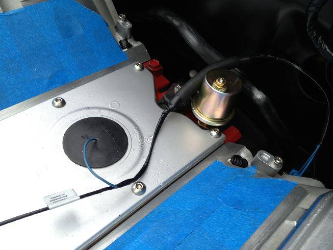

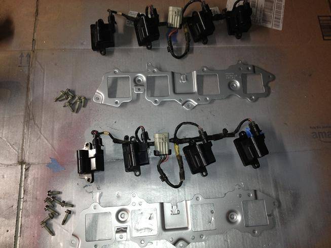

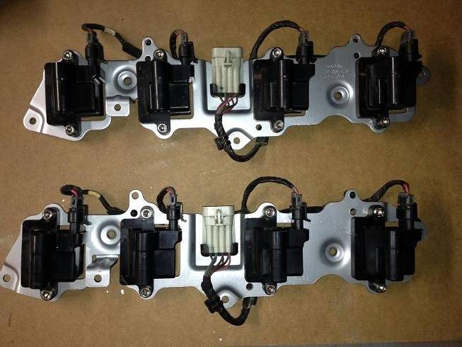

      I think I mentioned that I was cleaning up my coil packs and re-painting the bracket a while back, so here are some pics. I cleaned the coils with a dry nylon brush, then went back with a damp towel, and a final cleaning with a cloth with brake cleaner on it. Then I cleaned up the brackets, cleaned them with brake cleaner and then prep spray and hit them with a coat of primer and a couple coats of aluminum colored paint to match the valve covers. I added some new hex head bolts (I'm using them in several locations on the engine), and reassembled them. Eventually I'll hide the coils, but this will do for now.
      Before:
      Cleaned and Painted:
      Re-assembled:

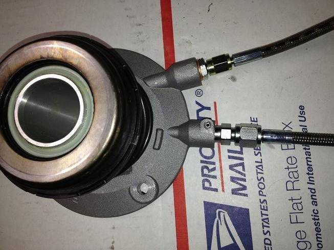

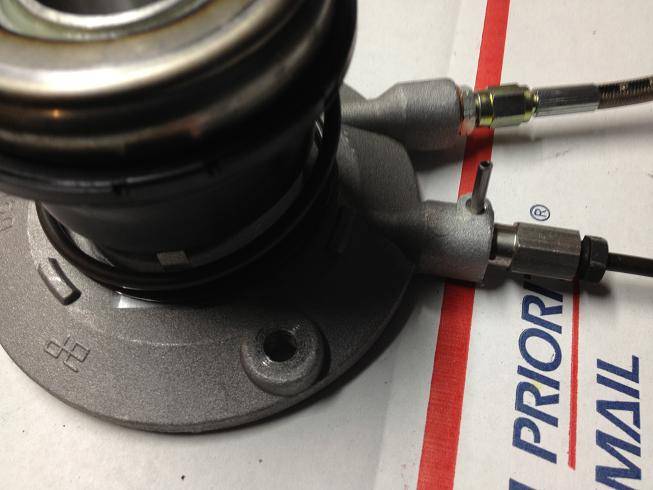

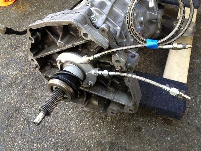

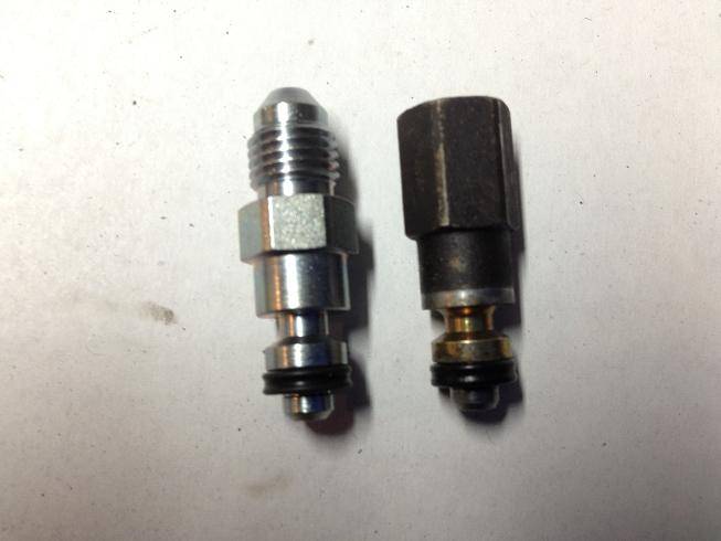

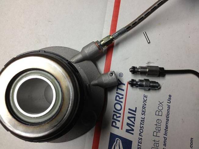

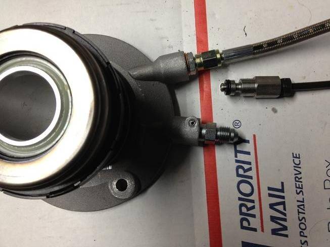

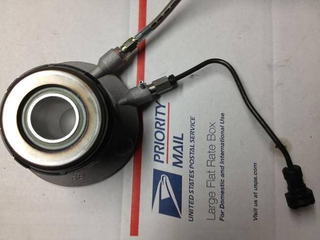

      Both fittings arrived for my slave cylinder. I ended up going with the Russell fitting direct to the slave and then -4AN hose to a -4AN union.
      Tick Performance Speed Bleeder on top, and -4AN connection on bottom:

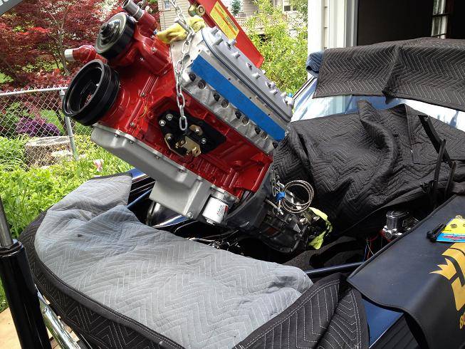

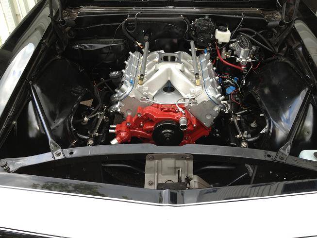

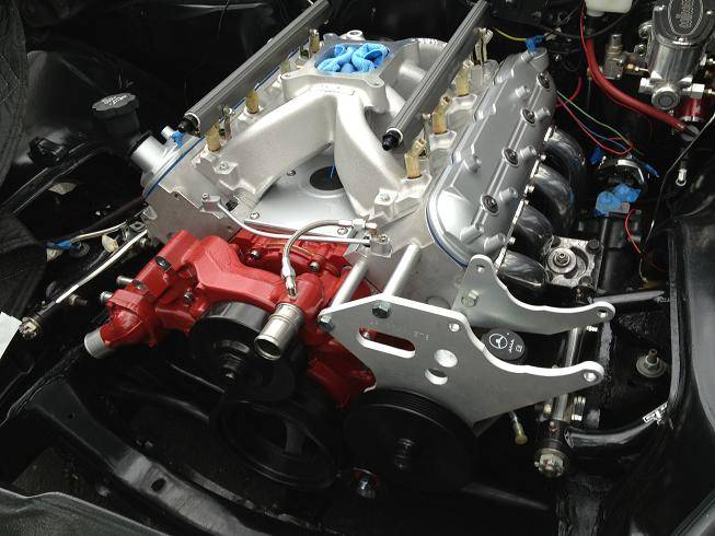

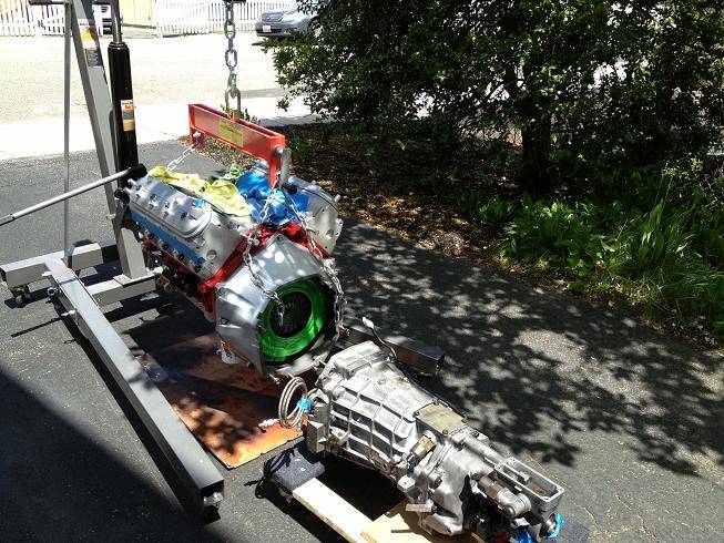

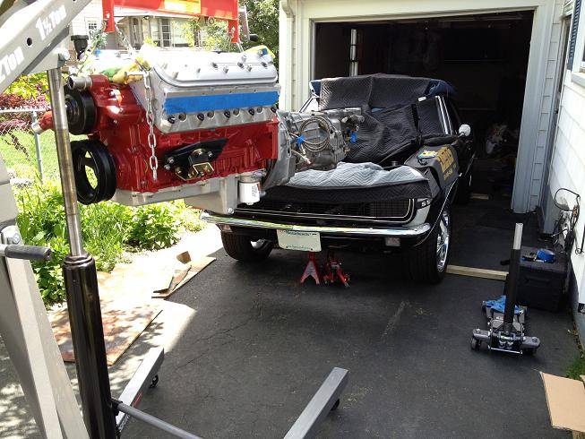

      Which meant it was finally time. I'll let the pics do the talking for once...

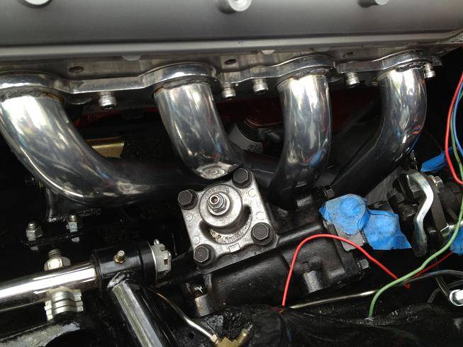

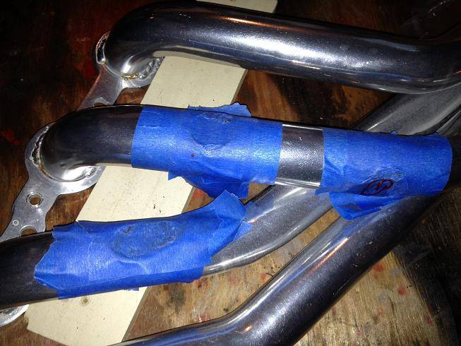

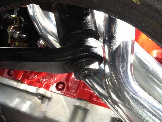

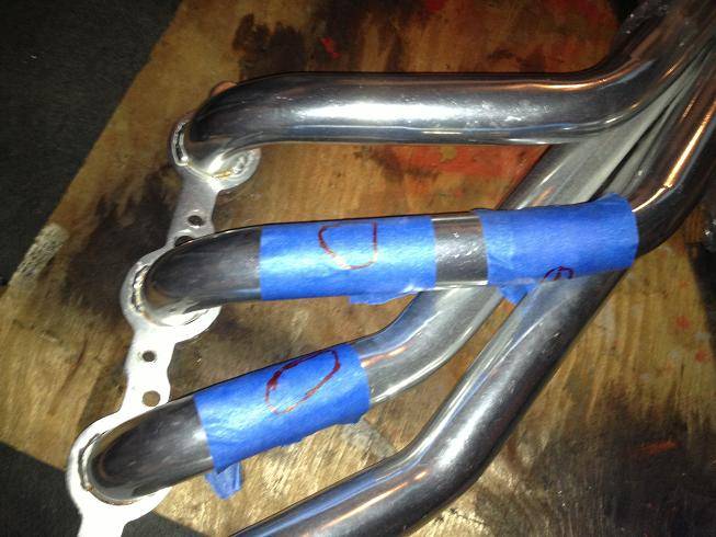

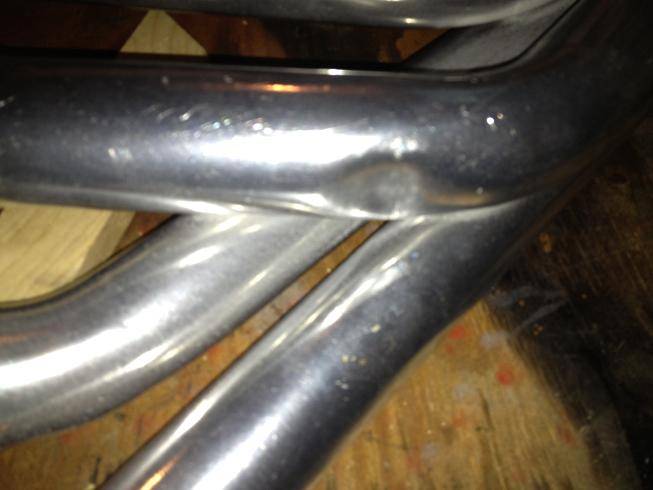

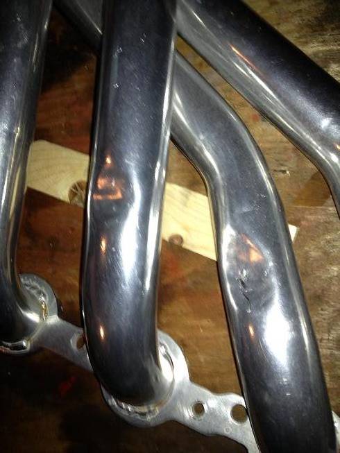

      eBay headers needed a little convincing. When these things rust out, I'll buy some decent headers. They hit in three places.:sad:
      Like a glove:
      And finally...

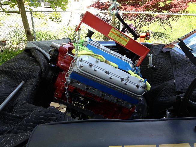

      I forgot to mention two things. First is that I had the driver's side motor mount upside down, as you can see in the pics where the engine is still on the hoist. And second is that I ended up using the pre-load plate that Energy Suspension provides. My oil pan was either touching the front subframe crossmember or it was less than a paper width from it, so I used the pre-load plates as a 1/4" spacer. They also bought me some room for the headers (that still needed clearancing).
      Here's a pic of the #7 tube in relation to the Pitman arm. As you can see, if I slide the motor forward at all it will hit:

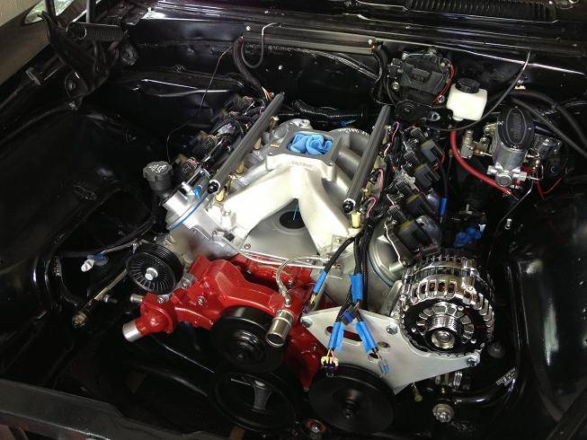

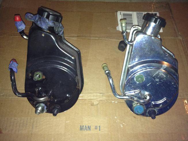

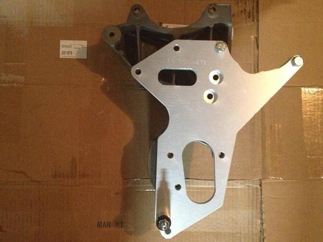

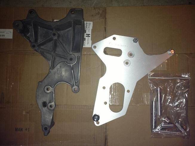

      I got some more work done last night. I worked on the accessories. I couldn't stand the stock LQ9 power steering/alt bracket. It stuck the alternator way too high, so I'm using a bracket from LSBrackets.com. This retains the stock PS pump location but moves the alternator to the Corvette location. It comes with all the aluminum brackets, spacers, idler pulley bolts, and fit perfectly.
      LQ9 bracket on left vs LSBrackets on right:
      And here's the new bracket on top of the old one for comparison:
      I also picked up a new PS pump from a 6.0 Silverado since it was shiny (LQ9 on left, Silverado on Right):

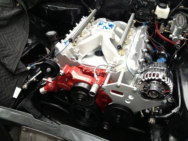

      Here's the bracket mocked up, PS pump and pulley in place and below the PS pulley you can see the new idler pulley:
      The new tensioner is installed (in front of passenger side head), and the car wouldn't be complete without a shiny chrome alternator:

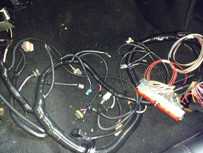

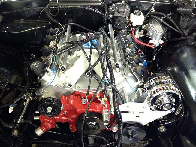

      And here's what I started on my lunch hour(s) today:
      This would have gone quicker with someone pulling the wires from the engine bay side, while I fed them through the firewall. Instead I went back and forth a dozen times to get to this point (I also mounted the coils and coil brackets):
      At this point I have about half of the wires hooked up in the engine bay. I will probably have to cut the harness open to re-route some of the sensor wires that go to the throttle body. Those are the wires up front with blue tape on them. Normally the TB would be located directly above the water pump, but because I'm using a 4 barrel TB mounted on top of the Vic Jr., the wires may not reach, and even if they do, they will not look very clean. I just need to remove the electrical tape on the loom, and pull a few of the wires back so they pop out closer to the firewall, then re-tape the loom.

      Quote Originally Posted by 67rally View Post
      Like a glove:
      I feel your pain. Getting headers to fit between the steering box and block has been a source of constant pain for me. I finally found a pair a semi-shorty headers about a year ago that fit fairly well, but still needed just a little convincing.
      Overall your build looks like it's going great! And considerably faster than mine. Good job! The wiring harness looks like a solid piece of hardware too.

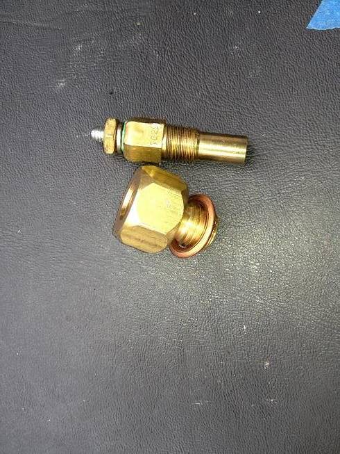

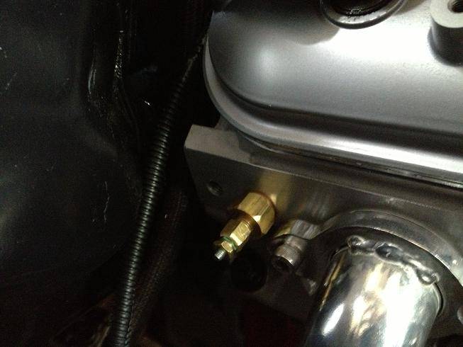

      I've been plugging away (pun intended) at the wiring this week, but haven't had much time. I did have to cut the harness open to move the IAT, IAC, MAP and TPS sensors to the rear/passenger side of the engine, and deleted my MAF sensor altogether since I won't be running it with the Vic Jr.
      I also need to use my old oil pressure and coolant temp sensor for the gauges. The new coolant sensor in the front of the driver's side head that plugs into the harness will just send info to the PCM (ECU), so I'm actually running two coolant sensors. The coolant sensor for the gauges is in the rear of the passenger side head. Anyways, I ordered some adapters from NVU to go from 1/8"NPT to M12 (coolant) and M16 (oil pressure), since I'm running their gauges.
      Coolant temp sensor for gauges with M12 adapter:
      Installed:
      Oil pressure sensor installed:

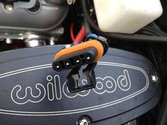

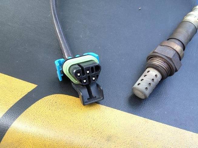

      I also found out I can't re-use my LQ9 Oxygen (O2) sensors that screw into the headers. The harness is set up for a 4 wire flat connector and the LQ9 has a 3 wire triangular connector. No big deal, except new sensors are $60 each. I also need to pick up a couple of O2 sensor harness extenders since the sensors are about 8" too far away. Another $20 each. Luckily I know someone who might have a spare set of the right O2 sensors I can pick up for half price.
      LQ9 O2 sensor and plug:
      Here's the plug on the PSI harness (uses GM# 25312184 / Delco# AFS75):

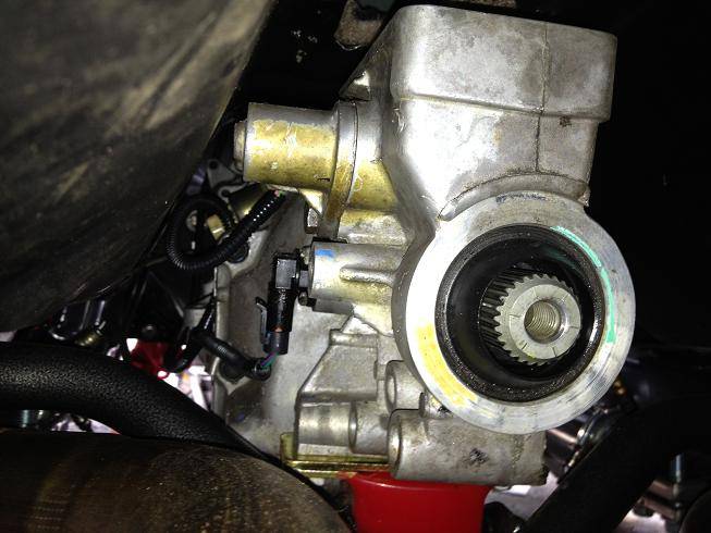

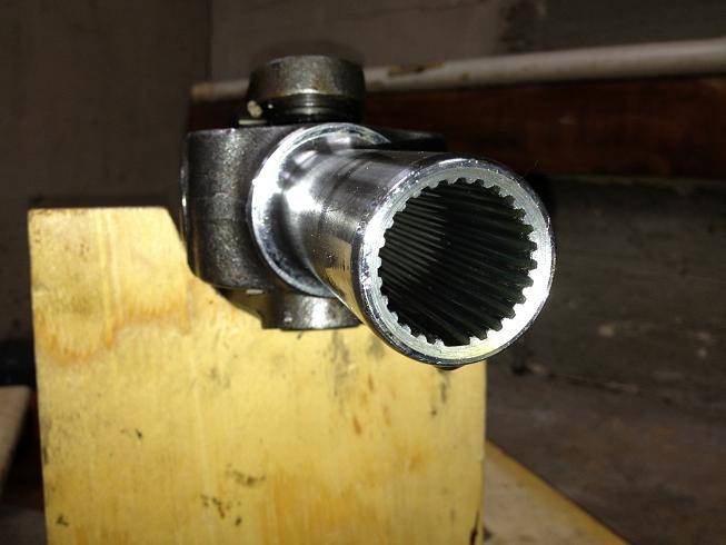

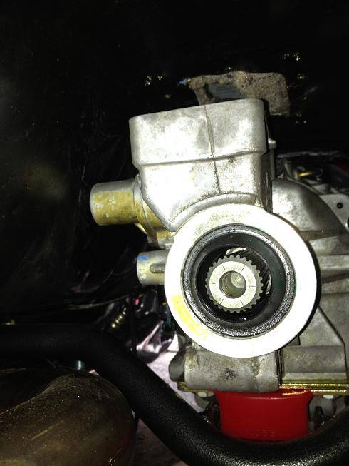

      I hit a roadblock in the build today. I spent two hours under the car trying to install my old drive shaft so I could measure to have it shortened. This driveshaft has less than 1000 miles and no real abuse on it. It was mated to a Saginaw tranny which is a 27 spline output shaft. The T56 came out of a running/driving GTO and also has a 27 spline output shaft. From everything I read the two use the same slip yoke.
      I couldn't even get the driveshaft to start sliding in. I had cleaned both parts thoroughly with brake cleaner and then lubed them up and got nowhere. I took pics of the output shaft and of the slip yoke and they both look clean. No obvious dings or twisted splines. I ran out of time today, so I'll get back under there tomorrow and see if the tail shaft bushing is a different size in the T56 vs the outer diameter of the yoke. I'm open to any words of wisdom here, apart from "did you try it when it was out of the car?" The answer to that is a resounding no.:sad:
