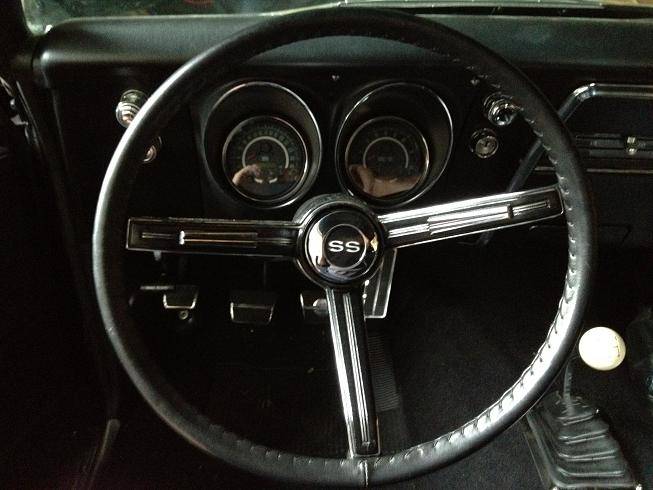

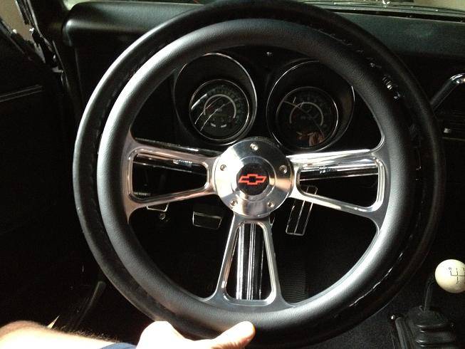

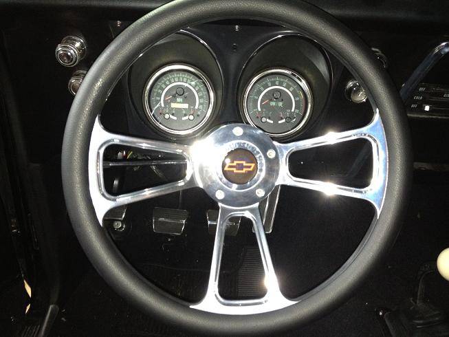

      I installed the new steering wheel today. I really liked my old one, but it was way too big...like driving a school bus. It was also out of round by quite a bit.
      I may have skimmed over the instructions and missed a key step and had to take everything apart a few times. I figured this would take an hour and somehow it turned into 3. Time for a beer.
      Before 15 1/2":
      After 14":
      A comparison of the two:

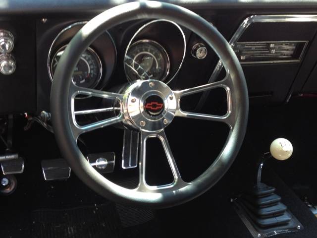

      Here's another view of the the steering wheel and gauges:

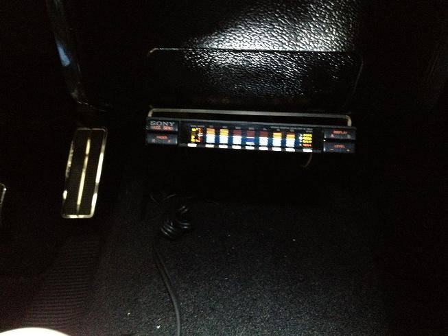

      The radio I want still won't be available until the end of the summer, so I think I'm going to wire up an old EQ that I have lying around and hook my iPod up to that. It's actually a nice digital EQ with one set of RCA inputs and 3 sets of outputs for front, rear and subwoofer channels.
      I just need to connect the amps to a heavy duty fuse and then connect that to the battery, then run power and ground to the EQ and hook up the remote turn on leads for the EQ and all three amps. I'll use a Y connector for the iPod with a mini jack (head phone jack) on one end and a pair of RCA jacks on the other end. Connect that directly to the EQ, and I should have a working stereo for the time being.

      I made good progress! I got the Sony EQ wired up to the amps and can use my iPod or iPhone for music till the Model 2 is ready. The EQ allows me to fade front to rear, and left to right. It also has a couple of crossover points and 4 programmable EQ curves, plus 3 presets. I have 3 sets of RCA's on the back each going to a different amp. This EQ is just a temporary setup, but it fits the bill. I made a quick bracket out of a piece of aluminum I had lying around, and used the screws that hold the bezel to the dash to mount it, so I didn't have to drill any new holes in the dash.

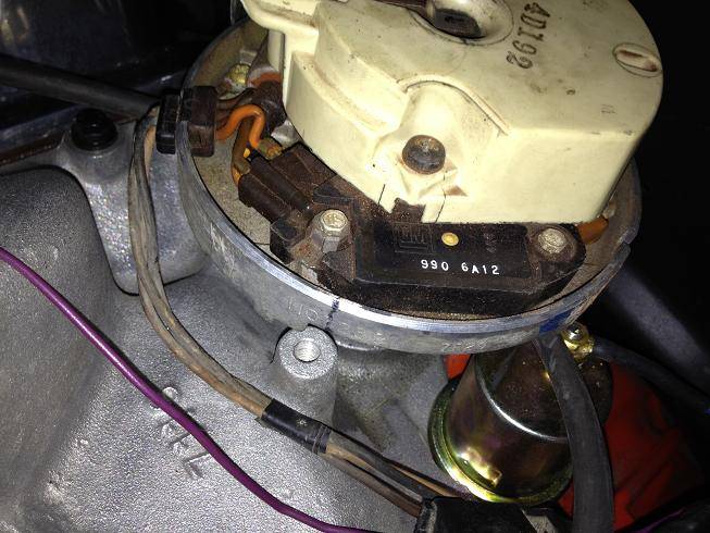

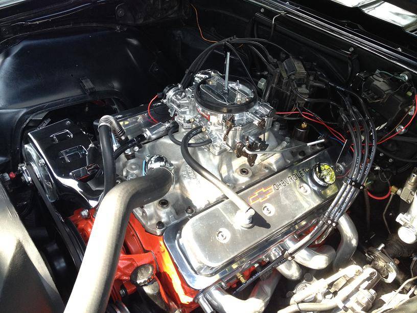

      I've gotten back to working on the Camaro. I'm still on limited duty, but I can wrench a little. I have been trying to troubleshoot an issue that I didn't really even know I had.
      The Camaro runs very strong in the low to mid RPM's, but it falls on it's face above 4000rpm. I started a thread here: http://www.camaros.net/forums/showthread.php?t=211544. I never knew I wasn't hitting the higher rpms because I didn't have a tach until I installed the new gauges.
      I have been playing with the timing and trying to tune the carb and it hasn't taken care of the high rpms problems. I installed a new Edelbrock 1806 650cfm carb with adjustable secondaries, and it woke up the bottom to mid-range even more, but still didn't resolve the top end. I just installed a new set of Taylor 8mm spark plug wires, but that didn't help.
      New carb and plug wires:

      I mapped out the distributor curve and I'm getting 17 degrees of advance, all in by 2750. Here's the curve:
      1000rpm - 17.1 degrees
      1250rpm - 20
      1500rpm - 22.5
      1750rpm - 24.6
      2000rpm - 26.6
      2250rpm - 28.7
      2500rpm - 30.9
      2750rpm - 32 degrees
      3000rpm - 32
      3250rpm - 32

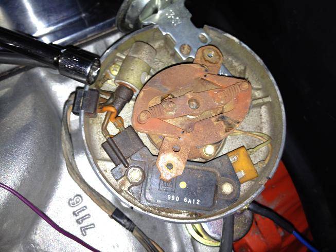

      The dizzy is a stock Delco-Remy HEI and it's pretty crusty inside. I'm not sure if this is my issue, but I have adjusted my initial from 8 degrees all the way to 20 degrees in 1 and 2 degree increments. I have tried running with no vacuum advance, and with vacuum advance from 6 degrees to 16 degrees. I have tried the vacuum advance on the ported and the manifold side.
      I could rebuild this one, but I would end up replacing the coil, module, springs, weights, etc., and to be honest I think there is probably too much end play, and that could be the root of the problems. I decided it was time to order an new dizzy, so I contacted Davis Unified Ignition (http://www.performancedistributors.com/) and they are building one with a custom curve designed for my engine specs. That should be here in the next couple of days and we'll see if that resolves the problem.
      Here's the inside of the old HEI:
