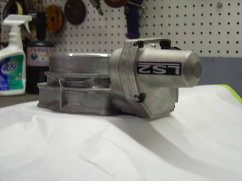

      Scot, I have one from a 2005 GTO. Came on the engine I used in the Elky. 11,000 mile engine. Got the whole topend. heads, intake, TB, cam, etc. I also don't know what the value would be but I would trust whatever Mike Norris says is fair. Tis your's if you need it.

      It is pretty much in new condition. I'll be in the shop in the AM and I'll pull it out and take a pic. Give Mike a call and ask him for a fair price. He would know. I'm easy. If you got it and were not happy I'd take it back.

      Nah, I'm retired. The Elky is the one in my avatar that I beat on all year. It is getting a Tick master upgrade and I'm starting my complete "go over" to be sure it will be ready for the drive and flog it will get at the Run to the Alamo in Feb. Here are pics of the TB. Like I said, it has 11,000 street miles. Should be perfect. Mike
