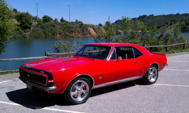

      I totaly get that. On my 67 Camaro I'm running a Hotchkis TVS System(minus the rear sway), with the addition of Speedtech Upper & Lower Control Arms. It handles awesome to say the least.

      Here's a pic of my car...
