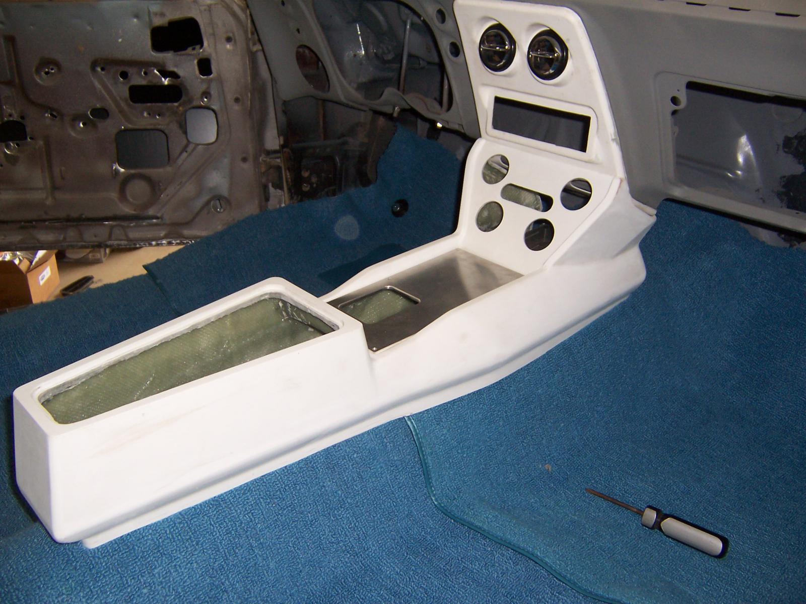

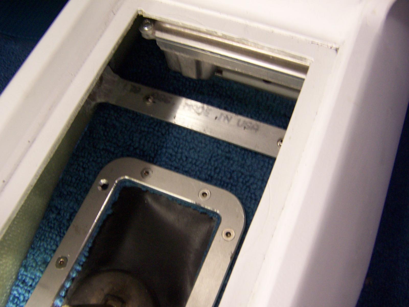

      I put my ECM under the console that I made. I modified a '02 Camaro harness.I need to extend the reluctor sensor lead and 1 other. I ran the harnes through a hole in the firewall, just above the passenger side head.

      Looks good. I was talking with haveaseat2 on ebay about the harnesses he modifies. He told me the truck harnesses are slightly longer. He didn't think either would reach inside.
