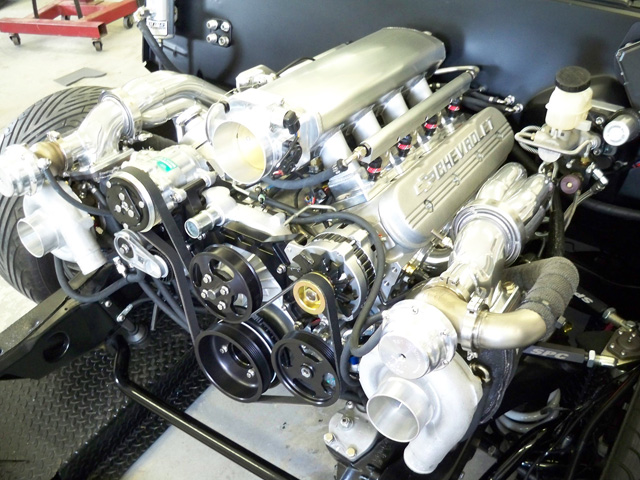

      this was in a 64 Chevelle, but would have fit a first gen Camaro also. I used the Vintage air system, worked great.
Size:  119.6 KBName:  malitude 767.jpg
Size:  181.0 KBName:  100_0790r.jpg
      Jan 2011
      Ocean Springs, MS
      84
      Wow that looks great! I tried to find some info on the site but I only saw some WILD pics! LOL Are those 1-off headers you used or off the shelf items?What is the turbo and blow off valve combo? Also, I haven't seen to many inverted turbo setups. Did you have any issues w/ oil drain back to the pan since they're inverted? BTW, Thanks for the response. This is exactly what I was looking for!

      those headers came from Tom Nelson racing. The turbos are Precision 6776RE liquid cooled ball bearing turbos, the wastegates are Tial 38mm I think. Blowoff was a single 44mm Tial. Turbos can be clocked 360 degrees, so I have the inlets clocked to what fit best for the car and air filters I used, and in the center section the oil drain is still the normal in at the top, drain out the bottom like any other turbo.

      Jody, Thanks for the info! This gives me some direction and some insight to getting my setup done. Hopefully I'll have something working in a few!

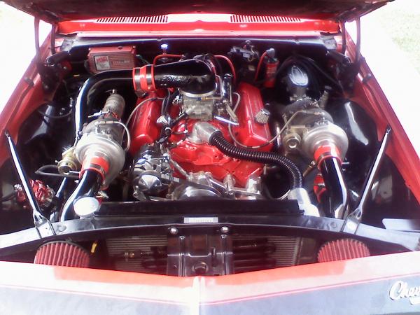

      My turbo setup isn't as high qaulity as the one posted here on the chevelle but I could run a low mount ac compressor on mine if I wanted to. I just haven't had the funds for AC yet. I have plenty of room low.Name:  engine.jpg
      David Butler
      "If you're not first, you're last"
      67 Camaro Twin Turbo SBC (changing from Blow-thru to Holley HP EFI)
      I like it. Very neat and detailed. Tough to get twin turbos to look clean, there's a lot going on. You did a very nice job.

      Looks great! What hydroboost/master setup is that?
      WWW.SPEEDINC.COM 1957 Eldorado Brougham.......in progress
      Aug 2001
      Wilton, CA. (Sacramento)
      2,995
      Quote Originally Posted by INTMD8 View Post
      Paul at Hydratech custom made that one for me. His booster with a Viper master. That master is shorter than the normal ones he uses and gave me the extra room I needed for exhaust clearance.
