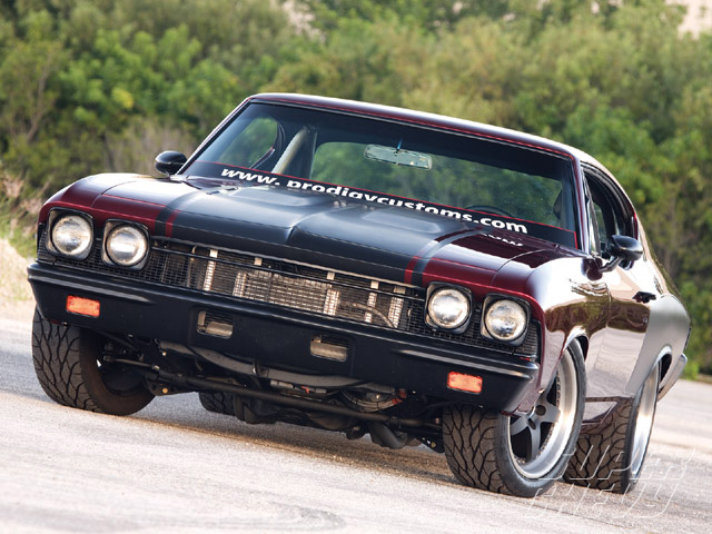

      So I love the look of the shaved drip rail...want to do on my 70!
      But... Is that a bad idea if the car will see rain?
Size:  41.6 KBName:  sucp_0911_10+1968_chevy_chevelle+headlights.jpg

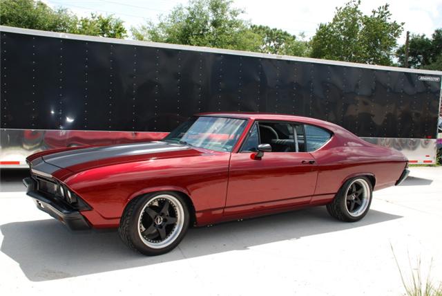

      Here is another great looking one...
      I also see it has the flush mount glass and the rear edge of the hood has been cleaned up to be perfect without the molding. Nice touch!

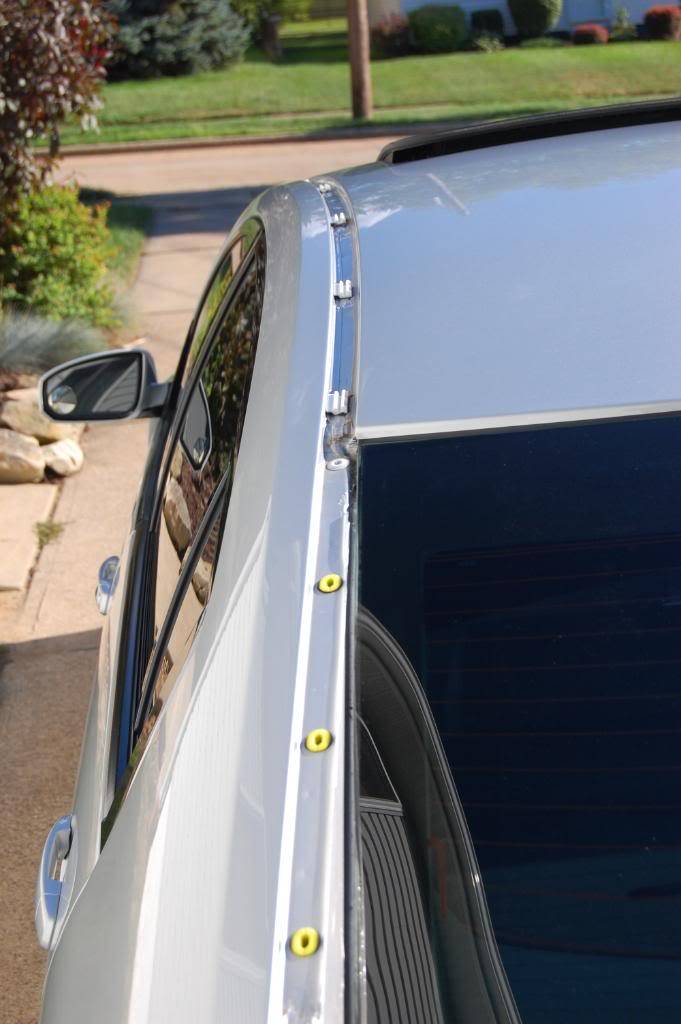

      An alternate method is to weld a shallow channel into the roof skin. This gives the shaved look, but also keep the water out of your lap when you open the door.
      For instance...(not a great pic, but you get the idea)
