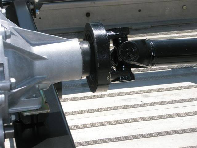

      We are currently working on a standalone controller for these transmissions but they're not as ideal as most people think unfortunately. This trans won't live very long without some type of torque management and the biggest drawback is the size. It is significantly larger than the 4L80E trans, especially if you look at the centerline of the output shaft to the bottom of the pan. It may cause issues with tunnel clearance but also driveline angle more than anything. By the time you raise the trans enough to get ground clearance the driveline angle is pretty extreme. I could be wrong or there could be a version that I haven't seen but the ones we've been working with aren't very rodder friendly.

      Both transmissions have pan to ground clearance issue when installed in older cars, and you'll want to look into a GTO 6L80 pan for the 6L80 to get a little more ground clearance. 6L90E does not have a shallow pan, so most modify the GTO 6L80 pan when installing one. Most likely you want be slamming your car with one.
