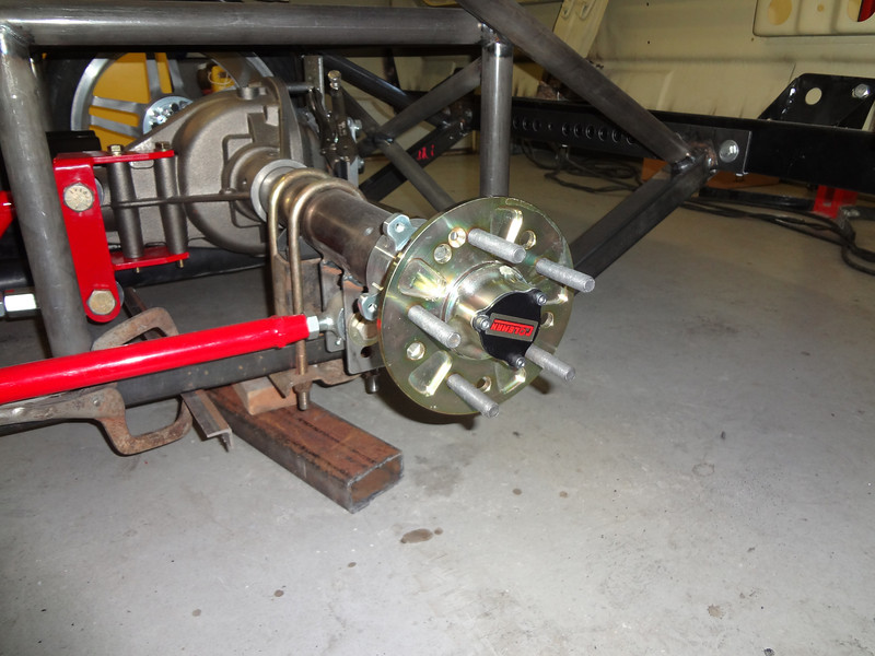

      Looks like he is trying to work in a front differential now guys. AWD AMX, just throwing it out there.
      In all seriousness, this is going to be great.
      Haven't really had time to work on this thing(been thrashing on the Mustang), but I did get the front 335's on. I'm really diggin it.

      I use the Coleman drive plates with 1/2" studs and a 5*4.5 bolt pattern. THey are from their mod-lite package. Part # is 21634
      If you have a different bolt pattern it will be a different plate, but just call them they can figure it out. My version has been lightened a bit too but not as much as that moser version. Also I am using a steel plate, not sure if you were using aluminum or not. You're obviously not worried about weight with that Dana60 in there

      I followed your build on Lateral G, really liked what you did. Straight forward, simple, and durable, I'll bet that car works really well. The bad part about all this extreme stuff is, alot of times your in uncharted territory and you really have mess with the car to get it to work. Hell, I'm still working on the Mustang tune trying to get it to autox the way I want.
      Thanks, I hope it works out well. I am trying to keep it simple, but I always find something I don't like or want to redo already, lol. Like, I really want to put a cage in the car but, to be safe on the street the seat will be to low for me to see over the dash, plus it doesn't play well with the stock dash and headliner.
      I like the coleman drive plates, hopefully they make them for the 5x5 grand national hubs I have, with 1/2 holes.
