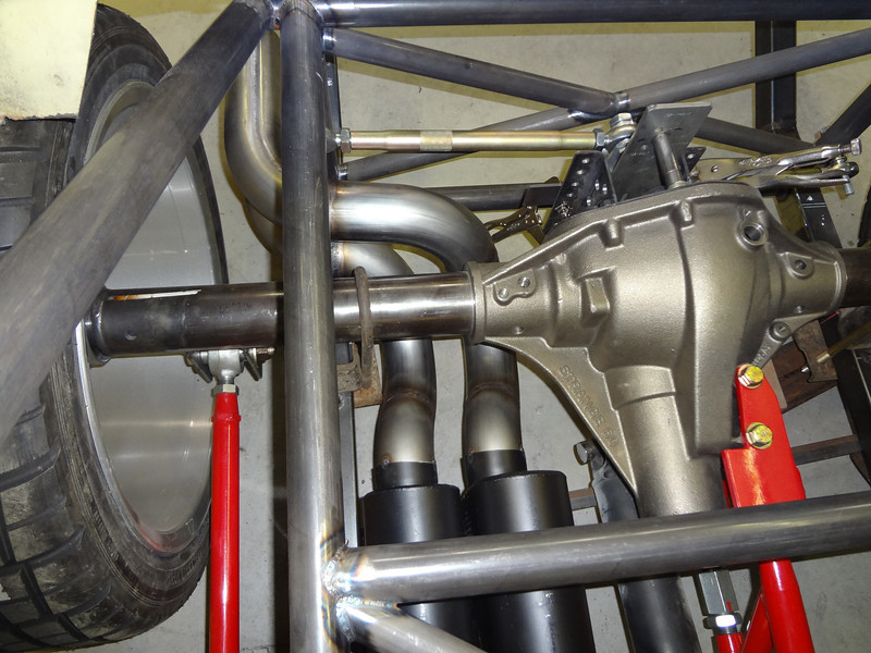

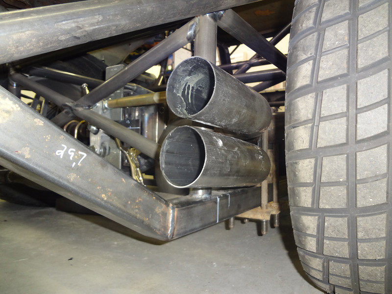

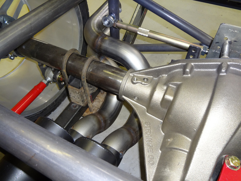

      Worked on the tail pipes today, look just like Harley pipes. Turned out great, I think Frank had his doubts. Can't install tips until I make the quarters built.

      Nice Ron! I bet it's going to sound like a beast!

      Looking good!!!! It's going to be fun to pull the rear out now lol.

      That exhaust is going to look like an over&under shotgun coming out the back, just super sized! Lovin' this, keep up the great work.

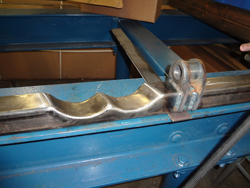

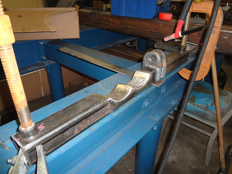

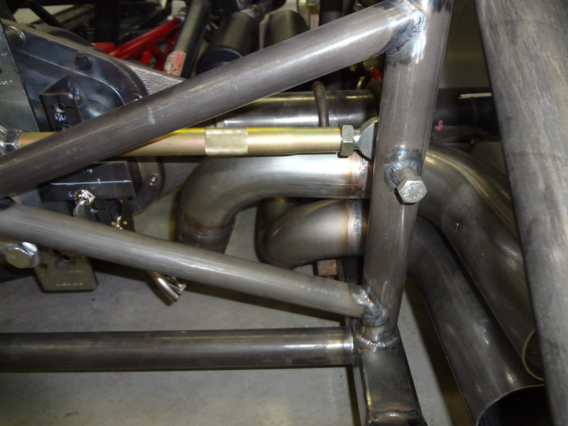

      Got the torque arm crossmember built, exhaust eyebrows were a pain but its done. On the fab tech side, if you place a peice of flat bar under the welded area, and clamp it down while welding it helps to keep the part from ending up shaped like a banana.

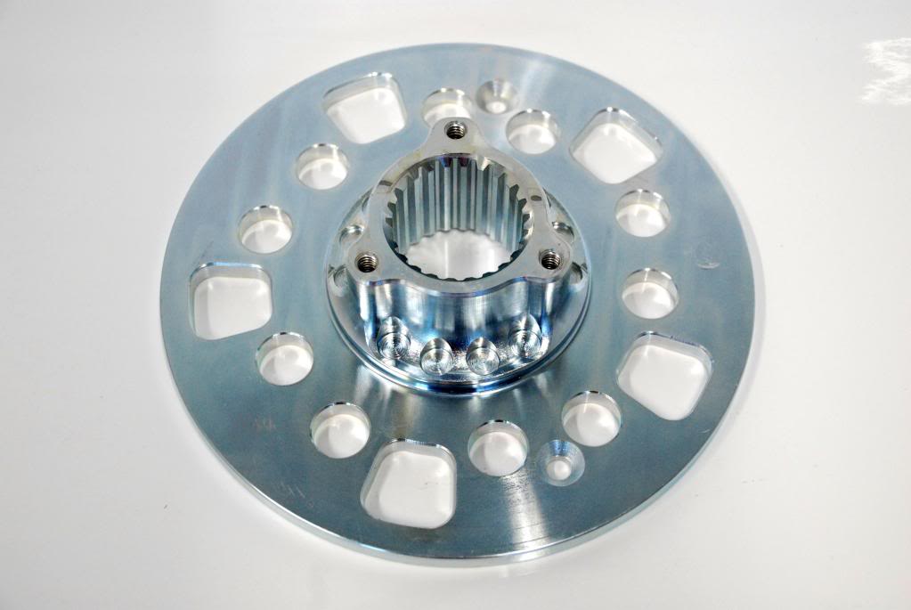

      Thanks Ray, the one thing I love about this site is how everyone trys to watch out for one another. I was actually was talking to Coleman, and Mike Holleman who runs that setup this week. Colemans website isn't the greatest as far as pictures go, I found this pic in a Google search.
      I'm agonizing on what to do with my Mustang for a floater. Love the Dana thats in the car,the only part on the car I know I'll never have to touch.
      Can't deside wether to lop the ends of the Dana and make it a floater, or switch to a 9" floater. While running a 4 speed with direct drive fourth, I really need a higher rear gear, and I am as high as a Dana will allow 3.54, I'd like to run a 3.20ish gear which is no problem with the 9"rears. Like the Moser DBP setup which is similar to GMR with its bearing seperation, it just doesn't use as big a bearing, and I do hate the driveplates. This is messed up, I think I'm getting my threads mixed up. LOL

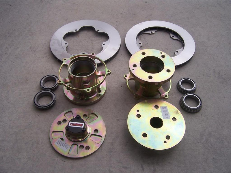

      That's not exactly the plate I was referring to... Although, it's very close. I'm sure Coleman makes a number of different varieties.
      Here's a picture I found of the one I was describing. As you can see, Speedway Motors sells the same drive plate. I'm sure Coleman makes them for a number of companies to their specs. It's just like other products where a lot of different companies sell something but they are actually produced by one or two companies... Like the old VCR's...
      At least these have the correct 1/2" holes instead of the 5/8" holes in the Moser units. I asked Moser if I could get a custom set ordered with 1/2" hole in them and he told me they weren't really interested in catering to the Pro-Touring market.. They were a race car product company... In today's times, I don't think I would be pushing business away. I'd be looking for ways to increase different market niches...
      You see how much beefier it is around the 24-spline axle and hasn't been lightened like the Moser one...
      My asphalt circle track buddy said if they were to break from some shock load, they crack in one of these areas that have been lightened. I know we will give these things much less abuse than the racers but it may be an alternative for you... The two countersunk holes for the set screws should be located correctly but probably wouldn't be a big deal to make some new ones if you had to...

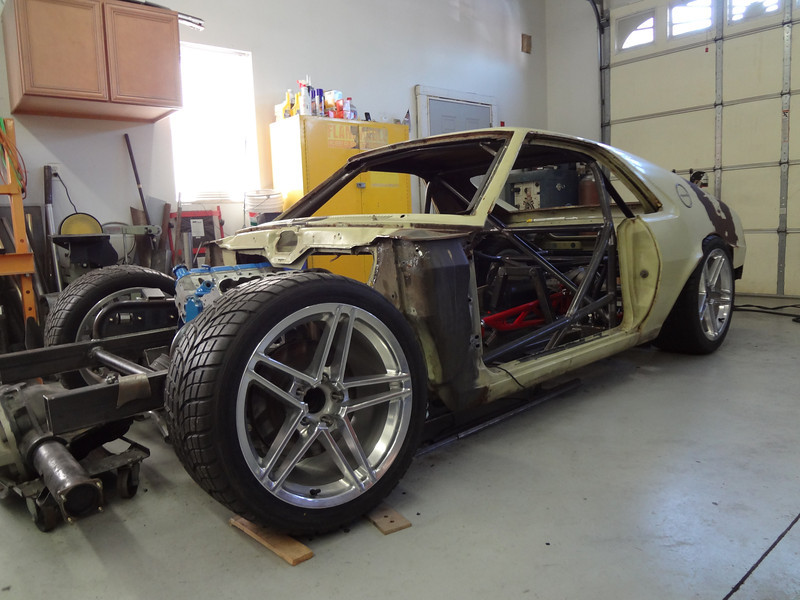

      Haven't really had time to work on this thing(been thrashing on the Mustang), but I did get the front 335's on. I'm really diggin it.
