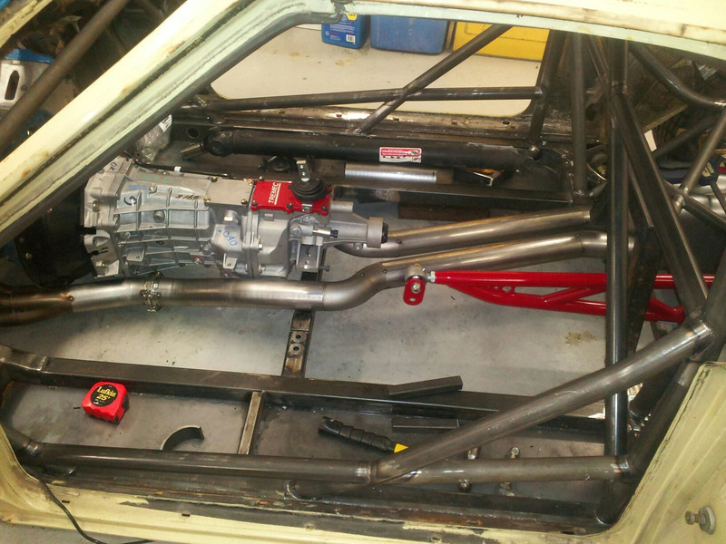

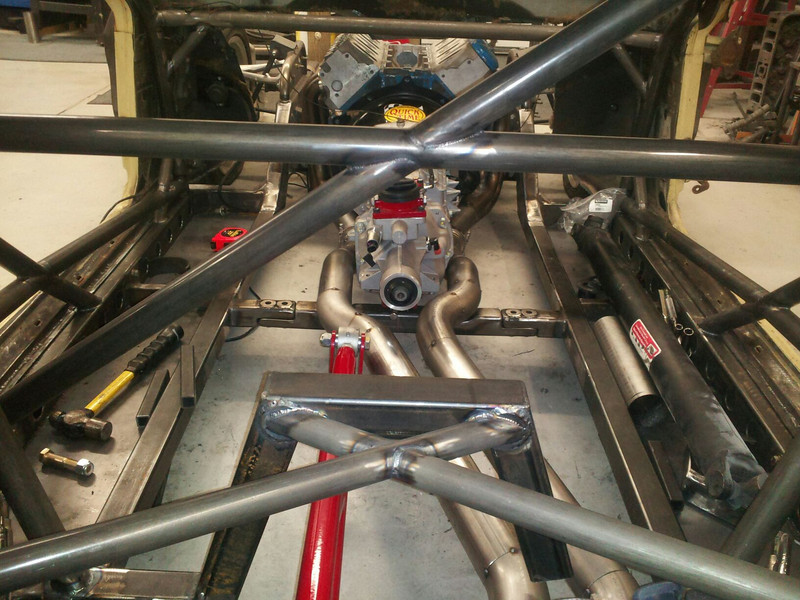

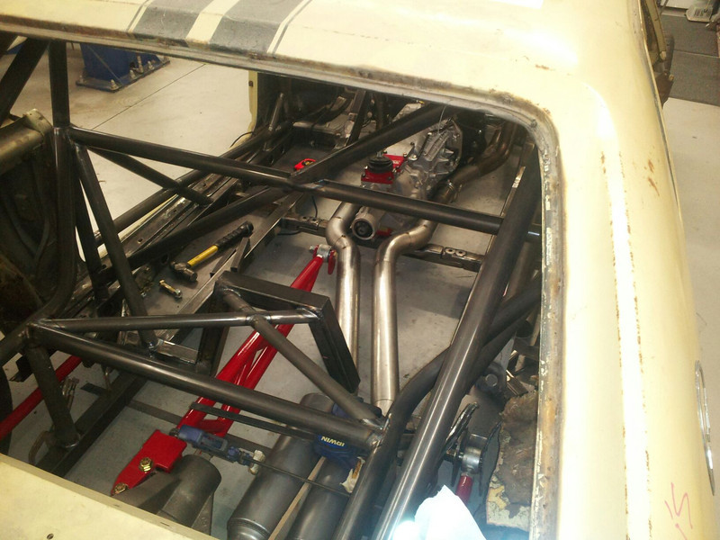

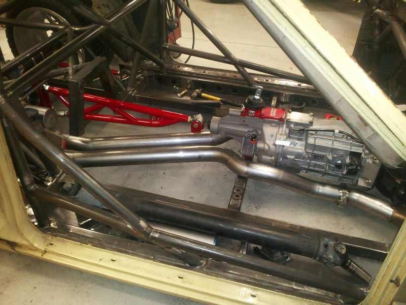

      I have built alot of cars through the years, but I have NEVER been so tortured trying to get exhaust to fit. I had a choice to make, the car could either have exhaust or seats. The torque arm eats up so much realestate that it makes it damn near impossible to have exhaust. Frank and I contemplated about 10 different designs, we even thought about a single 4" exhaust set up. In the end I cut a chunk of the frame and tucked the pipes under the driveshaft down the right side side, standing both mufflers on end, leaving just enough room for seats, and everything else. The tailpipes will go under the rear, and exit behid the passenger rear tire. Frank was hurried to get some pipes in before one of us changed our minds.

      getting structure back to the torque arm chassis mount looks fun!
      Are you going to have any issues with sounds levels at autocrosses? If so design in a way to point the exhaust exit away from the DB meter. I have turn down under the car and I can angle them to point away from the DB meter. My small motor hit 95 dB at 3500rpm and full throttle.

      That actually gets another 2"x2" crossmember that has the mount on it. Its out to get the exhaust eyebrows put in it, once its installed it will get an X brace out of 1 5/8" chromoly between that and the trans crossmember. When something sets this low, every single part becomes a challenge to install.

      Love the Dart, I'm a Mopar guy at heart. The chassis is around 4.5 inches to the ground, and nothing hangs below that. Although the exhaust was challenging, the pictures don't do it justice. Each pipe has probably has 6 manderal bends in it, and it follows the shape of the transmission perfectly.
