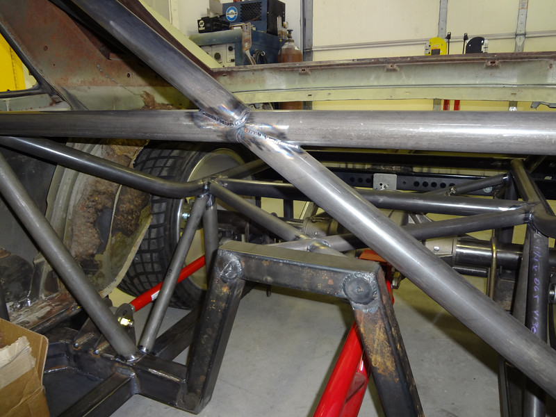

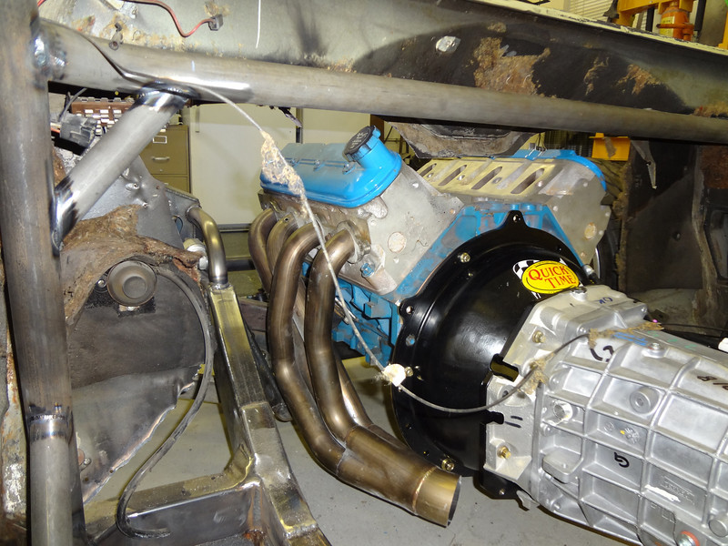

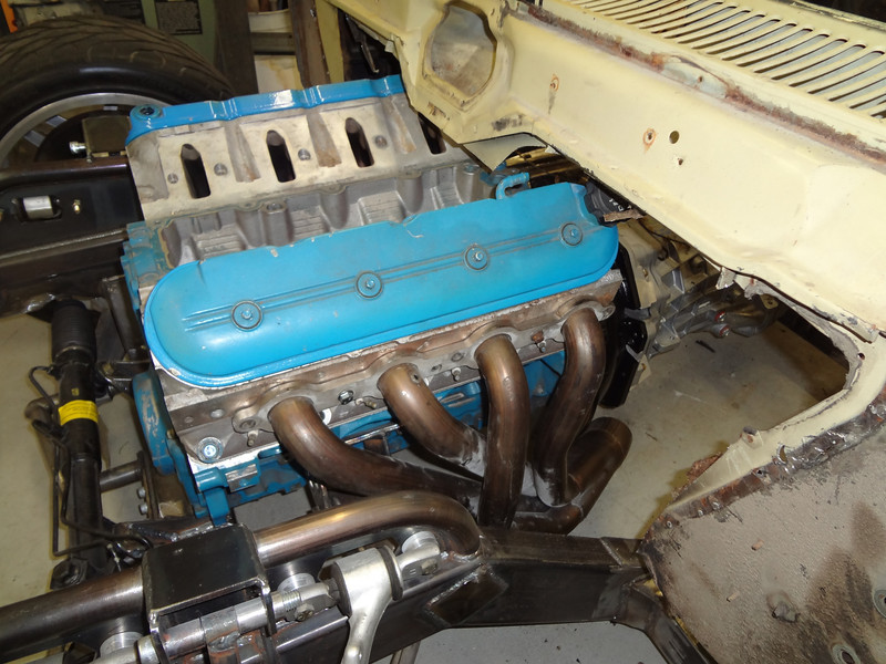

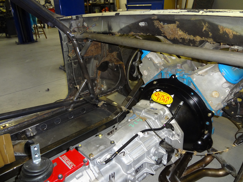

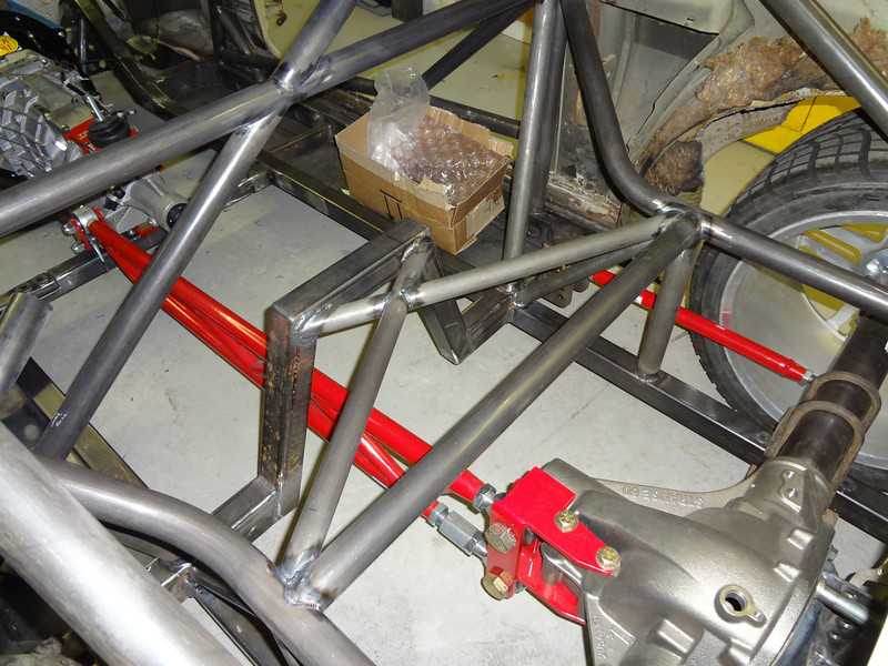

      Got the body back on, and the engine and trans in it for mock up, I think I will have to go with the shorter torque arm, just too busy with that magnum 6 speed. Trying to deside what I'm going to do for power, my buddy Frank is trying to talk me into twin turbos, it really would be cool, but would add alot of weight.

      dont you overcome weight with horsepower?
      what about smaller twins, rear mounted to equal out the weight gain some?
      Michael Crawford
      Oct 2005
      Toronto
      1,465
      Cool but driving it will be a handful because they come on so violently bud.... I'd be inclined to weigh that decision very carefully if you plan to auto-cross this car.....

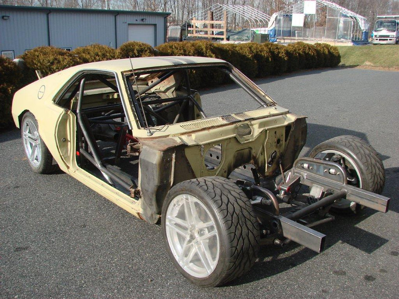

      My buddy Dominic just sent me this, to date my favorite picture ever.
      Ron Schwarz
      Rustburg, Virginia
      3,436
      All it needs is the running gear, a seat, and a steering wheel....then you're all set to go racing.

      The car is looking good. I built an underslung chassis for a 35 Ford pickup a few years back and it really worked out quite well.
      Leave the long torque arm. The longer it is, the less likely it will be to brake hop. I say brake hop but its the violent downshifts that really do it. When that happens, sometimes the only thing you can do is throttle out of it.....kind of the last thing you want to do when you are trying to slow down.
