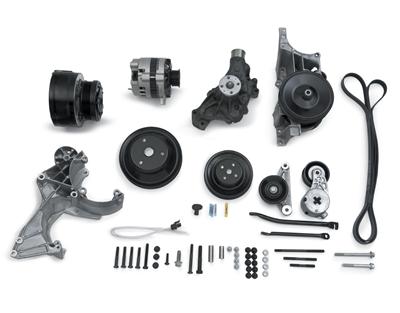

      GMPP sells a complete kit with A/C compressor thats fairly reasonable and its everything you could need... Just a thought... Heres the link.
      Serpentine Kit

      I'd really like a Front Runner but it's kinda spendy. Cheapest I've found for it is about $1500. I've looked at the GM kit but I was hoping to get into a little cheaper for now and the GM kit seems bulky.

      Do you have the room for the longer water pump these kits use? Are you going to use an engine-driven or electric fan?
      1988-92 F-bodies used a serpentine set-up that's easily adapted. Truck stuff would probably be the same parts,too.

      88-92 camaro v8, 88-93 caprice and their GM counterparts use the same basic system as the new GM system you are talking about. I know because I checked some of the bracket part numbers and they match. This system fits very well on a 69 nova.

      I had a '90 K2500 Chevy and the front system would have been a perfect retrofit onto my Chevelle. But when I sold the truck the new owner wanted to keep the WP etc. I am keeping my eye open for one in the local yard.
