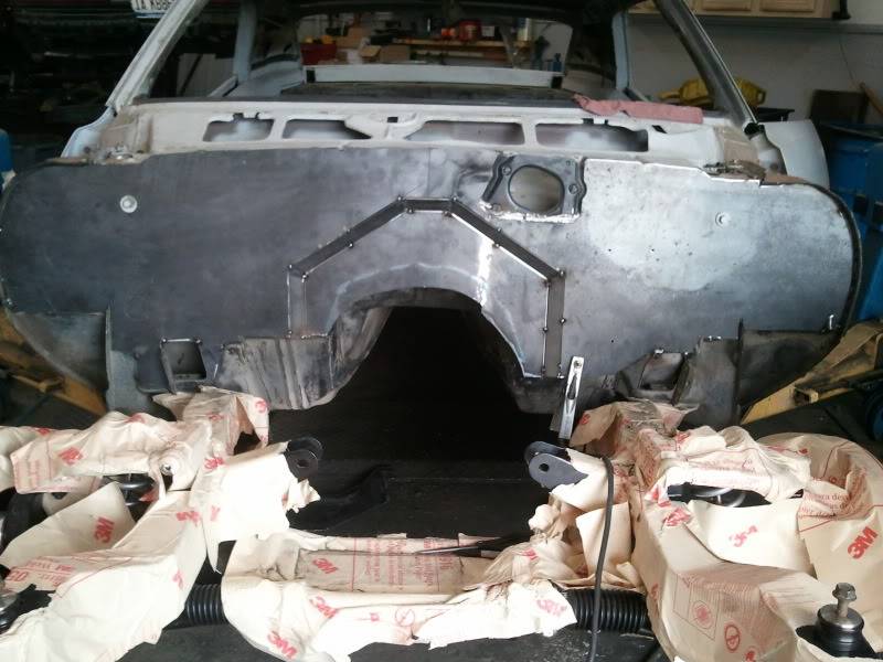

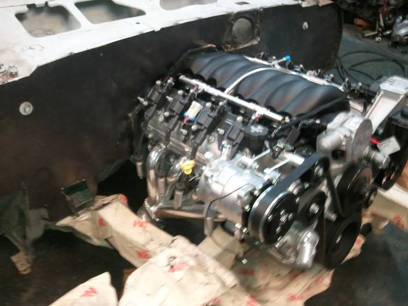

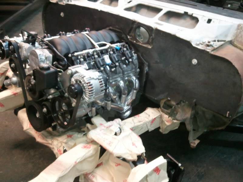

      Im looking for a universal firewall pocket that I can weld into a shaved 69 camaro. I built one for a 57 a while back and didnt like how generic it looked. I have since seen some that were stamped out of 16-18 gauge steel but cant remember where I saw them. This particular car has a ls3 sitting in a chris alston front sub frame with there billet motor mounts and detroit speed sub frame bushings. We have already cut the trans tunnel and plan on raising it an inch. With the motor bolted up the passenger head is 1/4 inch from the firewall and the vacuum port on the back of the intake is almost touching the stock wall. This isnt a "massage it with a hammer" build like they suggested. Sub frame is powder coated so the easiest option is modify the firewall. just trying to source a firewall pocket or brow. Something more rounded then boxy and preferably something stamped the shape of the top of an ls motor and intake. Thanks

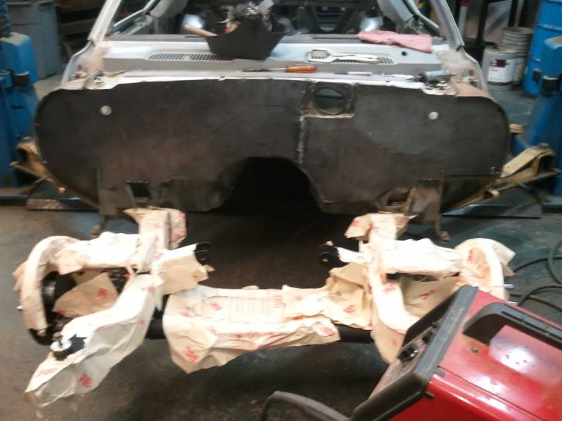

      done- that before, wanted something a little more fit. We couldnt find anything so we made one

      Cool firewall, thats a great fit.
