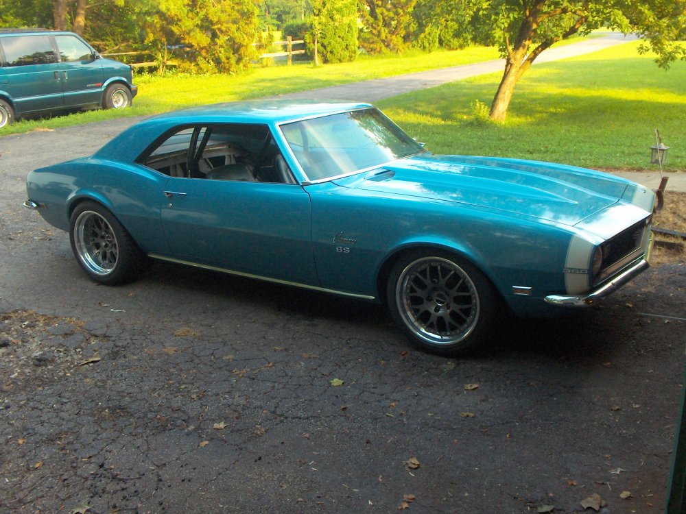

      I recommend you buy your wheels/tires first then order the rear end to fit the wheels the way you want them to fit the car. I have DSE mini-tubs and I'm running 18x12 Forgeline rear wheels with 335 tires. I purchased the wheels and tires first then mocked them up under the car to determine the exact width I needed. I ended up with a 57" wheel mount to wheel mount rear end housing. You can do all the funny measuring but you will likely not end up with as nice a fit as you would buying the wheels/tires first.

      IMO, those 18s are perfect on a 1st gen... Nice car, Steve.
