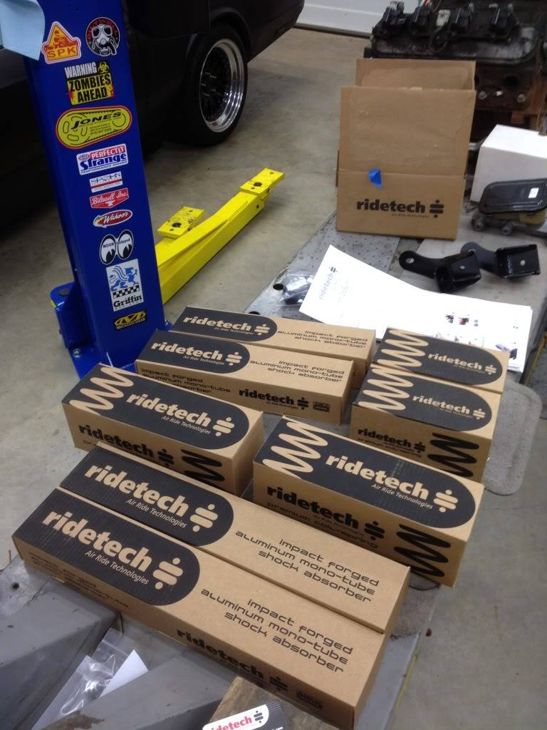

      I am doing the install now, front and rear coil overs. Once I am done I will have a full write up with lots of pictures.
      So far I am very impressed with the quality of the parts...plus they just look bad a$$!!!!
