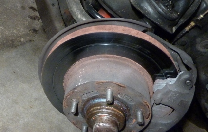

      My car is a 1968 Camaro with power brakes front disc rear drums I am looking for a C5 all wheel brake set up. I read all Pete's note on the subject.
      I know I would need front drum hubs as most kits and C5 rotors can be easily installed on slightly machined drum hubs.
      However in Europe I can build a kit starting from disc hubs, IF I have a separate hub from disc.
      Please looking at my disc can you tell me what kind it is and what hub I have?
      It looks like it is a complete one 'disc on hub' assembled piece.

      It is the complete disc/hub setup. Check this link, it should show you what you need to do.
      http://www.nastyz28.com/forum/showthread.php?t=62360

      X2 on your current setup - intergral hub & rotor.
      That prop valve is not original to your 68 Camaro. Without knowing what it is, I would remove it and install an adjustable prop valve on the rear brake line when you do your 4 wheel disc upgrade.
