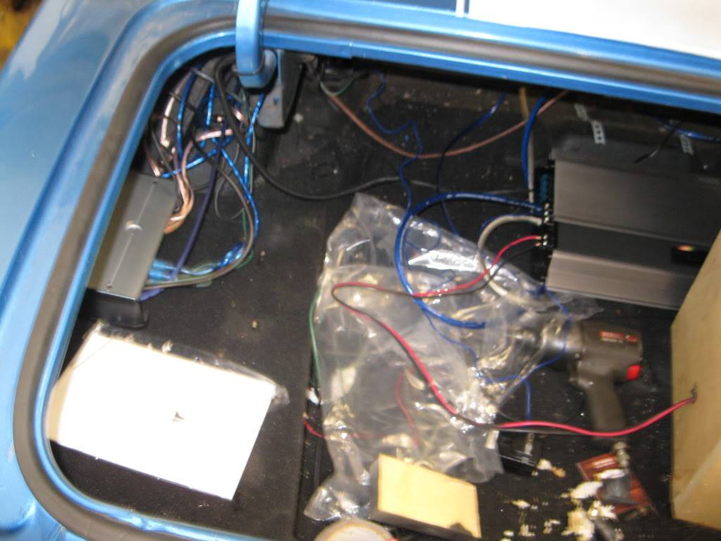

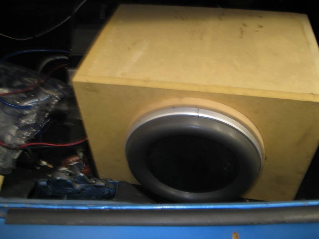

      Hey and first of all I want to thank everybody who chimes in with an opinion on this matter!! So in my 68 camaro I decided that a 10" w6 would handle all my bass that I could desire and even more. So after shopping around I had found my w6 and had my box made for it. But shortly after I got home. I blew the w6. So, if i blew it, I figured I should upgrade. Welcome Jl audio 10"w7 into the family. Now here is the problem. What in the world should I do with it. Should stick this massive box in a corner and build an inclosure around it or would that have drastic issues on my handling since the box and sub together weigh about 60 pounds. Plus I am not a track star, so shaving seconds does not matter to me. For me that is my best idea. Since the 68 camaro engineers decided to put in a slope in the middle of the trunk. and the box is rather bulky. Here is what I have and I cant put it all the way to the edge because I have a Hotchkis shock tower brace installed. and the next and here is the 68 camaros trunk for those who are not familiar P.S I am not looking to upgrade or change subs or anything like this. Thanks for any help/ advice

      Personally I would build a different box. Appears that it is a sealed box, just make sure the interanl volume is correct, shape does not matter.
      Not sure why you need the shock brace in the trunk. I assume you are running leafs? I would pull the shock brace out and build a new box that fits up against the rear seat brace and fire the sub through the rear seat. Mount the amp on the back of the box and build a light weight cover to tidy all of it up. Send me your email address and I will send you pics of the way that I did it...not that my way is the best, but it worked well for me and has the weight in the center of the trunk above the rear axle.
      Roanoke (FortWorth) Texas
      786
      As Payton said. Build a new box that fits the contour of the trunk where you want to put it. With that much bass its not going to matter much if you adhere strictly to the manufacturers box recommendation. Just make sure the woofer fits in the box and it falls within the volume range specified.

      Your sub will have a reccommended volume per the manufacturer. For an example, my sub rec for a sealed inclosure was 1 cubic feet without the sub in the box(gross volume). I could build it 12 inches x 12 inches x 12 inches for a total of 1 cubic foot. If you shorten a side due to the amount of room you have, you will need to lengthen one to keep the volume correct...simple math.

      Your box looks like it is too big for the 10w6, that could be the reason it failed. JL Audio only calls for .625 cu.ft. (sealed)for that speaker. The 10w7 requires 1.25 cu.ft. (sealed) thats a huge difference...twice the amount.
      Yes I have no idea why they made the box so big, I even had it professionally done But hey, I wont go to them anymore. However I think the box is about the right size for a w7. Which I decided to upgrade it too. P.S your pedals look great in my car. Now, time to get the e-brake to work with my kick panal

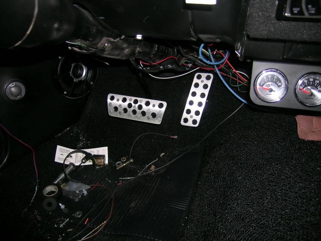

      No Problem Shannon and thanks for making a simple but nice product. Know for the E-Brake Pedal!!!

      Hey Randal, are those kick panels the ones from Screamin Performance?

      Yes Sir, works great too!!! And the speakers are Polk Audio MM Series 6.5"s

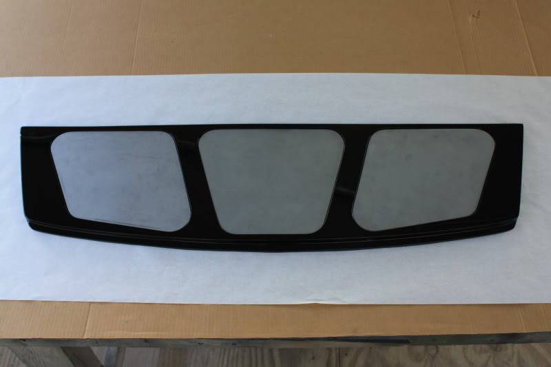

      Hey Randal,
      I would mount the box under the package tray and fire it into the car. We are currently working on a package try that will allow the use of a sub and 6x9s or components.
      We hope to have this available in a couple weeks !
      Thanks, Brian
      Check out my web site.
      Merritt Island,FL
      1,182
      Here is a sneek peek !
      Panels will ship with covered grills . We made the grills big enought to accommodate a variety of speaker configurations.
