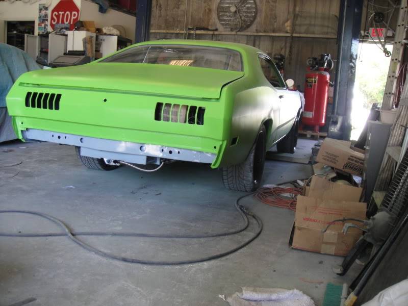

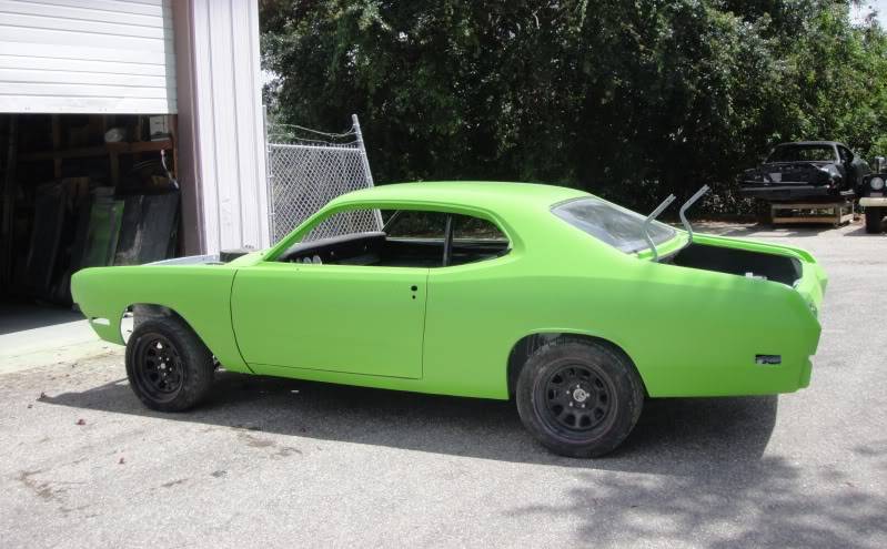

      Heres how it looks in the sun MattWash08:
      (Im still nervous at how high the front is, i dont know if the ground clearance will allow me to go as low as it needs to)
      Ive always liked the flat paints, it makes the car stand out. when you go to a car show you almost forget how many hours go into making those beautiful crystal clear paint jobs when thats all that is there. The flat (and now searing green) makes it stand out to me, with a lot less effort-no color sand/buffing. But the whole reason for the flat was that the duster, and this car for a while at least, will only be living in parking lots until i grow up and graduate haha. At like $150 for a gallon of paint its less of a punch in the stomach if someone opens their door into your quarter panel...

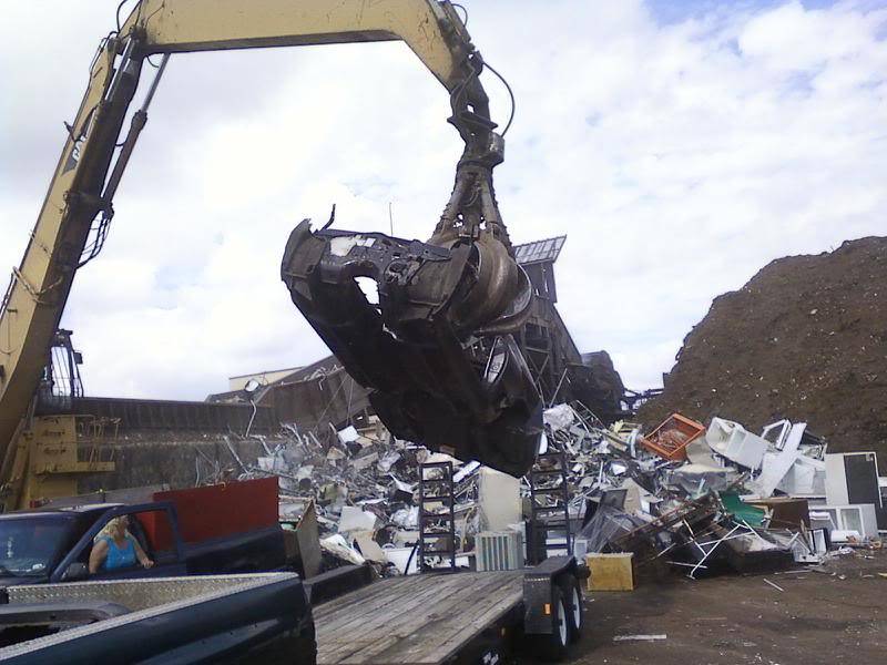

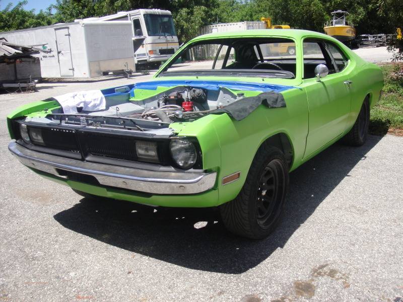

      Thanks a lot guys, im having a good time finally doing what i want and getting my hands on the car! First my friend and i took the duster apart and brought it to the scrap yard. Now the body dolly is free and ready for my kaisers cab(hopefully in a month).

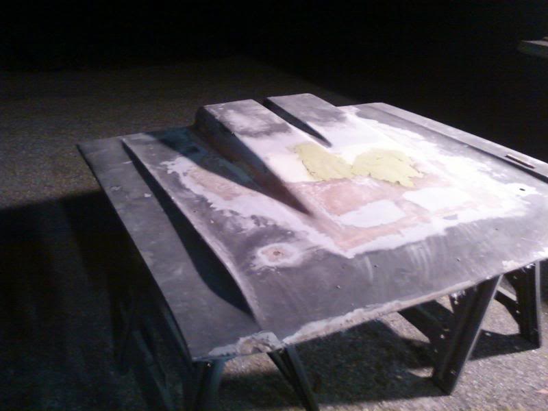

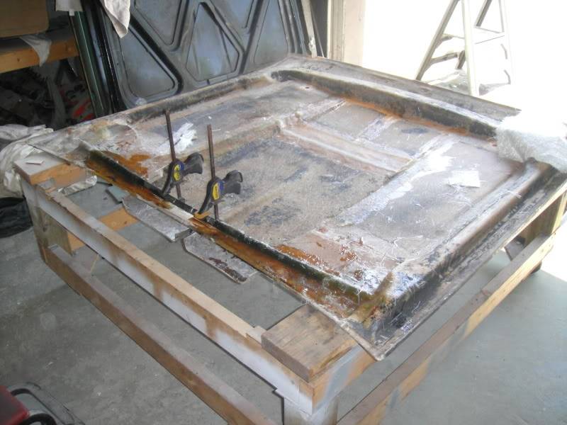

      Today my dad and i got the trunk on, and i roughed in the hood finally- i had to crack it in half in the back and give it more contour left to right..its all in one piece now, ready for some fine tuned body work with a grinder, then bondo and an orbital.

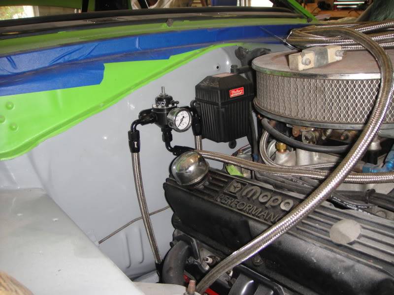

      You can see into the engine compartment pretty well through the windshield, i think im going to do the ricey, car-showey thing and put two sets of green led's under the hood, i already have the wiring there from the universal painless setup. More fiberglassing, wiring, and welding tomorrow...

      today i finished all of the fuel system that i can do until the new intakes in the car. I fabbed up a new set of transmission tunnel covers, and did some more work on the hood. I tried installing the hydraboost, but i cant install it upsidedown as planned, it hits the clutch master and the hydraulic lines are pointed towards the headers...flipped over in the correct direction and the gas cannister is close to the headers, but everything clears, so thats how ill be running it

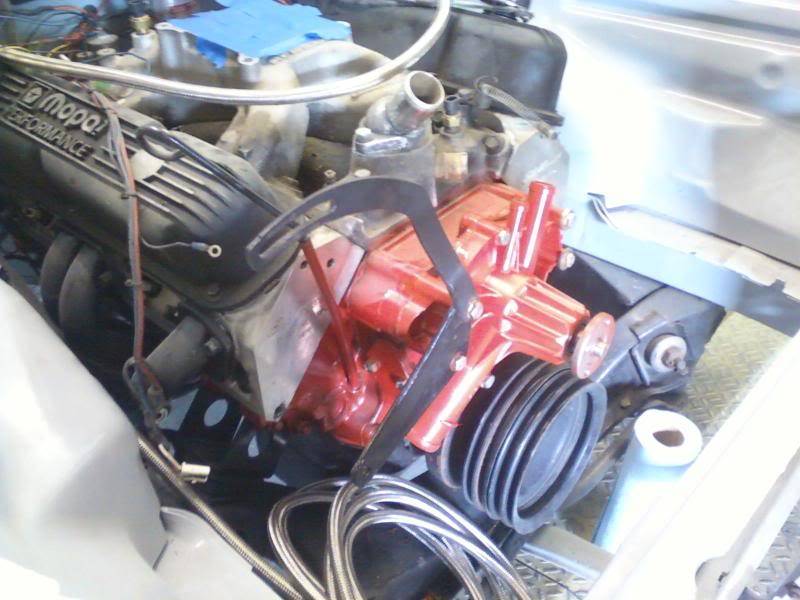

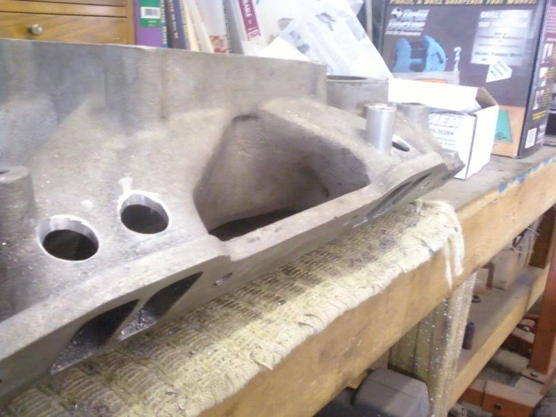

      A lot of the loose ends were taken care of on this trip-not as much as i wanted to get done, but enough to make me happy with the progress. I got the intake manifold drilled ready to be tigged, got the new water pump on, the mechanical fuel pump block off installed, and the steering column in with the hydraboost above it. I spent a lot of time on tho hood, and its getting close to being presentable.

      that intake mod looks awfully familiar.....

      Haha, i saw that...it took me like 5hrs to progressively drill those holes with a drill press. With all the time i have into that thing itd almost have been worth buying a new efi manifold haha
