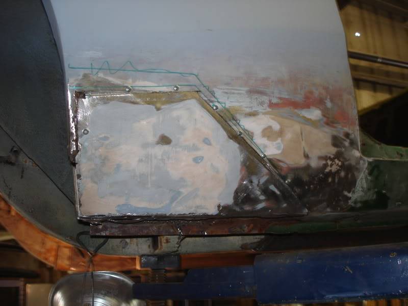

      Heres what my dad got done in about a week: The engine compartment and front inner fenders/sub-frame are painted grey now. He also started wire brushing the old dirt and undercoating off the rest of the floors to have them painted in a couple weeks.
      The last bit of rust was removed and patched with a patch panel donated by the duster:
      Planning ahead, hopefully in about 3 weeks Ill be able to go home and transfer the dusters wiring harness and dash over to the demon, as well as drop the drivetrain out of the duster.
