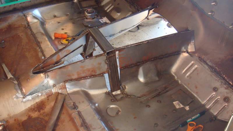

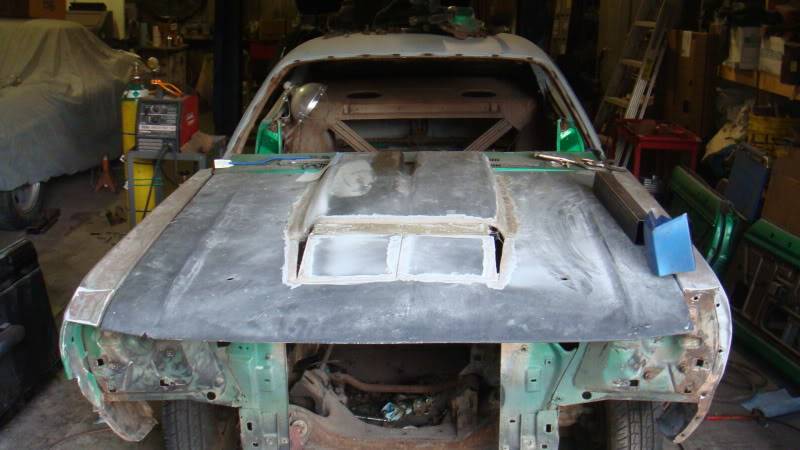

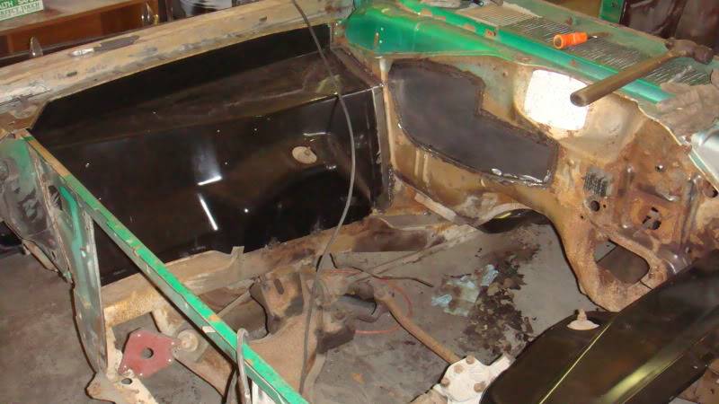

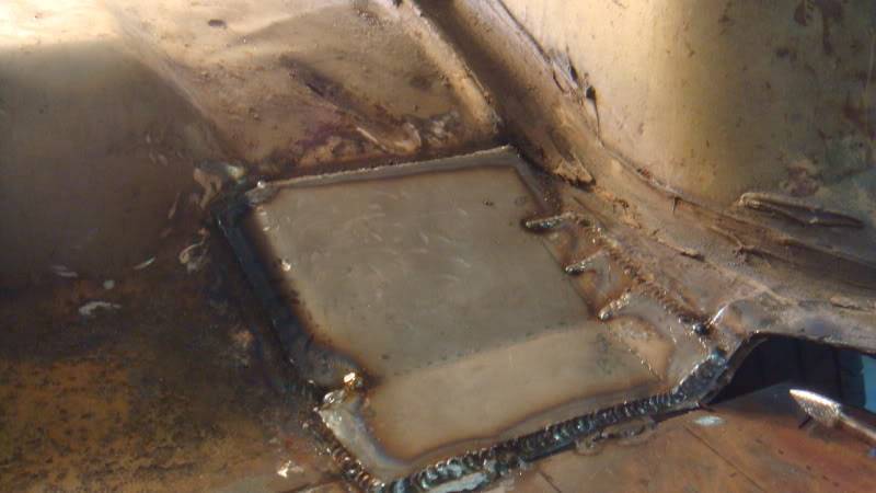

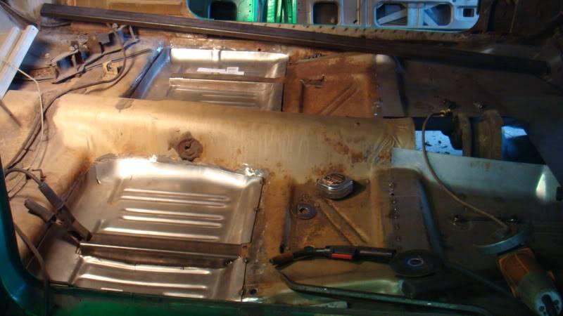

      Well i got home yesturday and found out that my dad got a lot more done than i thought, the inner fenders are completely welded in. I cut out the old rear floor pans and started welding in the new. I did a bit of fiberglass work on the hood, its going the need a lot of work though to match the cowl on the car's countour from side to side ...

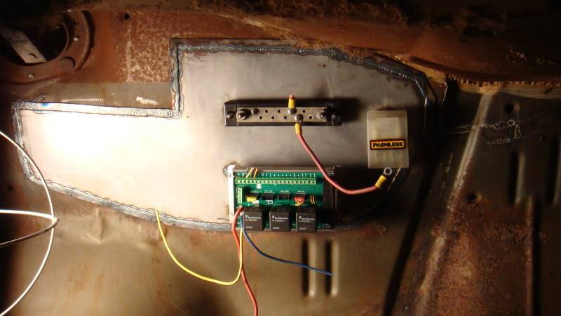

      welded studs to the firewall for my relay board, fuse for alternator, 12v+ bar:

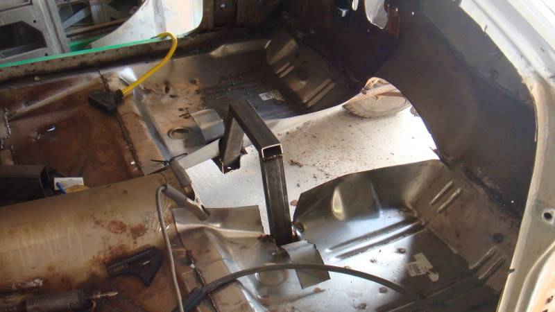

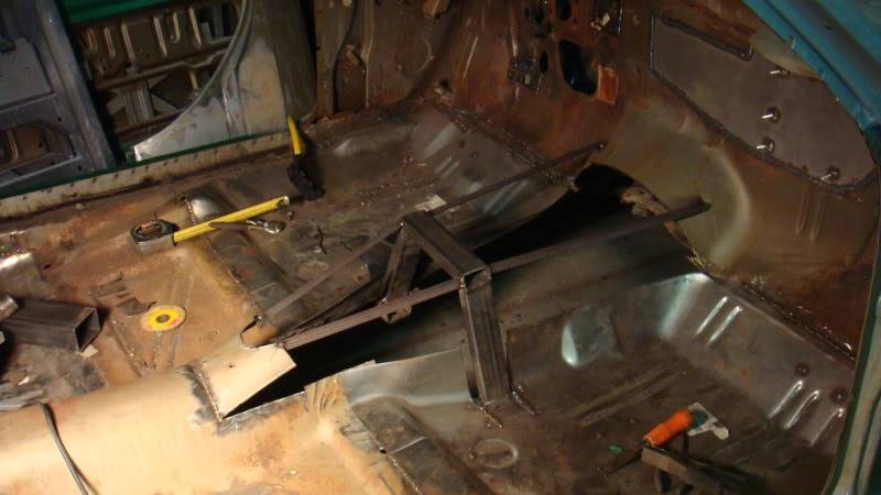

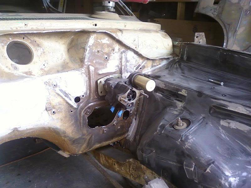

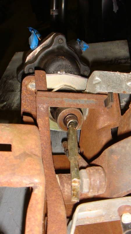

      Well it doesnt look like much, but heres what i got done today: I cut the transmission crossmember out and welded in the new, i accidentally made it about 1" wider on each side at the base than the dusters, but that wont hurt anything. I cut the hydroboost mount up to start fitting it to the firewall, i really want to run it upside down to hide the lines, and get a lot more valve cover clearance. To do this id have to cut up the firewall a bit more, but it'd be worth it in the long run; I still have to see how the pedal to hydroboost linkage looks too.
      EDIT: Bit of work on the transmission tunnel. I wanted to re-use the back portion of the tunnel from the duster, but i realized that the accident twisted and bent/buckled the tunnel in 3 different places. I also looked at the hydroboost a bit on the demons pedal assembly, It slightly interferes with the 1/2" angle iron bracing of the assembly. I currently see no reason to make a spacer (if i did itd be under 3/8") it should just bolt in, and use the Astro vans linkage even.

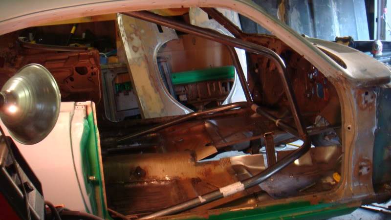

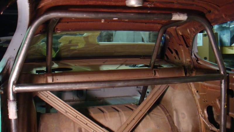

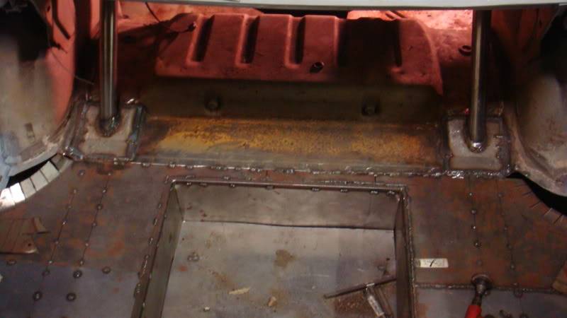

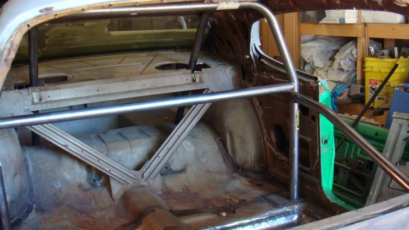

      Well, Its been a long day without much to show, but progress was made. I welded up the roll bar, I tacked it, then pushed it forward so i could weld the uprights all the way around more easily-that was a mistake. The cage had warped slightly from where i wanted it from the heat, i just had to use a bit of force to tack the tubes to the floor. I was working on the door bar and the 6"x6" floor mount but gave up early tonight.
      6x6 trunk mounts
      pulled cage down after tacking to finish all the way around
      Finally in place where it needs to be
      Mounts in the trunk are a bit further back, i thought it would help strenght-wise
      More tomorrow, My dad and i are hoping to get the major welding done so we can put it on the lift to remove the suspension before i go (to start prepping for paint).

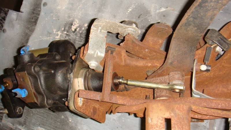

      EDIT: no new pictures tonight, just worked on tacking the transmission tunnel together while my dad notched out the firewall to fit the hydroboost (upside down). I welded the door bar in this morning, so the rest of the welding consists of the transmission crossmember underneath, and a few tiny patches of sheetmetal in the trunk and trans tunnel.
