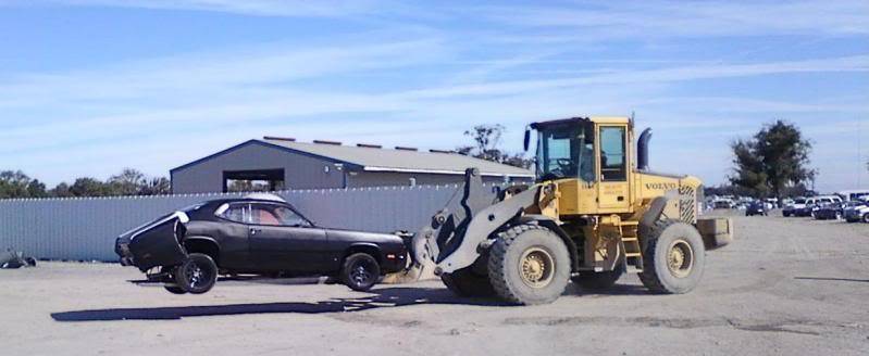

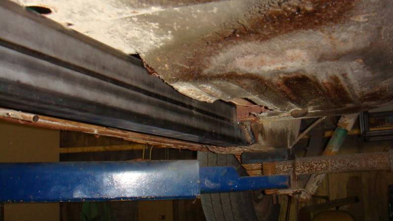

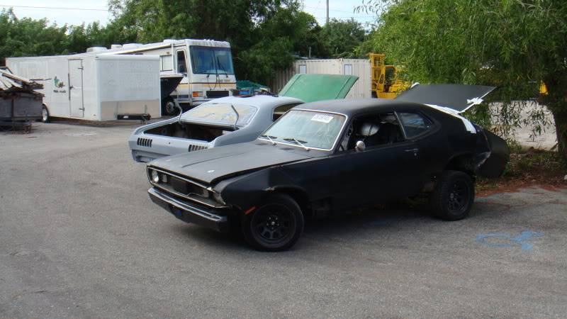

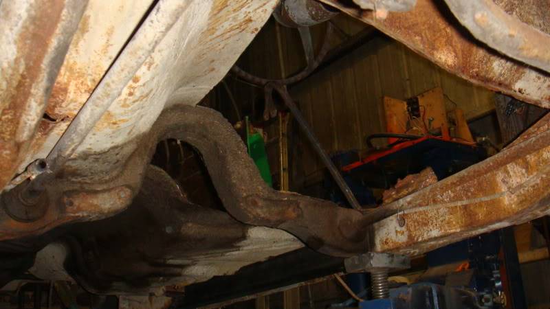

      Heres a pic of how i got the duster delivered to me...I was told they were specialized lifts that would not damage any underbody components-bs! I didnt notice until i got it home, but theres a huge dent in the back of the oil pan.

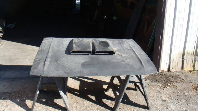

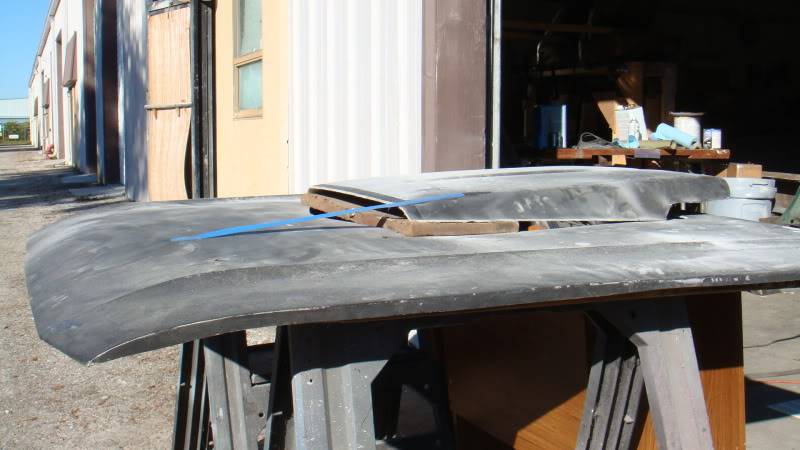

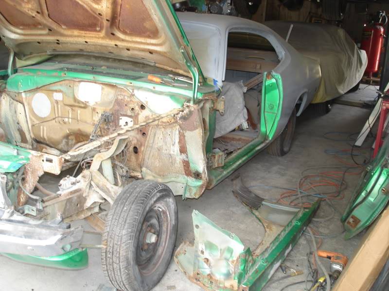

      I found a used fiberglass hood for the demon on CL for $150. It has the factory style scoop, but i dont like the looks of those; im going to splice in a cowl scoop. My dad thinks theres too many spot welds on the inner fender wells to take the dusters off and use on the demon, so we'll be ordering new ones. I have a solid 4 days of working on the demon before i have to work again, well see how much i can get done.

      daaamn brotha.. they rearended you so hard it turned the duster into a pinto!

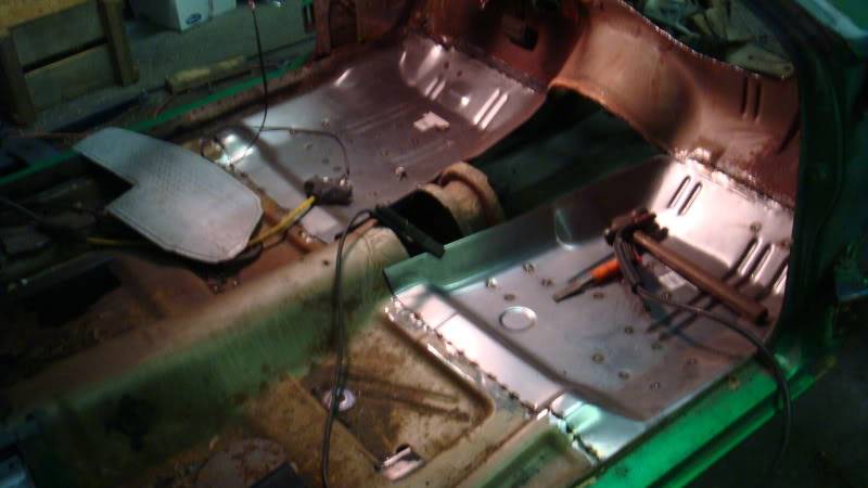

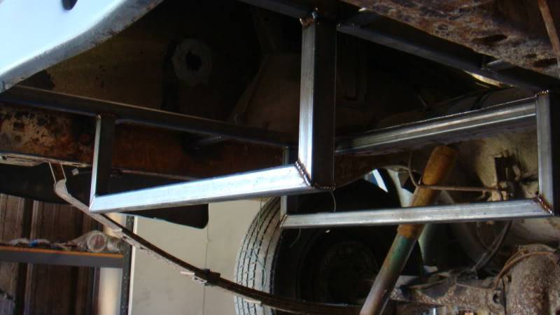

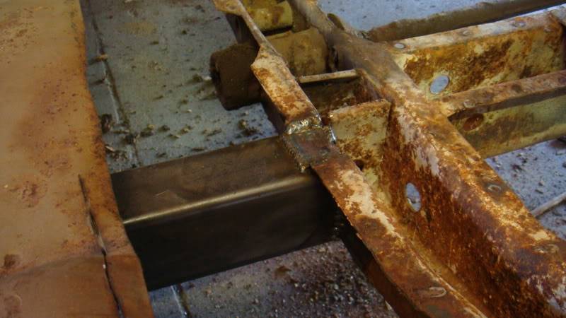

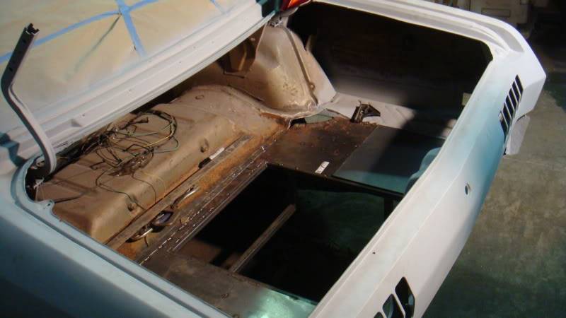

      ..I didnt get as much finished as i wouldve liked, but im going back out there tonight for another few hours of work. I finished up the fuel cell's trunk frame, and got one of the subframe connectors cut up and welded in. Im hoping to get the other subframe connector welded in tonight, the front floor pans out, and maybe the new fronts tacked in.
      EDIT: Just got back from the shop, the subframe connectors are in and the front floors are 1/2 out. Ill be back at it tomorrow hopefully to break the front windshield out, take the dash out, put the floors in, and work on shaving the firewall...

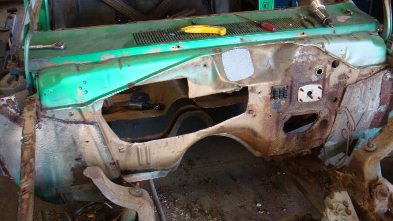

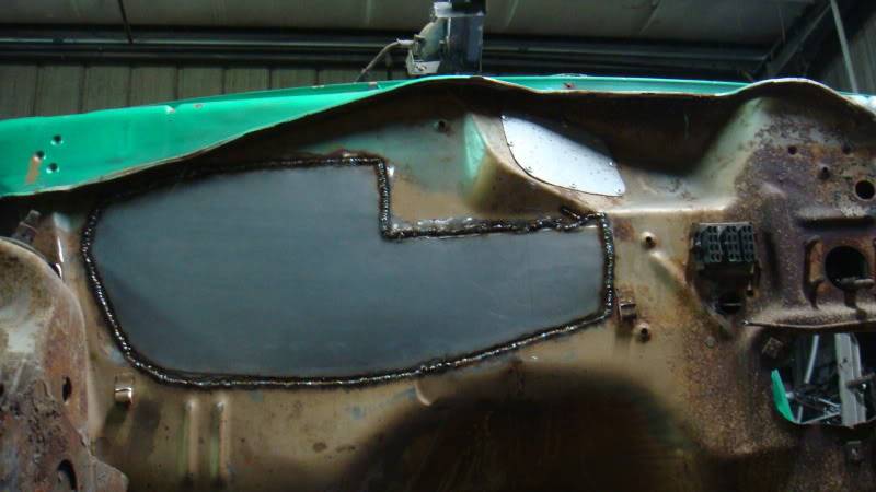

      Today i took out the rest of the floor pans, welded the tops of the subframe connectors better, cut out the firewall, took the dash/windshield out while my dad did some work on the front fenders.
      Ill be heading back later tonight to get more done (i forgot the sheet metal in my truck at home this morning). I plan to work on the trunk floor, front floor pans, and fill in the firewall.
      EDIT: went back, got most of the trunk done, my dad welded the front floor pans in, and I made up the firewall patch so its ready to get welded in tomorrow

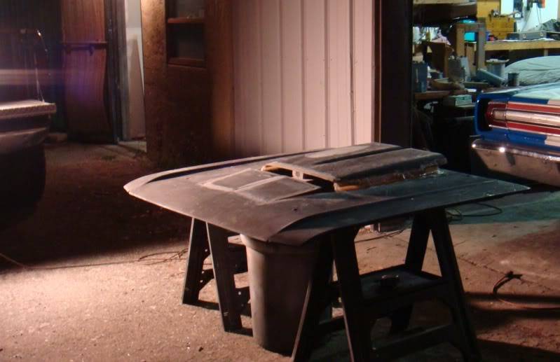

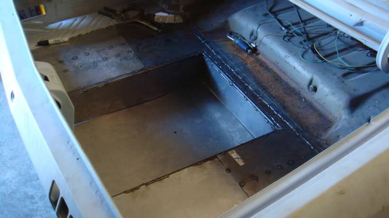

      Well, i got the firewall shaved, the trunk finished and started making my cowl hood. Ive moved onto the hood since were still waiting on rear floor pans, roll cage..etc.
      EDIT: the rest of the nights work, i probably have another day or so of work on the hood. The inner fender wells are coming in in two days, so no hold-ups!

      Good to see you exorcising the Demon! Lightning fast progress too, Tim. Are you shaving your firewall because the aftermarket A/C doesn't need the factory firewall deformities? I'll probably get to doing the firewall before I even get the aftermarket A/C unit. Does the whole area get smoothed aside from the heater hoses?

      Thanks guys! And Johnny, no A/C for me..none of our cars have air conditioning. I dont plan on putting it in the demon either to keep to the simplistic bare-bones K.I.S.S. fundamentals that i left off on the duster with.
      ROFL!! I thought it was a pinto when i first glanced at it!! lol Doing good keep up the work
