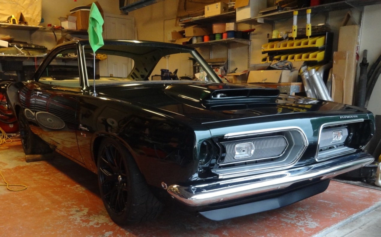

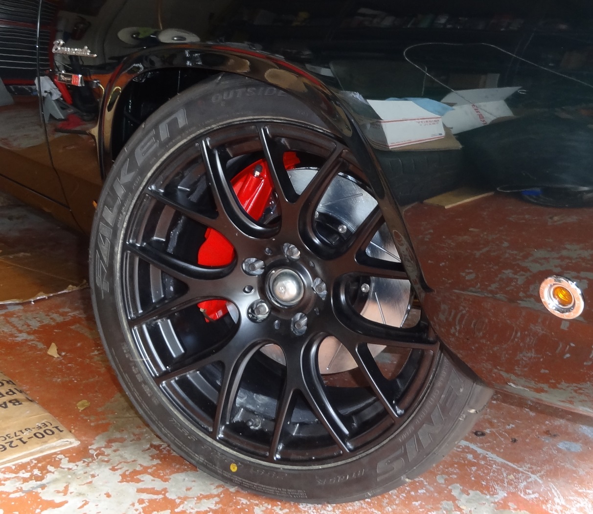

      I'm running a 225/45/17's up front and 275/35/17's in the rear. Wheels are just a stock cheap set of cragar steel wheels.
      The next big purchase for this car is a set of badass wheels and tires...I've read that these cars can run 275's up front with the right offset, and I've minitubbed the rear, so I'm looking to run 275's front and 315-335's in the rear. But before I do that I need to replace some ball joints and might adapt some bigger brakes in the front.
      My car is the same chassis, but slightly different fenders. I have 18x9 with 255/40-18 on the front of my car now. Pretty sure 275/35-18 will fit easily. I currently have 18x10 with 295/40-18 in the back, but I have a LOT of clearance. I previously had 325/50-15 drag radials tucked under the back. I had to modify the front fender to clear a 26" tire on turn in. But, definitely a different fender on your car, so hard for me to say. Details on the fender mods: http://www.forabodiesonly.com/mopar/...6-tires.10247/
