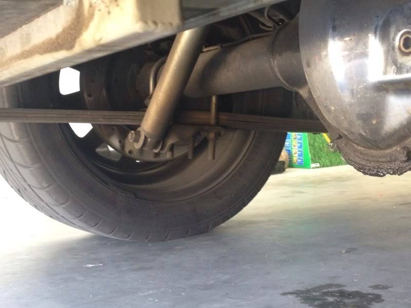

      According to Hotchkis-nothing. From the beginning they had been softer than the slant six springs I had on the donor. I told them a month into owning them they looked like they were concave and not flat, but a couple weeks worth of measurements, pictures, and back-and-forth lead to them telling me they were fine. Now that they are bowed concavely after less than 7000mi on them they attribute that to my Dana 60 hitting the pinion snubber, which by my measurements is no higher than an 8-3/4". It's a sore subject for me...

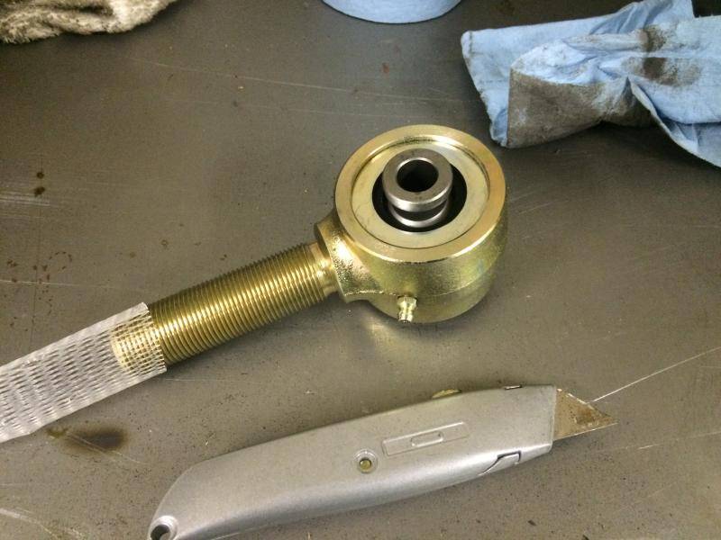

      Wheel wells are all cut out, I need to get some sheet metal before I make anymore progress; I thought it'd take me longer to get here. I also got the heim joints in the mail.

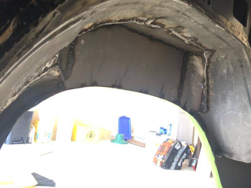

      After 10hrs this weekend I got the wheel wells tacked in, except for a couple patches on the passenger side.
      I cut the outer fender wells out too, there was a decent lip (~1") that I thought I'd kick myself if I didn't clear out of the way for the future. It's not the most seamless patch-up but its out of the way.

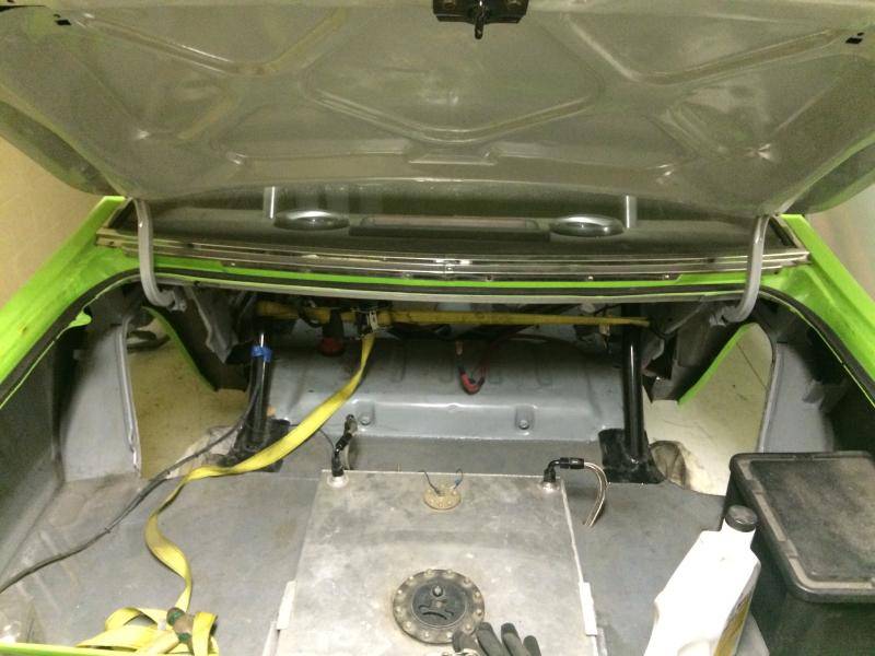

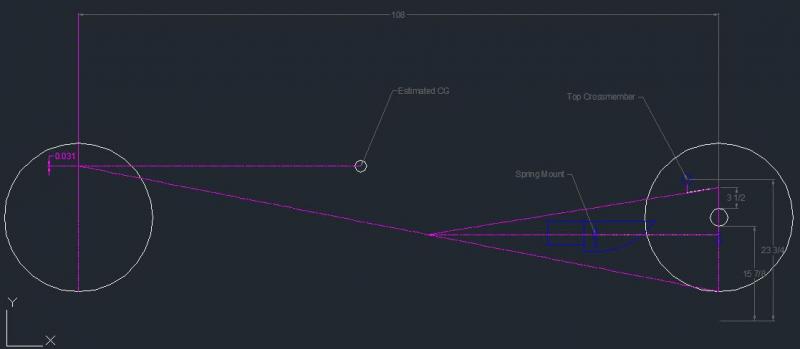

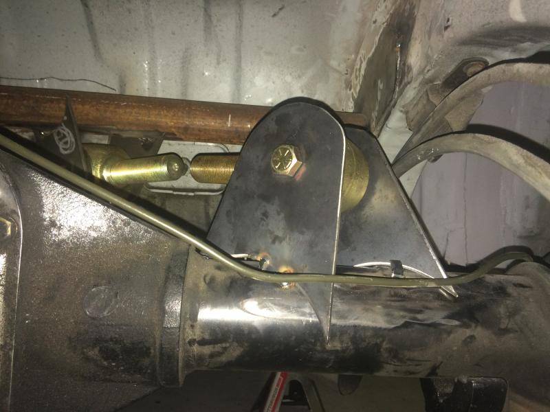

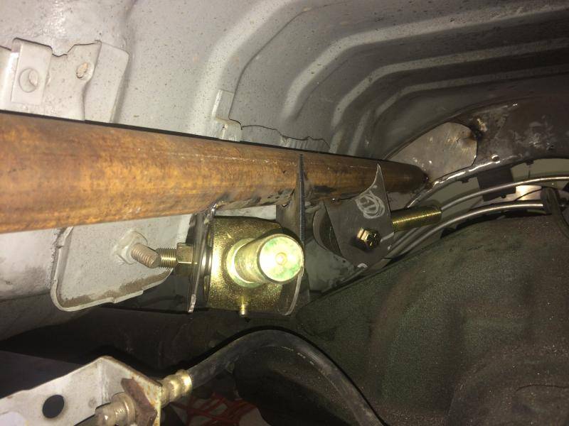

      Not too much visual progress, the inner fenders are done and ready for paint. I finally got the upper link's crossmember cut and tacked in, I cut the mounting tabs but realized I should look more closely into link angles/heights before cutting. If I have a 3.5" tall mount (5" from axle CL) on the differential It'll be at 100% anti squat. Hopefully I can get the upper links tacked in this week.
      Tim
      71' Demon-408, efi, 'viper spec' T56, Dana 60 w/ triangulated 4 link
    15. #275
      Apr 2008
      Lakeland, FL
      516

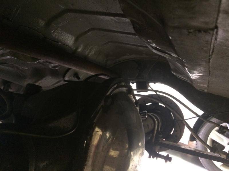

      It's hard to get decent pictures underneath but I have the upper links tacked to the crossmember and should be symmetrical within ~1/4". I originally tried to 'freehand' the templates for the links-that didn't work well. These I drew the radius out in CAD and assured the links will be were right distance from the crossbar. If all goes well maybe I can start working on the lower links by next weekend.
      Tim

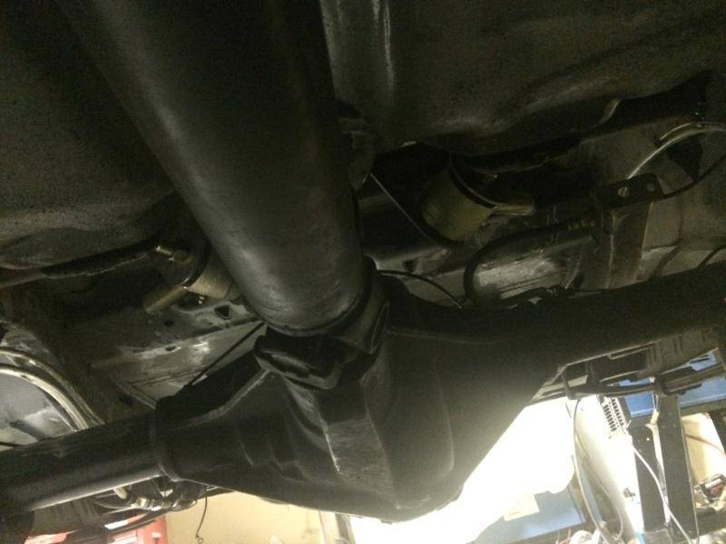

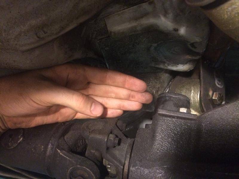

      Tim how is your driveshaft to tunnel clearance? I am at kind of a fork in the road of my current build of raise the tunnel or live with it. Your car is a 108" WB to my 111" but I think the floors are pretty much the same.
    17. #277
      Apr 2008
      Lakeland, FL
      516
      I'll give you an exact measurement when I'm under there next time, the car is where I want ride height to be now and in the pictures. With the hotchkis springs I would rub the diff u-joint on big bumps, I'll be removing the pinion snubber and that crumpled piece of floor that was rubbing (bad area of the factory stamping) but otherwise I haven't had tunnel clearance issues.

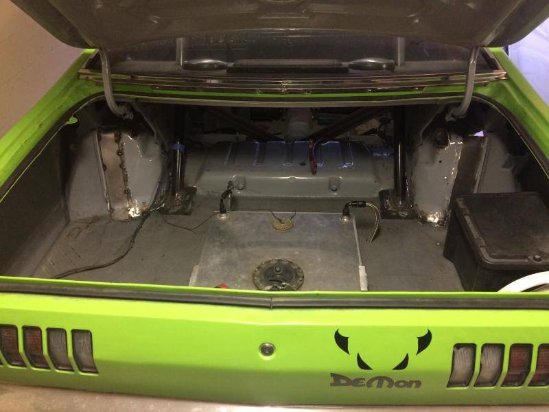

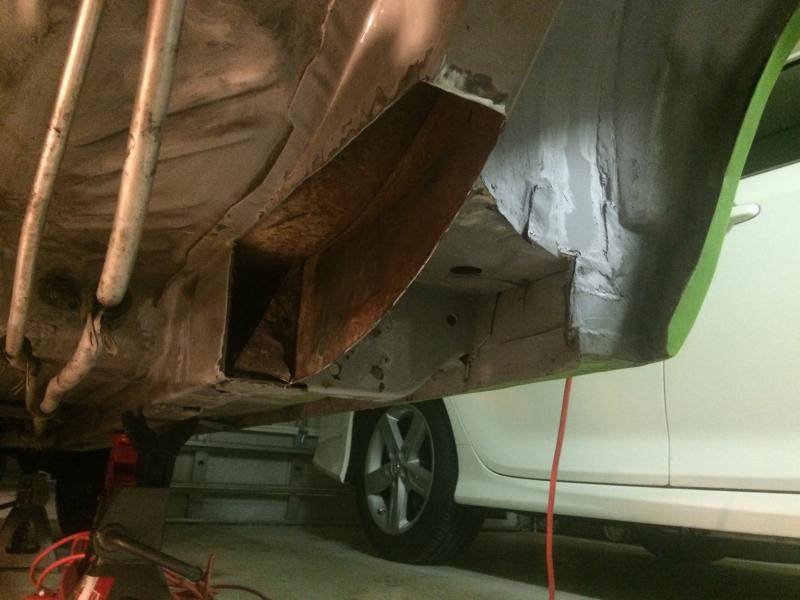

      The diff mounts are tacked in place, and I've moved onto the lower links, starting with removing the leaf spring and cutting the frame rail. Hopefully tomorrow I can cut the new frame rail section, tack it into place and move onto the other side. Hoping that by the weekend I might have everything tacked and I can start pulling things out to weld completely.
      Here is the clearance I'll have in the driveshaft tunnel, I had maybe 2" at the snubber with the leaves (and the car 'bulldogging')

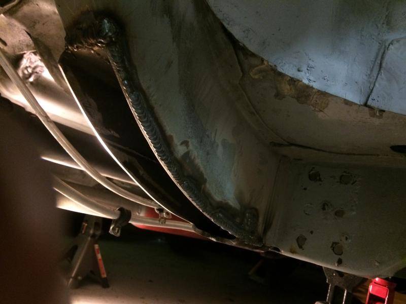

      One side in, hopefully the other will be in by mid Saturday and I can move onto the links and pulling everything apart to weld up and paint.
