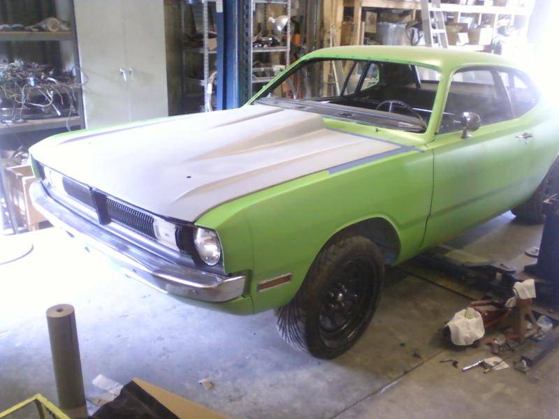

      I was thinking of painting the 'lip' around the grille the same metallic dark grey that the dusters was, not sure yet...all the front grille pieces are as they came to us.

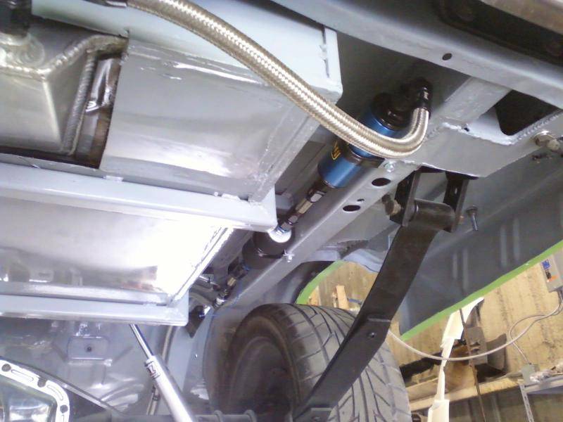

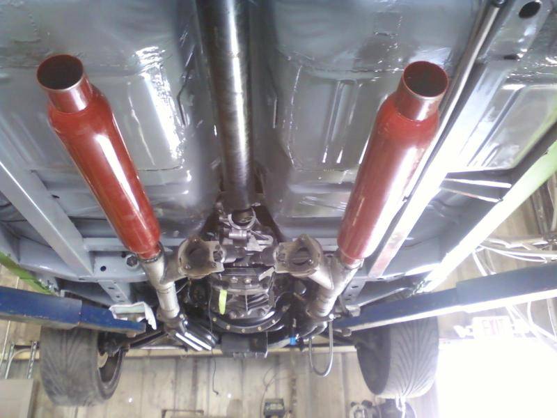

      couple pictures to add- One of the hack job i did to fit the exhaust, i added a 45 degree bend to each side so the exhaust comes out under the car at the front of the leaf springs. The other is of the fuel pump and filter since i dont think i ever took a picture of it; i tightened all of the fittings down finally.

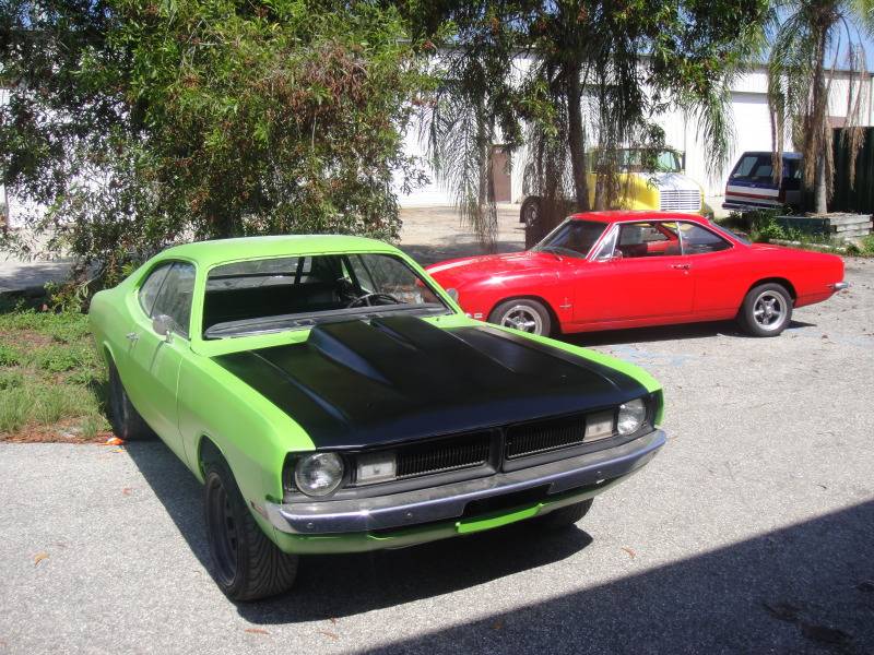

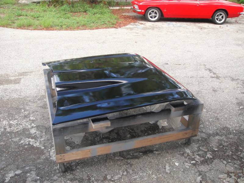

      I just got a picture from my dad, the hood is finally painted, i think its so glossy because its still wet, its some leftover paint from the duster's flat black
      I dont know when ill be back down there again, things are starting to get busier than i was planning for but all thats left really is to try and start it up!

      My dad got the hood on the demon...just needs a headliner, intake, front glass install, hydroboost plumbing, bolt seats down and thats all i can think of!

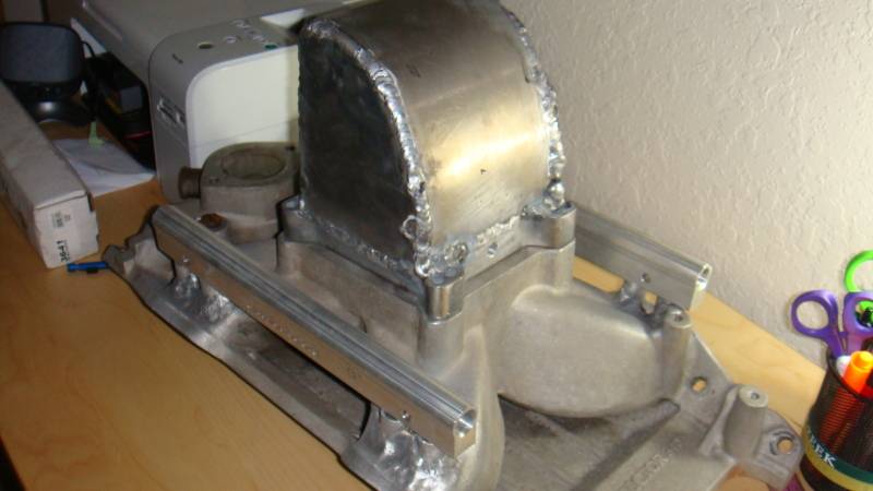

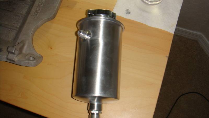

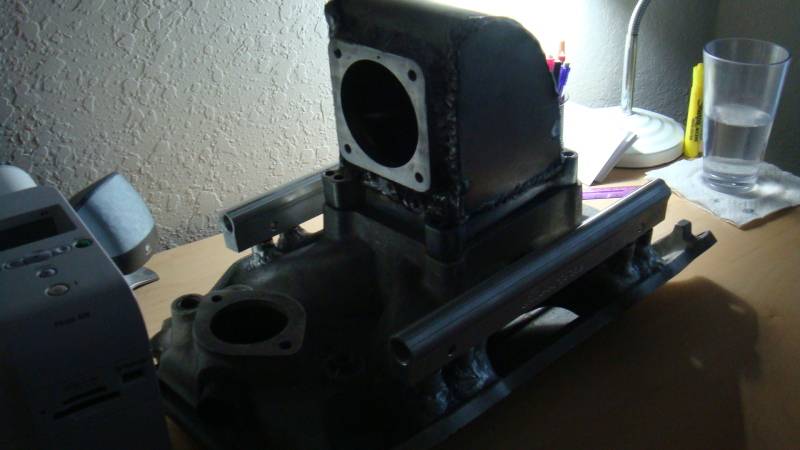

      Big hurdle just jumped: My friend and i finished up welding the intake and throttle body elbow! its not the prettiest, im going to grind everything down smooth for aesthetics while im gasket matching the intake, luckally im more skilled with a set of burrs then a tig torch...I also got my $30 ebay reservoir for the hydroboost pump (aka power steering pump haha). Ill need to tig in another -6AN bung for my high pressure bypass line.

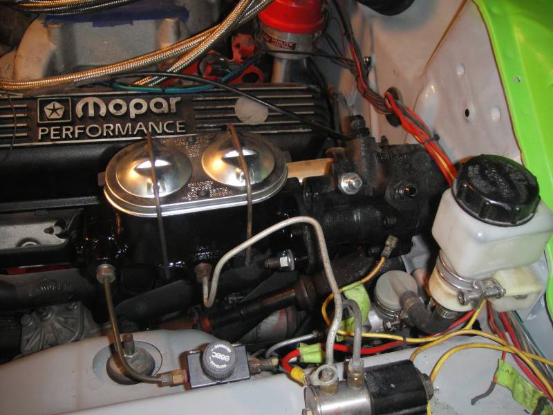

      My dad got the master cylinder all ready too
      No car work scheduled for me this weekend, im hoping to look at and pick up a Syncrowave 351 tig welder, maybe in a few months my skills will have improved.

      That intake set up is really coming along man! Looking good! I say bolt up the throttle body for a teaser shot!

      Quote Originally Posted by ALLstrokedOUT View Post
      I see you happened to take the pictures from the side "your friend" welded lol I know it just happened to turn out that way ;) but I still got a smile out of it even though mine certainly aren't perfect either. I had the advantage though since I got to sit with it for twice as long lol yours will come back once you get the nicer welder than me!

      Haha, it's actually just coincidence, you can still see my ugly side a bit. But yea, and more practice time would help too...I'm going to stick to it and point out again that my side also had the bigger gap to fill

      I cut it that way on purpose ;) lol jk

      Looks good, I look forward to seeing the progress with the MS. Intake looks good.
