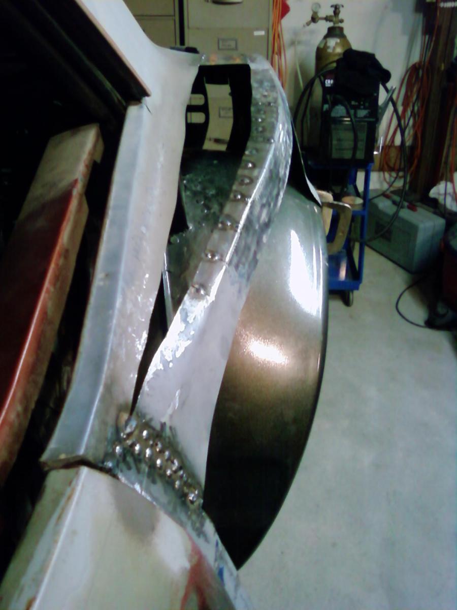

      Its been a couple of years since I promised to put more pictures from my build, finally getting around to it.Name:  3F02-7-15(21-44).jpg
Size:  36.6 KB This shows the 3 inch wide strap that I welded in between the top cut line. I had to roll and contour the back end to emulate the weld flange of the rear quarter to the tail panel.Name:  4F02-7-15(21-44).jpg

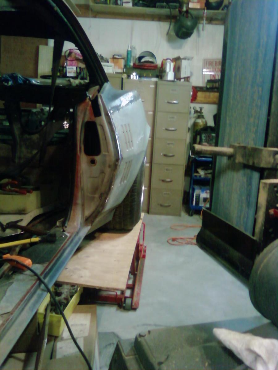

Size:  51.7 KB Then I had to cut the tail light openings out and slid them out 3 inches, then filled the inside void with scrap sheet metal.Name:  floor extension 1-5-02.jpg

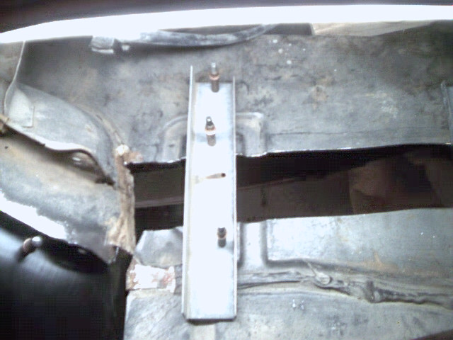

Size:  72.8 KBwhile I was working on the top of the quarter panel, I also had to address the trunk floor extension. So I cleaned all of the rusty original quarter sheet metal off of it and repaired its issues then held it 3 inches out and filled in the gap. Now you can also see the new outer wheel well that is moved out 3 inches from the original outer wheel well. A little secret I found was that the outer wheel wells are flat curved, like a 55gal drum, all you have to do is leave 4 inches of it from the pinch weld area attached to the structure, then weld the new one on 3 inches out for a 1 inch overlap. then you can index the rest of your metal from that.Name:  quarter pre-fit 12-28-01.jpg
