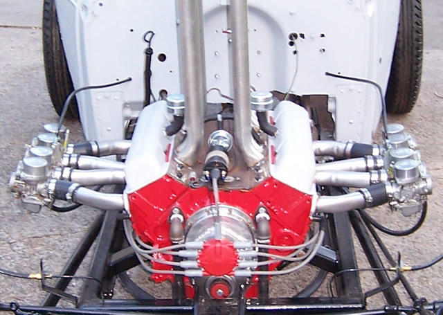

      you're only a little crazy.....
      More information here http://cleverlever99.blogspot.com/
      Cadillac flathead V8s had the exhaust and intake on the top. Do a search for Ron Main and the Flatfire streamliner it had the exhaust on the top as well and ran 300 mph at bonneville.

      I think Smokey or someone did that with early Chevy Indy engines.
