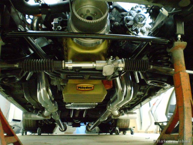

      About fitment issue, Will, I'd suggested to you earlier that you ditch that huge grossmember and make a new one from tubing. Maeby you could build one that goes at the front of the engine as an crash protection for the crank. And make other kind of brakets for LCA. About that have you checked that you racks outter ends (tie rod inner) are not wider than your LCA inner mounting bolts?
      You do know that they have to be same width and angle, other way you get an unwanted bump steer...
      All this with all sincerely, I'm nobody to teach anyone...
      Just that I did little research when I took the Camaro to final wheel alignment. We tied the car down (it has on lift) and checked how much I have to get the outer tierod ends lower on the hub to minimaze to dump steer. Then I did machined the spacers and did the final cut on the extra long tie rod bols that we made for it.
      On my B-body I'm gonna build my own tube K-member as I did on one of my builds, a '71 Camaro that I build an blown stroker big block, I had to get engine down cos it was so high that it didnt get pass on our yearly inspection.
      I got the engine down 6", even got to put lowering blocks on swaybar mounts to lower it 4". The front end is not an low one, but the oil pan sump is good 3.5" from asphalt and rack is about 4". Law says that car have to have min clearance of 75mm/ 3".
      This is just my .02 Like I say'd, I'm nobody to teach anybody about these things...

      More issues than I want to deal with eliminating the front cross member. Plus, it really isn't going to gain me anything because of my steering rack height. The rod end on the spindle dictates how much I can move the steering rack without introducing additional bump steer. On top of it, one way or another I need some sort of tube under the engine, I can only gain maybe 1/2" of clearance which at this point, isn't enough to make it worth the effort. The cross-member is only 2" tall and while, visually, removing it seems like it would solve the problems, that actually introduce more problems than it solves and the limited gain isn't worth it, at this point. When I get back in a couple months, if that ends up being different, I'll consider it. But for now, I'm going to run with it, work around it, and dry-sump it. Suspension geometry is no worries, it's all worked out.
