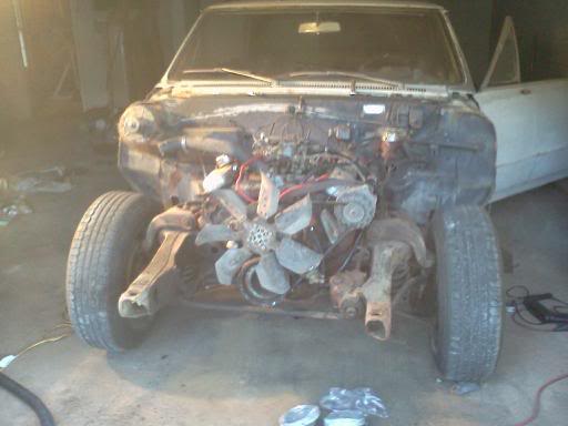

      Well the motor is coming out tonight so I figured I'd get a build thread going with some before shots. The main goal of this build is to farm out as little work as possible and learn as much as I can along the way. I plan to keep the factory drivetrain and overall look but update the suspension so that it'll be fun to drive.
      This was the last time she was all together when I brought her home.
      This is how she sits right now

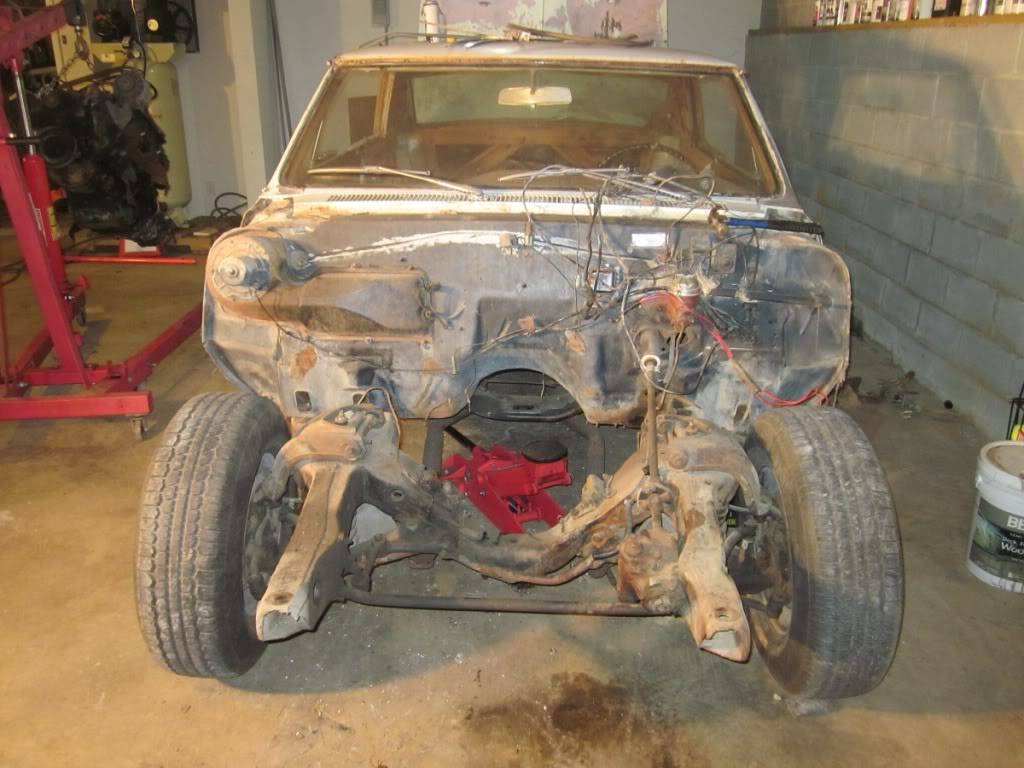

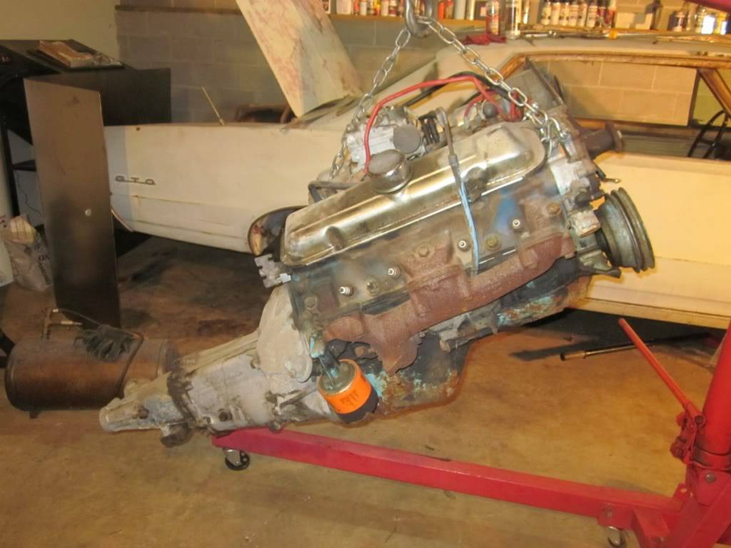

      Got the old Motor out.

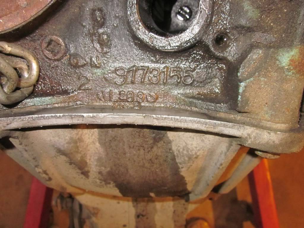

      So, I'm guessing not a numbers matching engine...appears to be a late November 1963 casting from what I can see.
      Are you planning on staying with the 389, or going to a later 400 / 455?

      Correct. That is a 64 motor. When I bought the car It came with a rebuilt '76 400 that has a tripower set up that came out of a GTO that was wrecked less than 1000 miles after the restoration was completed. I don't know much else about the motor, other than the seller said it ran strong in the other gto. Im going to rebuild the tripower set up and redetail the motor and give it a shot. If its a dog, I'll rebuild the 64 389. The '76 motor is in my signature.

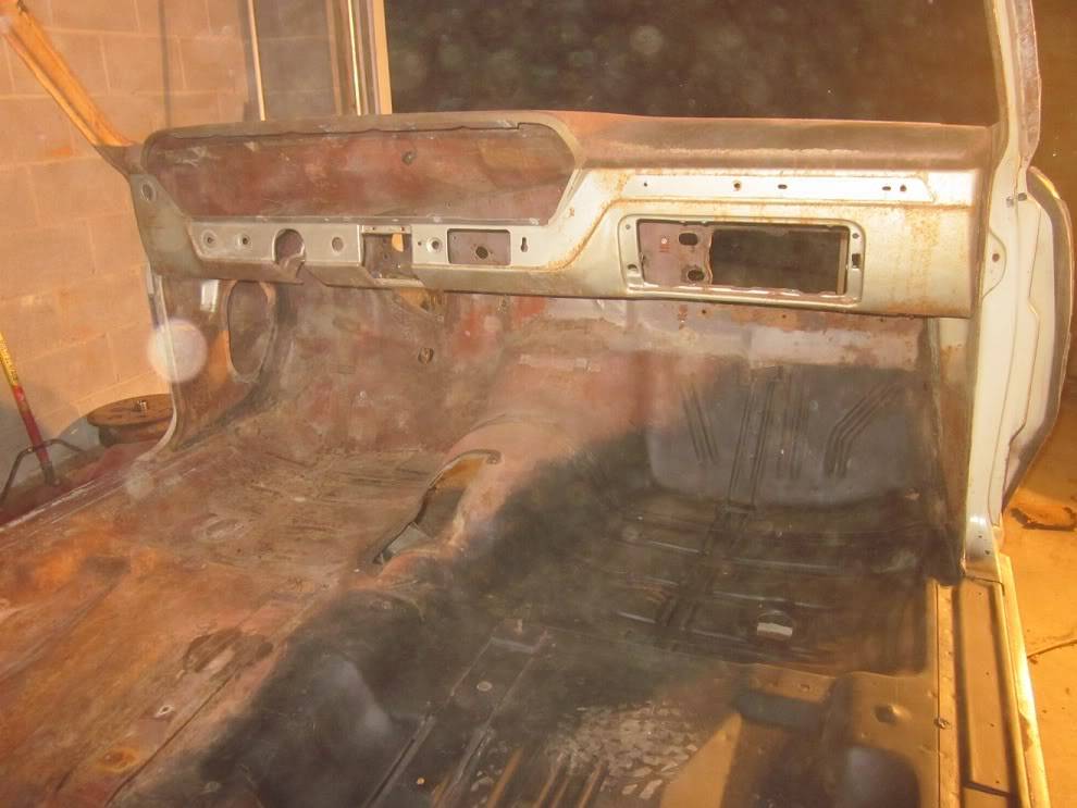

      Just a quick update. I have just been stripping everything off of the body. Got the doors out of the way, windshield is out. Most of the dash is out, still need to get a few things out of there.
      After mulling it over, we are going to pull the body off of the frame and blast it. I think the finished product will benefit from this even though it will take extra time.

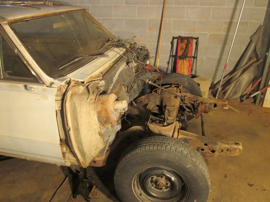

      Everything seems to be on schedule to get the body pulled this weekend. I got everything pulled off of the Dash and firewall tonight. You wouldnt believe the amount of dust and dirt that was collected in all the nook and crannies. Haven't run in to any surprises yet. The car seems very solid.
