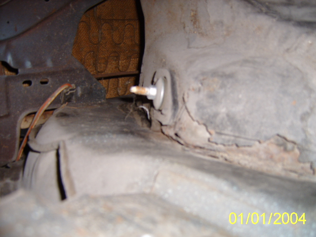

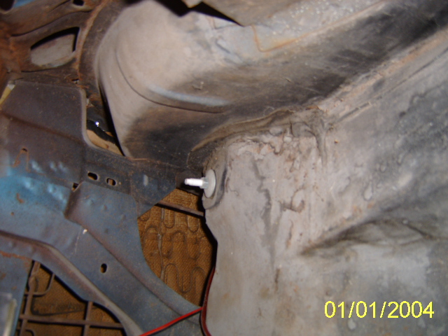

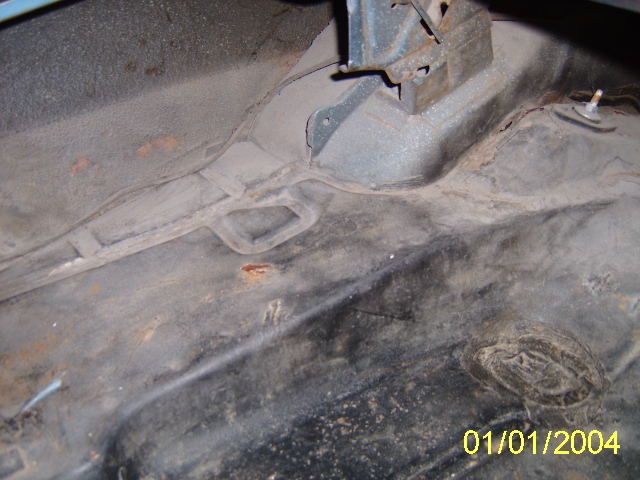

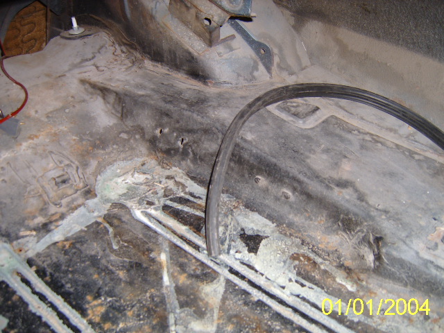

      Well Im about to order my suspension stuff and gonna get all that done before I do body work. The trunk is rusty around the shock tower and has some surface rust. Whats the best think to spray the rust with to hopfully to keep the rust from growing. I also plan on spraying somekind of textured paint in the trunk for the time beeing to have it look just a tad better. Is that raptor
      stuff I see on here alot the best stuff for this job. I thought about spraying some rustoleum then the textured paint. What you think? Dont pay attention to the dates....had to put batteries in camera and didnt feel like setting the date.

      Looks to me that the problem area is right next to the wheel tub. Ever think about installing mini tubs?
      That looks like that would cut out most of the rust.
      You really need to cut it out and replace with new metal.
      If you are going to mask it then take a wire wheel and clean it good before you do any painting. Not the right way to fix it but...

      Good luck with it. A floor patch is really cheap if you know how to weld.
      Keep an eye on that area, it's right next to the shocks and they could pop through if its weak around it.

      dont paint over rust. Cant put a band aid on cancer. Cut out the bad rust and wire wheel all the surface rust. You can wire wheel a whole trunk in about 4 hours. Just wear a mask.
