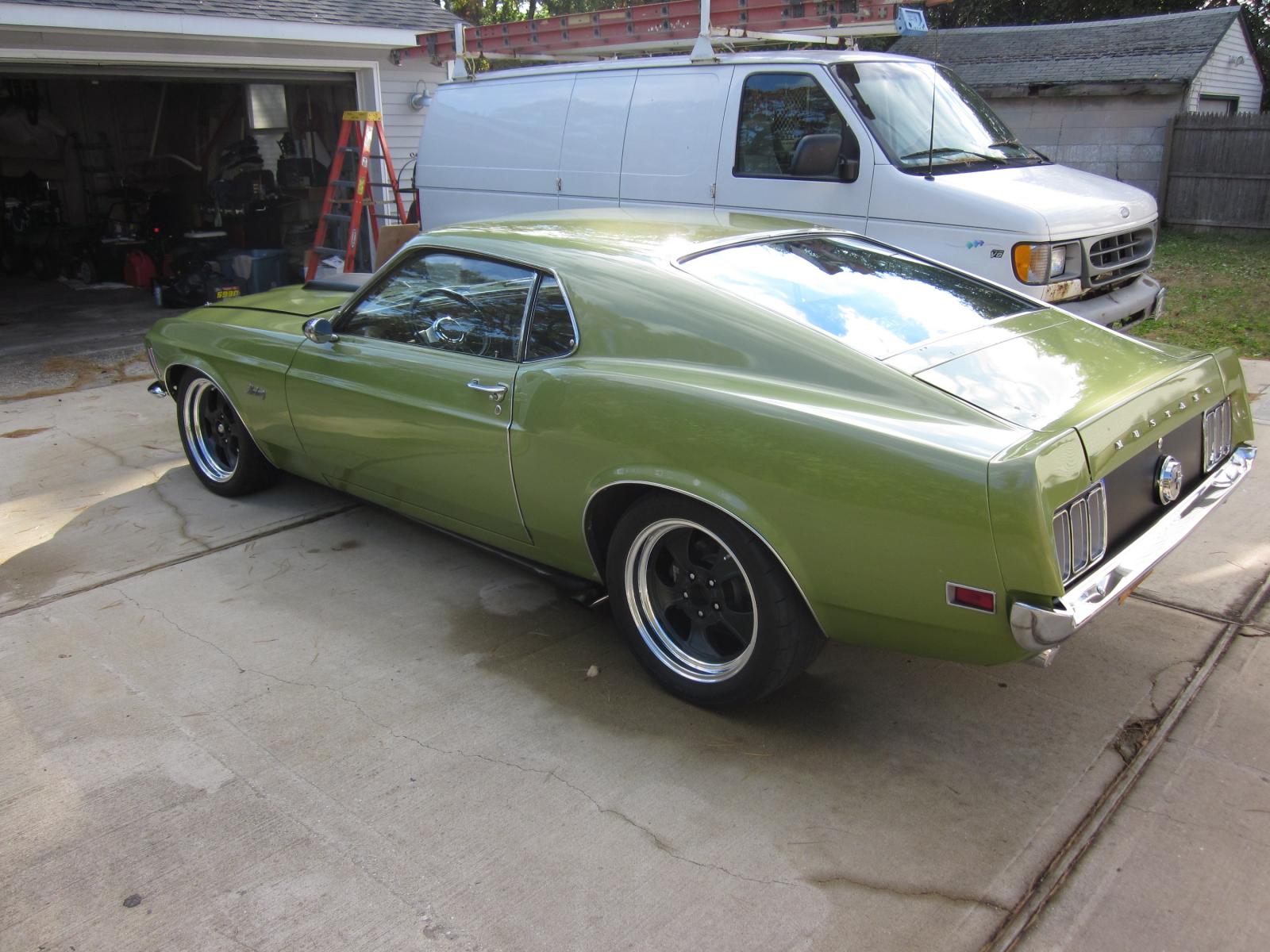

      Ok i just want to post a little update i got the rear shocks in and went over the rear setup and all is well. the front is a problem the front shocks are leaking but working i going to send them back they are double adjusts and iam going to do singles like in the rear.
      here is a few shots i took today.

      Very sharp looking car.

      Very nice looking Mustang....I'm a chevy guy, but I really like this car.

      Very nice looking car. Make sure and let us know what you think of the New Single's you are putting on the car.

      thanks all for the kind words. I had my doubts about my setup but it coming along well.
      Ill let you know Beau

      My first classic was a 69 Mustang. 69-70 are still my favorite years. Great looking car! It's nice to see a green one too.

      I don't like mustangs... but I like this car!
