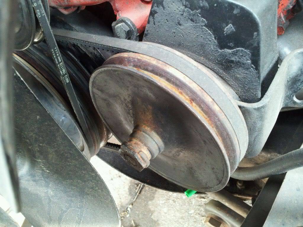

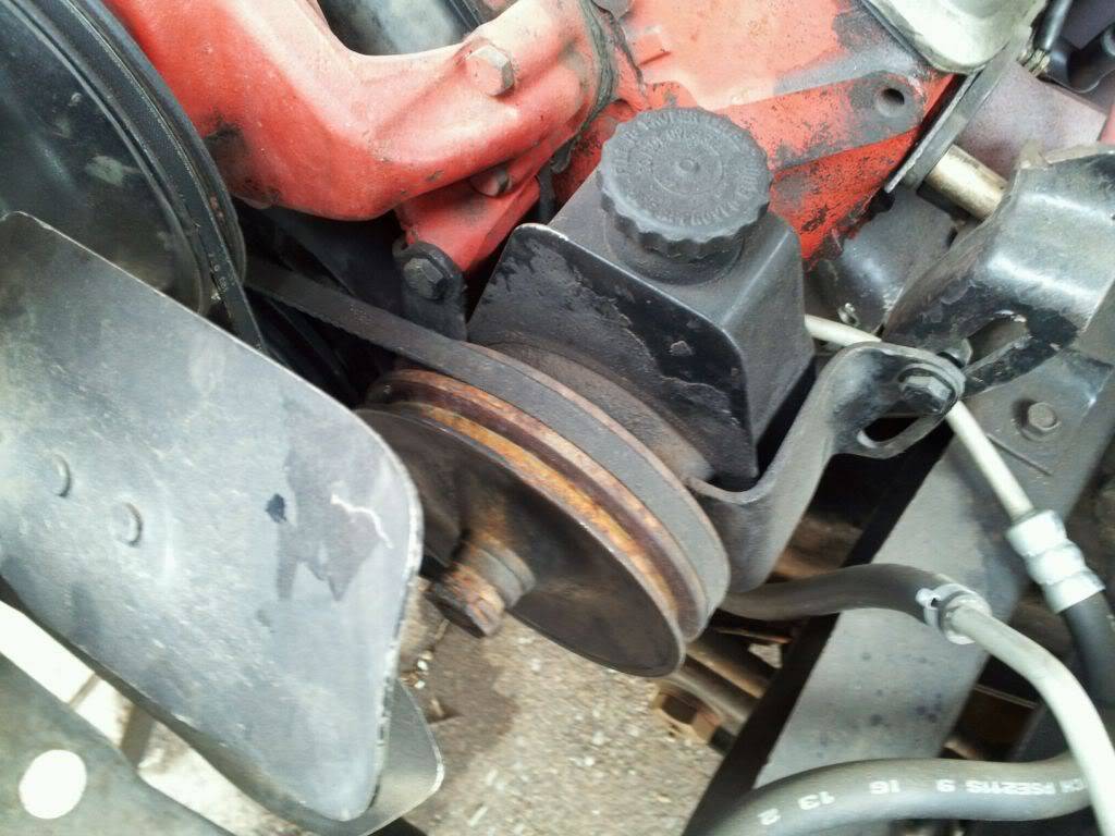

      Okay, So I'm sure that this is a keyway, but because I want to make absolute certain before I spend the cash...could anyone be so kind as to verify this is indeed a keyway?
