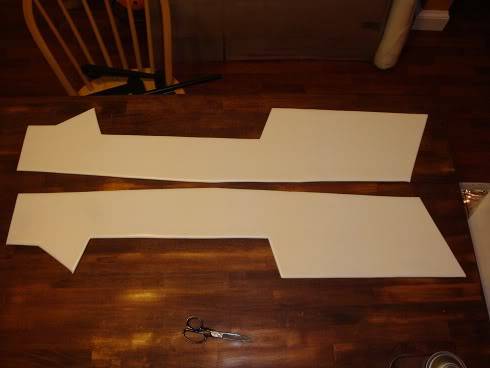

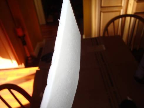

      I didn't like the density of the foam I got, too soft.
      I read what another member (protour73) used for his door panels and ordered some of that.
      1/8" regular 2-A VOLARA Closed Cell Foam from a compnay called http://www.yourautotrim.com/
      Just got it in and it's the perfect density for what I want.
      Now I can start covering it. Hopefully tonight.

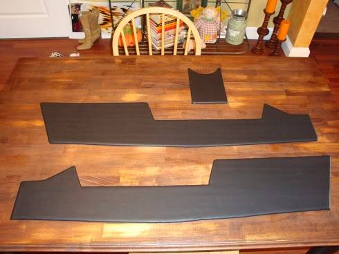

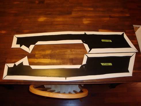

      Got the padding on and the vinyl on.
      I shouldn't quit my day job to do upholstery but not bad for a guy who doesn't know what he's doing.
      Now I just have to sand and clear the top and cut out the holes for the shifter and cup holders.
      More soon I hope.

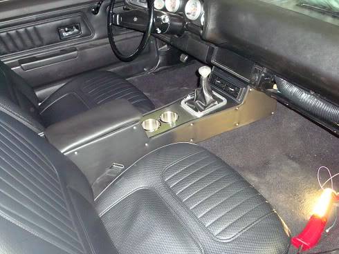

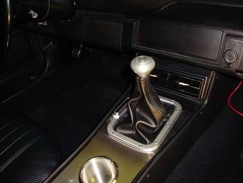

      Well finally got to the garage today to install the center console.
      Not a bad result for my first time welding, metal shaping, and upolstering from scratch.
      Would definitly do some things differently but that's for next time.
      Love the shifter & bezel.
