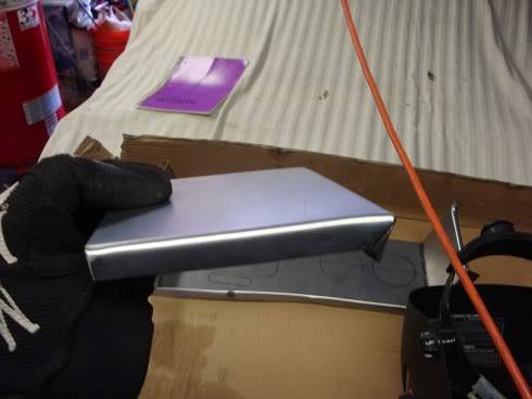

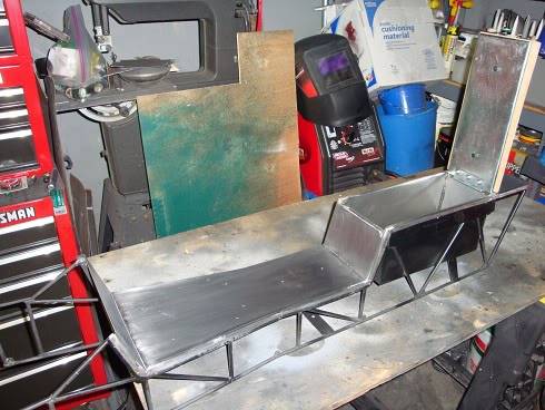

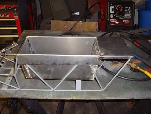

      Started the console box today. Hopefully more tomorrow.
      Homemade sheetmetal brake.

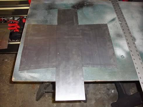

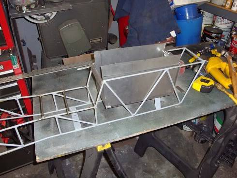

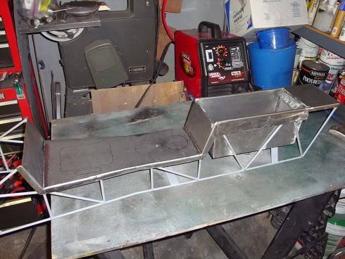

      More progress on the center console today.
      Got the top and the box almost done.
      I just have to trim some extra metal off and weld in a few small finish pieces.
      Then I can start on the side panels.
      Hopefully this weekend.

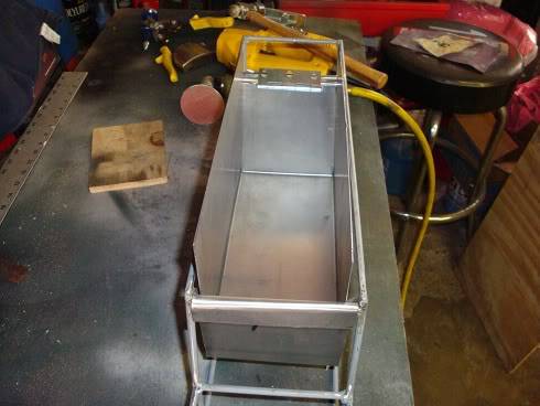

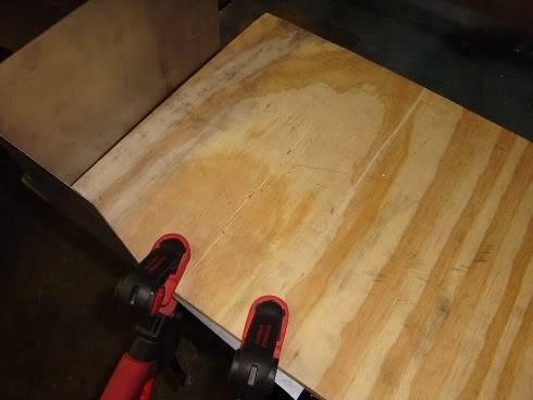

      Got the lid pretty much finished up.
      Made a wood top so I can put padding and then material and staple it to the wood.
      Welded in the nuts to attach the side panels.

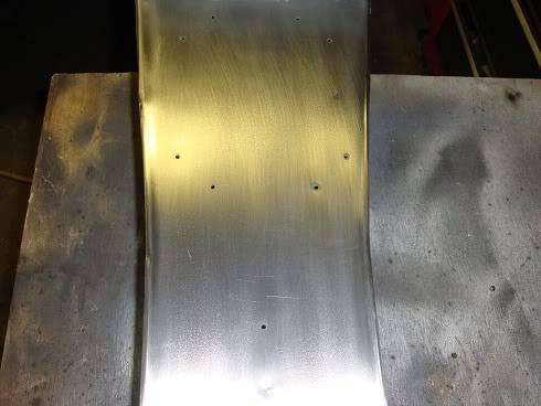

      And started to sand the metal that will be natural.
      Started with 220 and will end up with about 400 or 600 so you can still see the grain.
      Will use a sanding block to get the grain straight for the final finish.
      Got the stainless steel hardware to attach the side panels.
      Hopefully finished up this week. Hopefully.

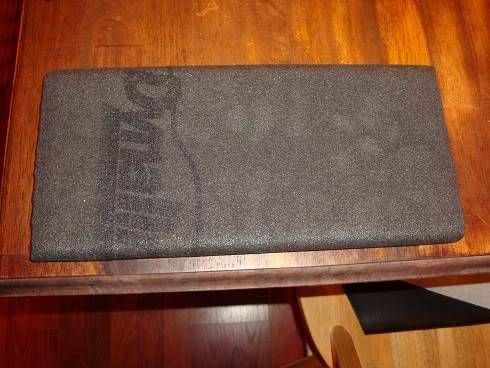

      Got the side panels cut out and fitted today.
      I have to go and buy the padding for the lid and sides tomorrow.
      Then I can start upholstering it.

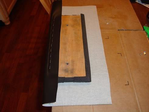

      Picked up the material for the side panels today.
      Ready to cover.

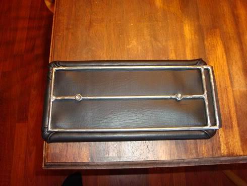

      I really was not happy with the way the lid came out.
      I covered it with metal and my skills are just not there to be able to really make the lid clean.
      So I decided to show the lid frame and attach it to the actual lid top with 2 s/s hex head bolts.
      Besides, it gave me a chance to do some more welding which I REALLY need the practice.
      The one on the left is the new one.

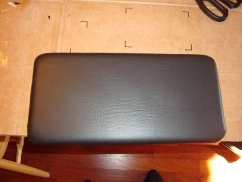

      Got to work on the lid today.
      Had some dynamat dynaliner leftover from covering the interior.
      Used it to cover the lid, density was perfect.
      Got it covered also. I have to weld in the nuts to the frame and then
      finish smoothing off the welds.
      Hopefully get that done tomorrow.
