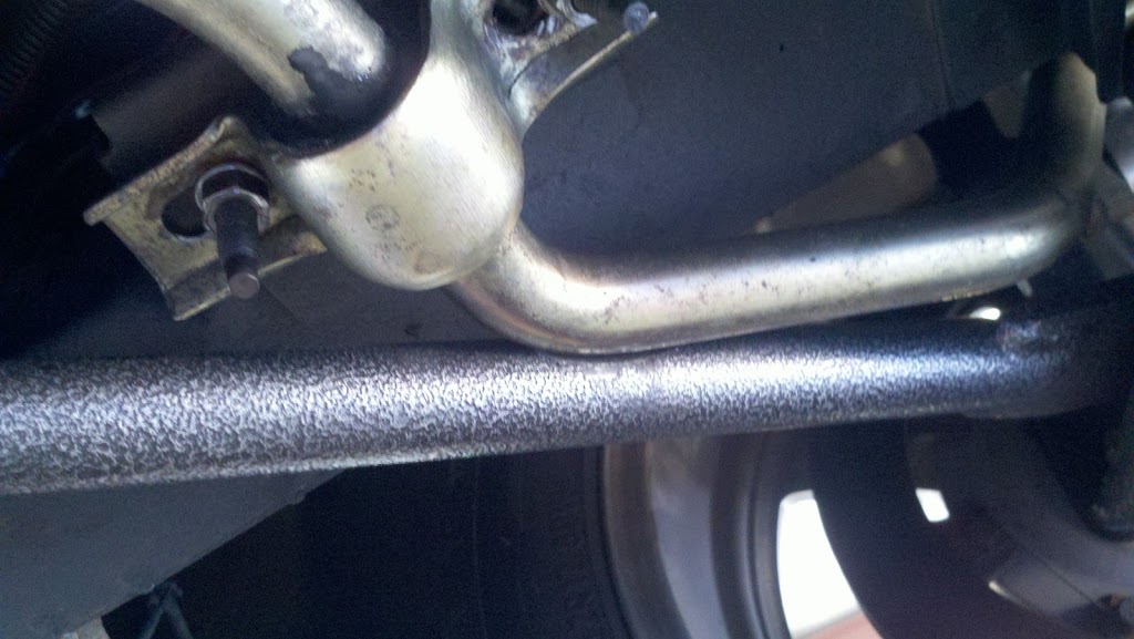

      I have the TCP kit on my Maverick. The only problem I have is related to the sway bar. In upgrading my sway bar to a larger than stock size, I've run into issues with the sway bar rubbing against the strut rods. I imagine this would be a problem with any larger than stock diameter strut rod though. It is also likely the result of my unusually low ride height as well.
