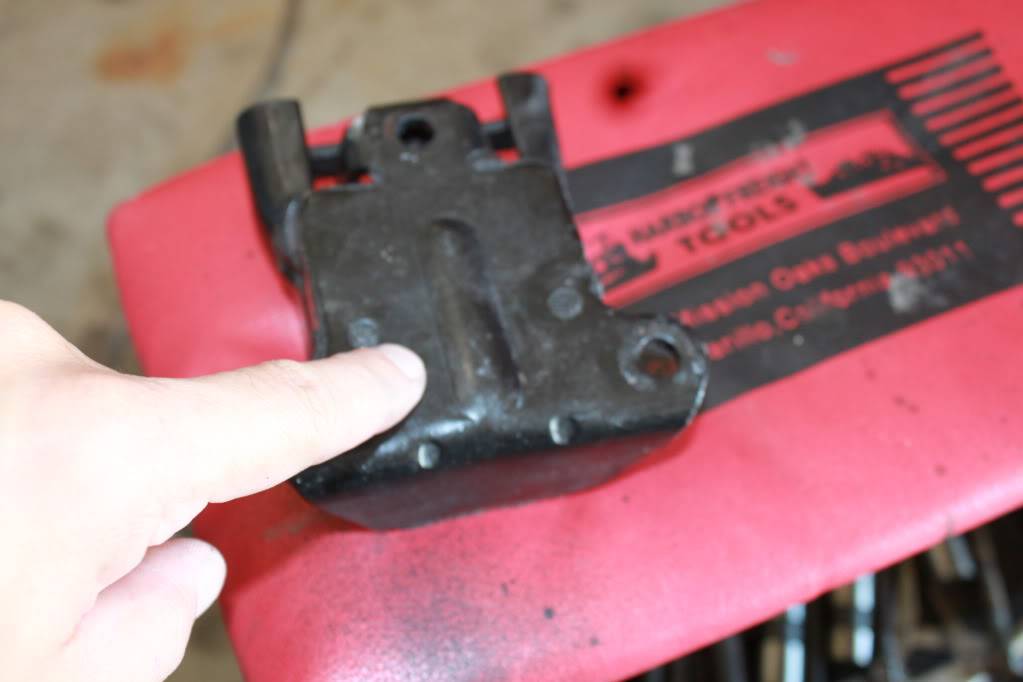

      First order of busines was to install S&P adapter plates and stock motor mounts. In order to use the stock mounts you need to slowly grind away the hump on the back of the mount so they sit fluch on the adapter plate.
