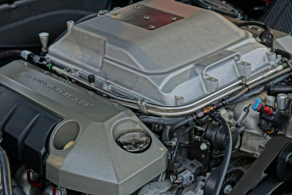

      Its been a few years since I posted to this thread and thought it was time to showcase the upgrades to the vehicle. These are items we were not able to get through when building the car. Chip was looking at my car one day (and yes the "Chip Foose" we have history together) and he said that my engine compartment looked like a parts bin and said we should made some covers to hide all the wiring. I cold have used the LSA engine covers from the Cadillac but I never liked the look. So I looked for ideas and went after the 2011 LS3 engine cover, bought one from ebay. I knew it would not work with the LSA but with a little modification I was able to transform them into what you see. I cut the part in half and was able to set them back further on the motor to align with the intercooler plenium. The drivers side only needed a small cut to trim off the forward edge, the passenger side needed some serious changes to work. I modified the existing plastic part with a new opening for the oil fill and the dipstick opening and then made a polyester mold to lay up a high temp epoxy part. Part was laid up and parts painted. Had to fab up custom brackets and was able to use the fastener locations as part of the design. One cool design feature was the ability to keep the CHEVROLET logo detail on the newley molded part! Name:  FB_IMG_1458612615033.jpg
