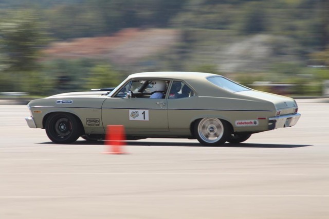

      At RTTH's Bret wanted me to take the 48 Hour Camaro front wheels off and put them on my Nova, and Let me tell you, they fit, Rubbed at full lock and thats all. I even have my car really low.
      After talking with Bret, the novas have a little bit more room then the camaro does.
      I did drop 2sec off my tire with the 275's over the 225's that i had. With the 275's up front and 275's out back, i was able to steer with the throttle.
      do you recall the back space on that rim?

      Those wheels on the front of the 48 hr Camaro are supposed to be 5 3/4" backspacing. That's why I was suprised at the amount of rubbing when I did my test with the 18x10 with 5 7/8". At a 3" drop, that 275 rubbed the bottom of the fender lip at around 70% turned, both left and right direction. I was prepared to do cutting on the inner fender, but not mods on the fender lip and risk damaging the new paint job. I really wanted 10's on the front, and I still think it may be possible with more backspacing. The car is on jack stands (I sold the old wheels) until I get new wheels, so I need to finalize the order for the new wheels very soon. It's looking like I will have to go with 9's to get a little more room.
      Gary
