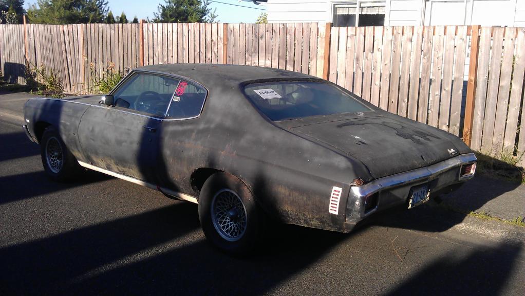

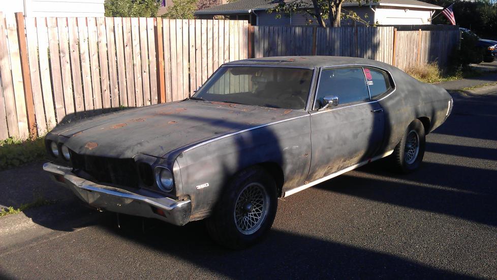

      Well I have the car now...unless I catch a deal soon on a more solid car. Picked this car up for $1,000. Original A/C car with power front disc, buckets, auto console and the owner swapped a 12 bolt in unknowingly (to fix his broke 10 bolt). Car is rough.... Will need both quarters, trunk filler panel, rear tail panel, all new front. I bought a title with parts!
      Short term plan:
      Fix rust and get body in black primer with new bumpers to look 'good'
      Swap in 6.0L with LS3 heads, intake, and healthy bump stick
      Long term:
      Drivetrain/suspension-
      Rebuild/stroke 6.0L (forged low comp)
      Positive atmospheric pressure via Kenne Bell 3.6?? (considering other options including TT)
      T56 or Tremac 6060
      Art Morrison GT-Sport chassis
      Kore3 C6 Z06 front brake kit for C6 hub
      Kore3 C6 Z06 rear brake kit w/ parking brake for 9"
      Appearance/Interior-
      Anvil carbon hood (painted with some revealed)
      Black or body colored bumpers
      Carbon diffuser
      Carbon front lip
      Shaved drip rails
      5th Gen Camaro seats? Front/Rear
      SS Dash wrapped w/ matching fabric
      Autometer gauges and built in touchscreen (linked to car pc and audio system)

      I don't know, bro... you might want to pass that project on to someone else... IF you can.
      Just sayin'

      Been there and doing it right now what your planning. I hate to tell you unless you got some money set aside and lots of time/skills I would strip car for certain parts to sell and move on. I bought SS Chevelle looked a little better then yours but once I got it home and apart then blasted I honestly paid way to much. I know if I would of bought a malibu I would probably be riding down road by now. But if you wanna learn alot,got a place for it and for it to be blown apart and good bit of cash then I say go for it! I did and still working on it ( but others things come up in life right now) I have learned alot and had some best of tmes with 2 friends working on it.Brandon

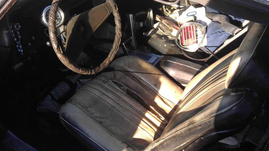

      the seats and console will bring decent $ to!

      Might want to consider a replacement shell
      Unless you are planning on doing all of your own body work (and know what you are doing), you might consider putting that title on a replacement Dynacorn body. Definately not a $6k car, but at least you won't have to deal with replacing rusty panels on the main shell.

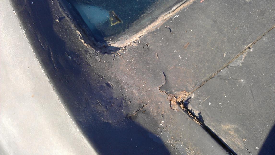

      Well I took the back window out and knocked out the bondo and see the the inner qtrs are junk as well. All parts are up for sale and will move on to another soon. Hoping to find something quickly!
