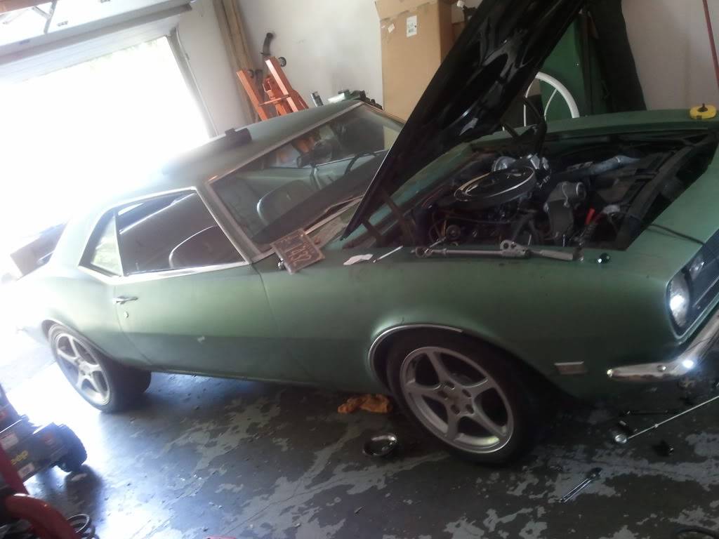

      ok put on my lowering springs and now my car is sitting on the lower bump stops. How does does this sound to other lpeople. my buddy says his car sits the same way. just curious. also my sway bar end link sleeves will need a decent amount of trimming to be level not sure if i like all this love the look of the car tho.

      ?? hard to see any better pictures? before and after?

      BEFORE
      [/IMG]
      AFTER

      Wow, that is a bit lower! What springs?

      3" drop with half coil cut off

      Maybe you went too far. Ride quality riding on the bumpstops will likely be a tad harsh....

      Yea think i got some things to figure out like what springs to buy next any one out there got a pic of a 67 68 camaro with c5 wheels and 2 inch or 3 inch drop springs.

      You're trying to drop height by only changing springs, correct? JMHO, but if you end up just buying springs, you're probably going to end up with a combo that you'll end up having to change springs again in order to truly correct geometry problems.

      All my lowering experience comes from lowering trucks, but my best experience with ride and handling after lowering has been using drop spindles in combination with drop springs.
